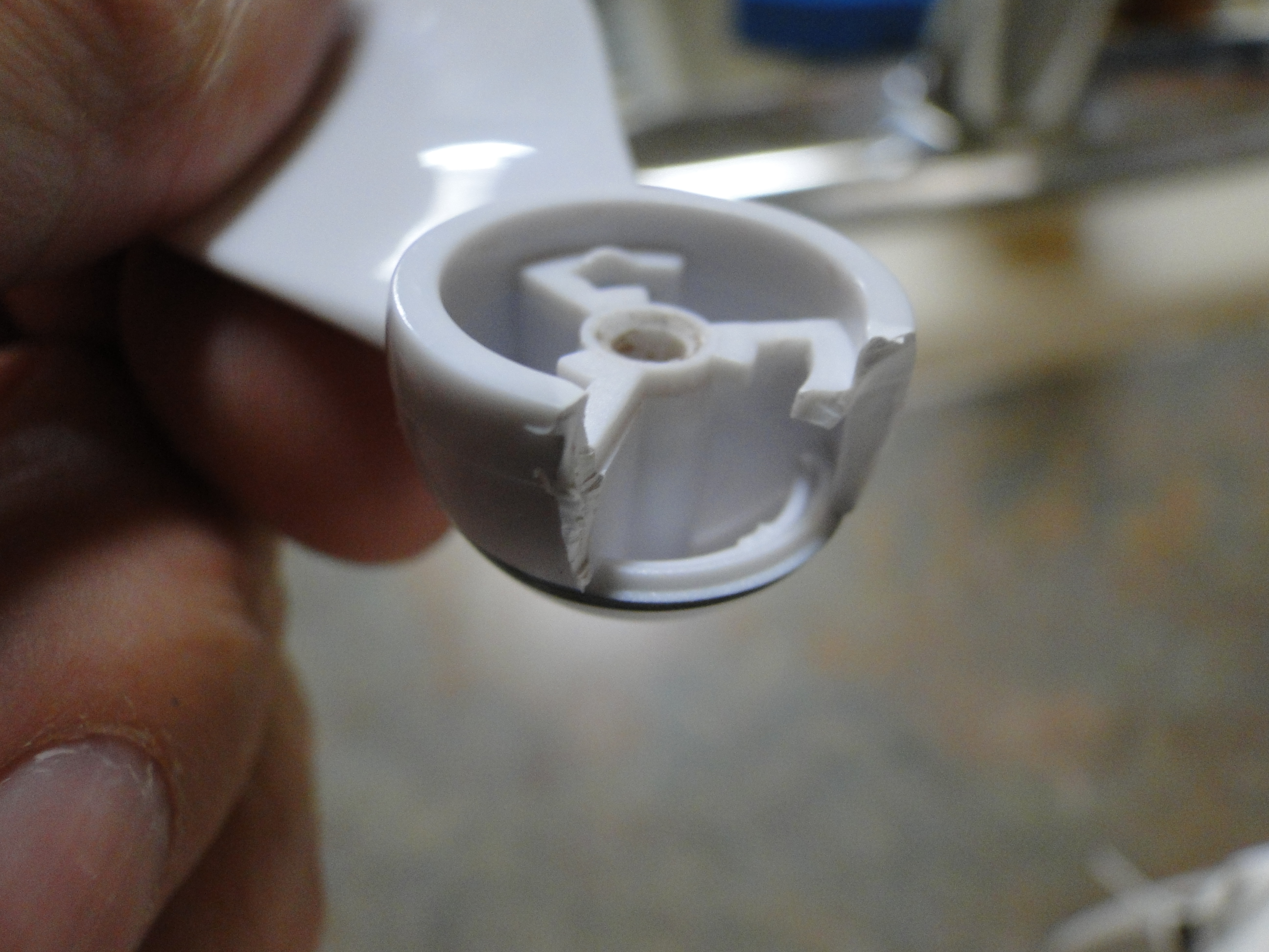

I would get a can of dye and spray for finding cracks in things, then check my blades routinely. I haven't seen this type of failure, nor have I seen it shown online before, seems rather odd.
I have been professionally performing dye inspections for 30 years and have been certified Level III in dye penetrant inspection. I have a hunch it would be difficult to detect cracking on these rotor hubs before failure due to the small size of the areas under stress and the dynamics of the large stresses they are under during flight. The crack inception-to-failure interval might be very short. But, if anyone has rotors they do not fly due to suspicion of possible cracking, especially the other 3 rotors Mr. Harleydude has from the set that failed, I could do some investigation into the development of an inspection procedure if that might be of help. An inspection before first flight, looking for suspected manufacturing QC/QA problems, could be indicated when subjecting rotors to flight demands such as Mr. 'dude encounters.
Once I get my bird replaced, I'll be happy to send you one of those rotors. I like the idea of a plastics/dye expert looking at these things. Part of me wondered if this was a dye issue.

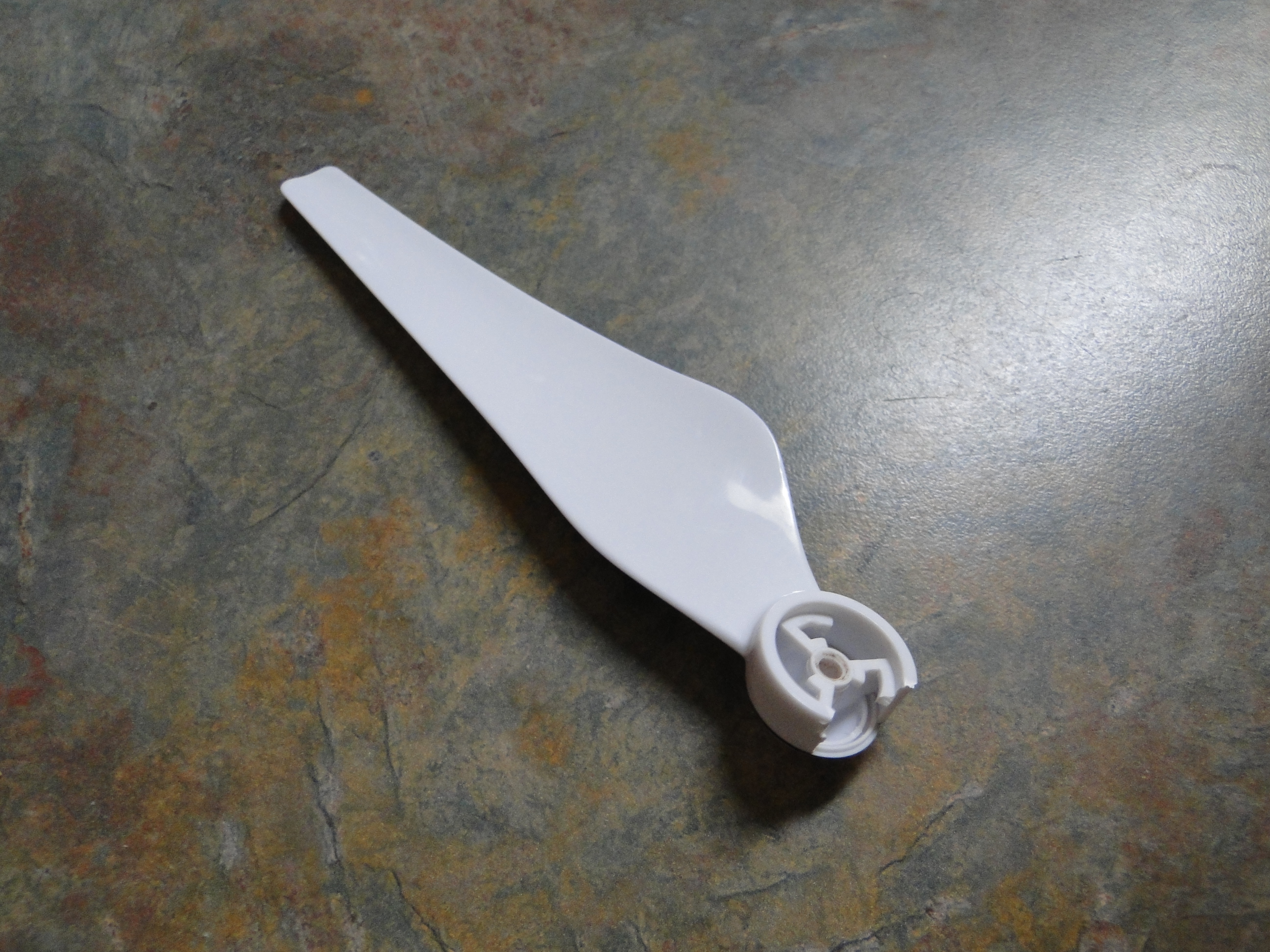

Deja vu for me....on a mapping mission this afternoon, I had a prop break mid flight. However, this time I have the prop. It seems this time, instead of the prop hub breaking, only one of the two rotors broke off the hub. So technically, I didn't lose a propeller. I only lost HALF a propeller.
Other than using my Phantom 4 an order of magnitude more than most guys, I'm doing nothing wrong.
So, once again I'm going to ask if any of you guys have seen prop failure. That's really the only information I can use at this point. Or if there are any plastics experts out there, perhaps they can look at the photos of the broken prop and share your thoughts.
Worth noting; the remaining 3 props remained essentially intact. One prop ejected upon impact. I know this to be true because the prop was a mere 8 feet from the drone (as opposed to 200' away had it ejected @ 300').

Another thing worth noting, is that I notice the P4P props have the slightest amount of wiggle room on the hub. I can kind of rotate the prop 1° on the hub. They do the same on the Obsidian hub.
The Obsidian props, however, have zero tolerance. They are very tight on the hub. I think I'm going to purchase Obsidian props from now on.

Looks like a classic stress fracture...high speed turn over stressed the prop blade...I've seen it before, broke where prop blade extends, not between prop blades....slow down before turning....
I was wondering about heat from motors since you fly so much at a time, but hearing another case and myself going 2 years on my P4 with no similar problems, and motors get warm but not hot, suspect maybe that rare(hope it’s rare)bad mold job, plastic not injected at optimum temp, press.? Don’t know a thing about it but a guess, and yes that’s a QC issue, dye won’t do any good if defect is below surface.
