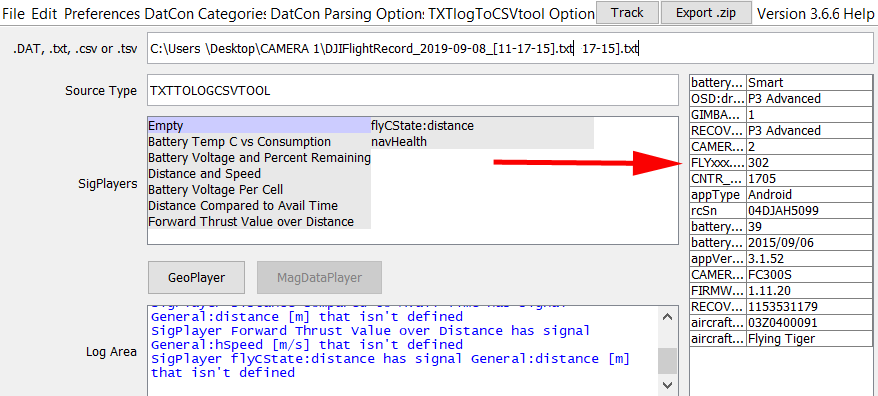

That is what I was trying to explain to you. Since the MAC version will not load the .txt records you won't know unless you
ask someone to locate it for you. On a PC you get this:

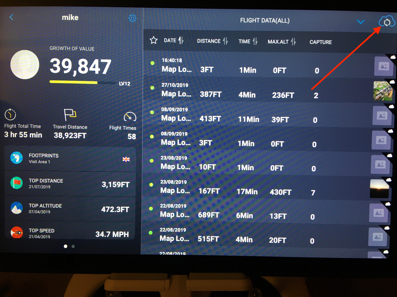

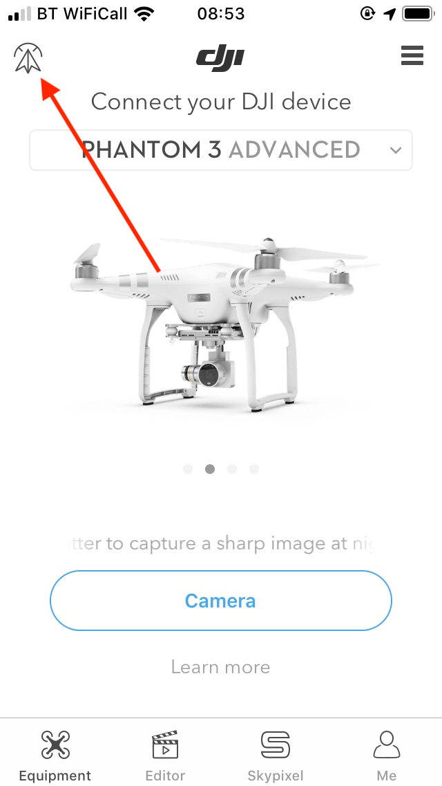

We got as far as - you press on the little "paper plane" top left corner of the home screen of the App......
then this screen will appear.........

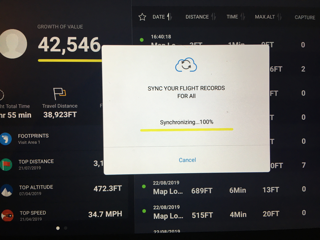

press the cloud top right and you should get a window with the option to delete files but I didn't, I just got a "synchronising files" window....
I'll get back to them today and finish this post........
If you press the gear icon to the far left, just above the growth of value, you can delete your flight logs only. It doesn’t delete the internal.dat files.
Reactions: Oso
Those are your flight logs that are on your mobile device, you can sync them to DJIs cloud, then if you change your mobile device or use more than one they can all be up to date.
