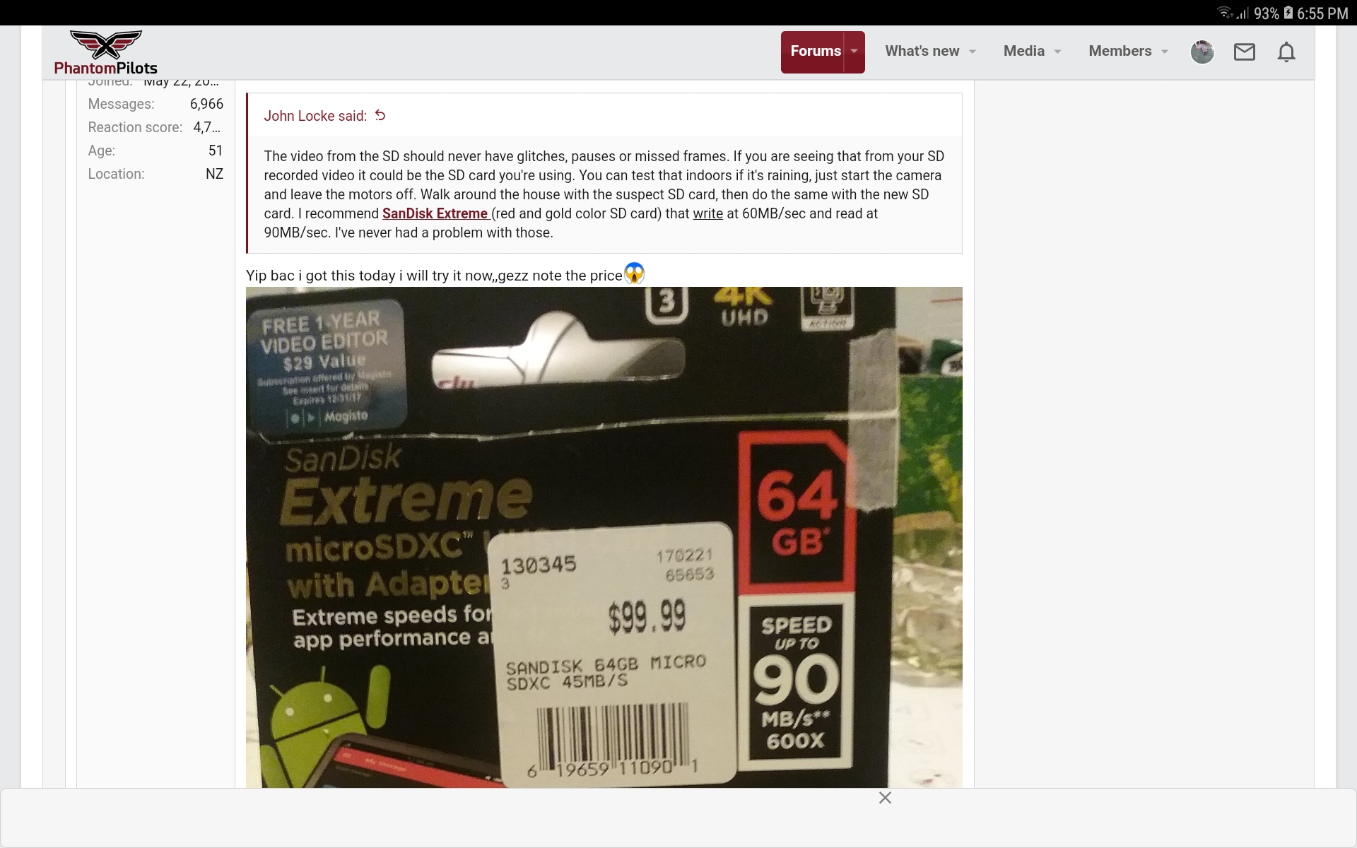

Ha I find this old post of mine and how much I paided for for sd card,,it still gives me a fright but still works to this day,,,this was 2017 I get this,,top $$$ or what
Reactions: Billie Nelson
Wow, that was quite a king's ransom that you shelled out back then, especially considering that the speed of currently available SD cards has tripled since those days. Good to hear that the cards are still in use despite the passage of time since they were new.
