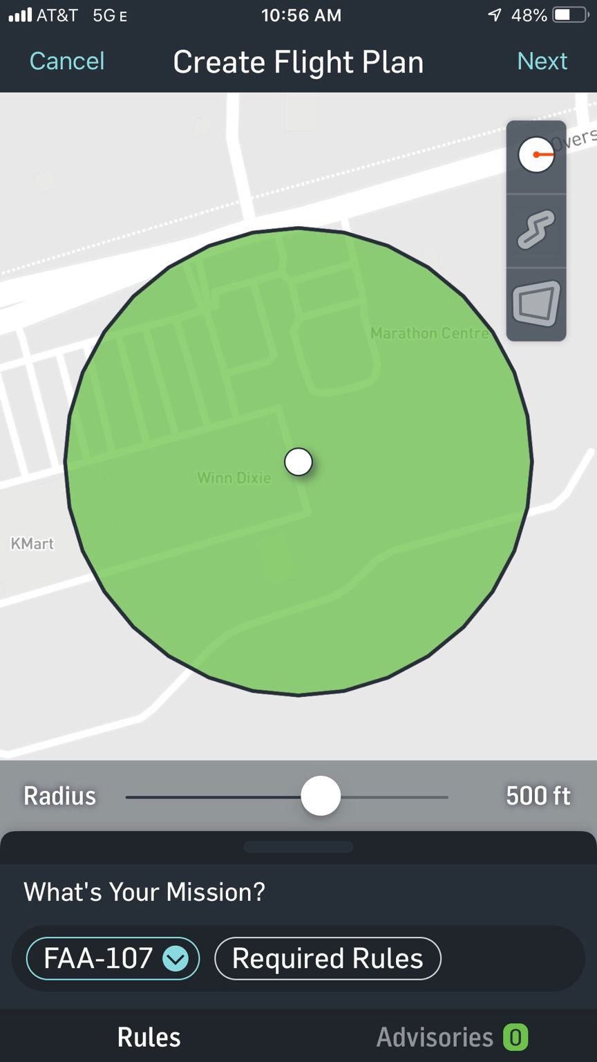

The other day I was in the Florida keys in Marathon key approximately 1.9 miles from center of KMTH ( Marathon International Airport) class E airspace View attachment 114769. I herd a low flying helicopter and decided to see if it was safe to fly using AirMap
. AirMap showed no advisories and a green for all go. I was well within class E surface airspace which requires authorization from ATC

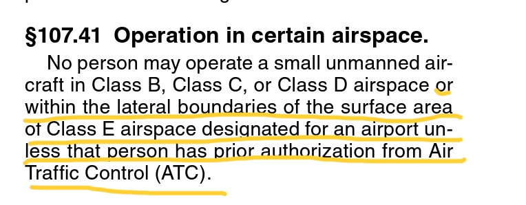

I was inside class E surface airspace which needs authorization from ATC to fly in such airspace. AirMap had zero advisories meaning I am good to fly there. If I did fly I would be in violation of 107.41 regulation.

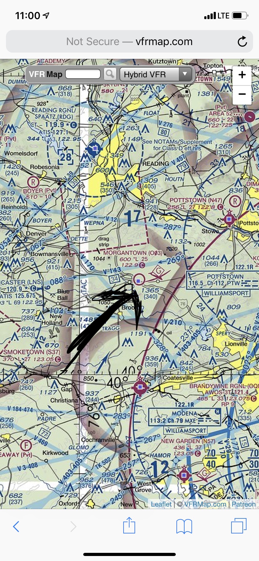

Look at this excerpt from sectional chart where I fly... Morgantown airport is in class G airspace. It’s outside the class E designation... Reading to the NW is class D controlled with class E approach to surface, with gliders to boot. I fly low and cautiously...
If in doubt, look at sectional chart..,

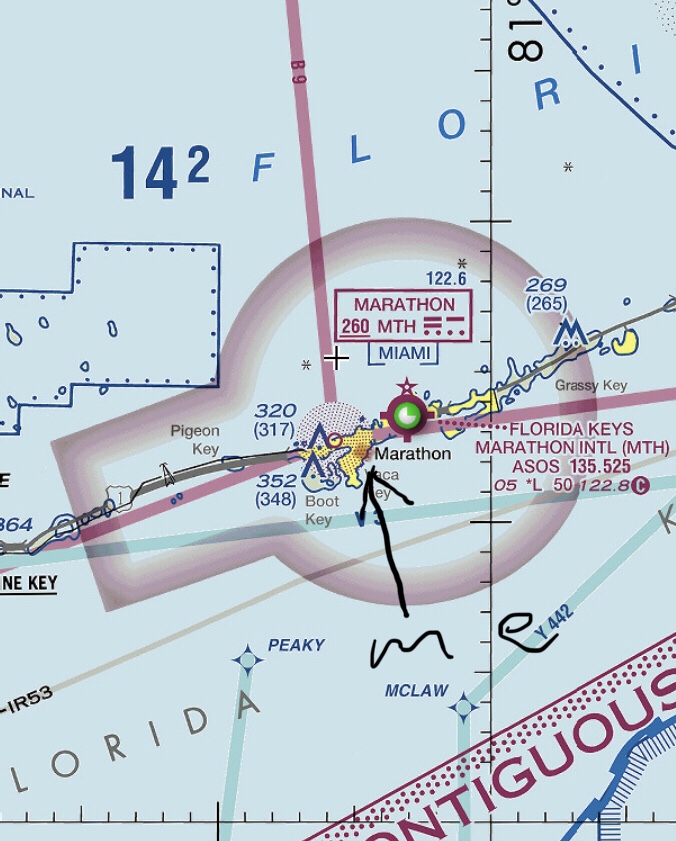

Here’s the sectional and where I was.
107.41 only references airspace where ATC authorization is required before flight, nothing about towered or non-towered airport. Where is it that tells me that I can legally fly within the airspace referenced above without ATC authorization as AirMap suggest?
There is a magenta ring around that airport so uncontrolled. You can’t get ATC/FAA approval since there isn’t a tower. Everything is visual only. I would call the airport and open dialogue about what you should do when you fly close by, and pay very close attention and maybe use a VO. I’d stay low for sure even though it’s class e from 700’ upward (not from surface).
Like you already saw, helicopters do what they want and you gotta keep clear...
And that dotted circle to the left of the arrow point means that is a non directional beacon
Class E surface is a dashed magenta line on the sectional charts. Marathon does not have that. A good example is Leesburg Airport in the Jacksonville sectional. It has a Class E surface with ceiling at 0 AGL SE over Lake Dora.

The sectional I posted above has dashed magenta line for the approach to reading airport. Reading is class D with class E to surface on approach...
The important part in all this is that as UAS pilots/operators it our responsibility to avoid manned aircraft, even if they are not flying in a safe/legal manner.
Got it! Don’t know how I missed it, thanks everyone.
