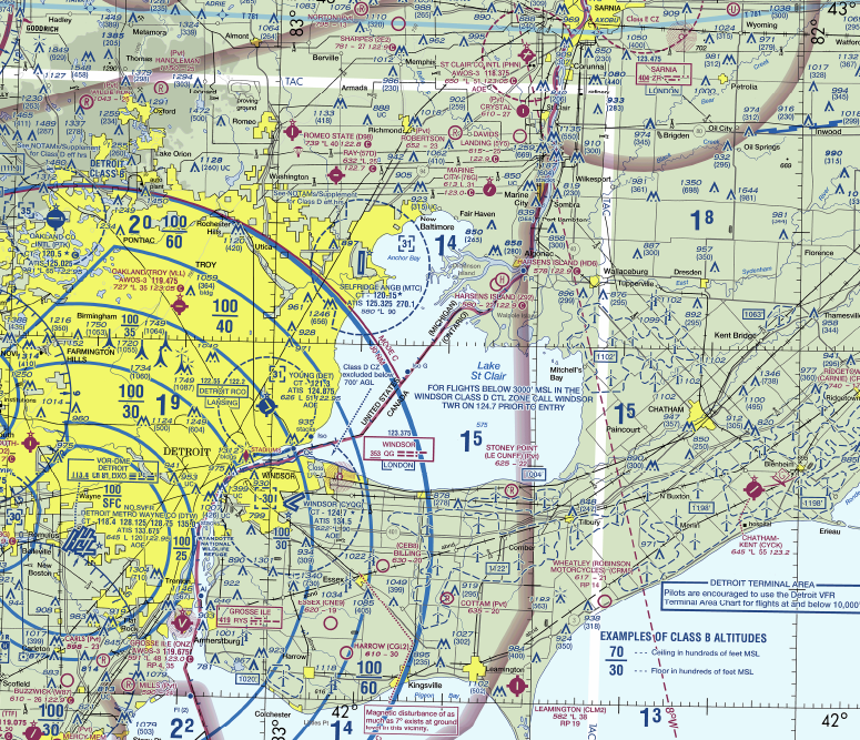

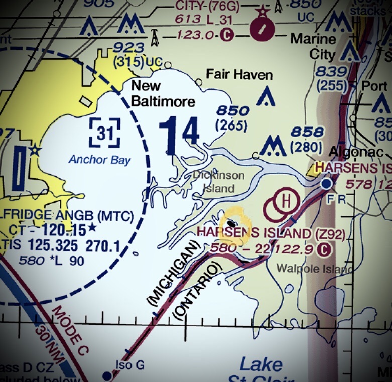

This is a portion of the official FAA Sectional Chart for this area - you'll notice a black mark just to the upper left of the E in "harsEns island" - that's the area of the flight in question:
You tell me - is that in Class D (or any other) airspace? Is it in airpace where prior ATC authorization would be required?

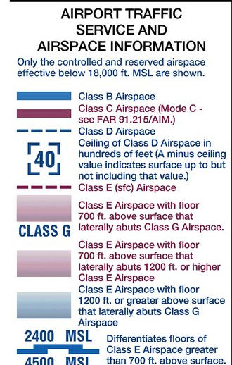

I've never come across the term "MODE C" before, but according to the sectional charts legend it is the same as Class C Airspace, and it looks like your friend was in it. I never rely on an app (or the Chinese) to tell me where I can or can't fly. Best to understand how to read a sectional chart and refer to it before any flight.
Where do you see this area on the map? Why isn’t it processed by any app?
Mode C just means that any manned aircraft flying into that airspace is required to be operating a Mode-C Transponder.

If your buddy was in the area highlighted he was definitely not in class D airspace. This is class G up to 699’ with overlying class E at 700’.
He also was no where close to Mode C Veil which is perfectly legal to fly in as long as you are not in class B,C,D or class E surface airspace.

I couldn’t agree more. I DO know how to read a sectional chart, at least I believe I do. I asked two pilots out of the local Airbase (Selfridge) and they flat out stated that this was not Class D and certainly not C. I’m asking here just to get other opinions. The FAA is staffed with humans who can make mistakes.
Reactions: Tim Crago
That is exactly what I read it as. Class G up to 699’
I believe this will be easy to prove to the FAA and dismiss this part. The other violation... yea, he’s bummin’
I stand corrected. The legend is confusing. Looking at the larger area shows that "MODE C" applies to the inner side of that ring anyway, not the outer side where the text lies. Jeez.. They couldn't use a different color for that MODE C line and text -- like maybe green?

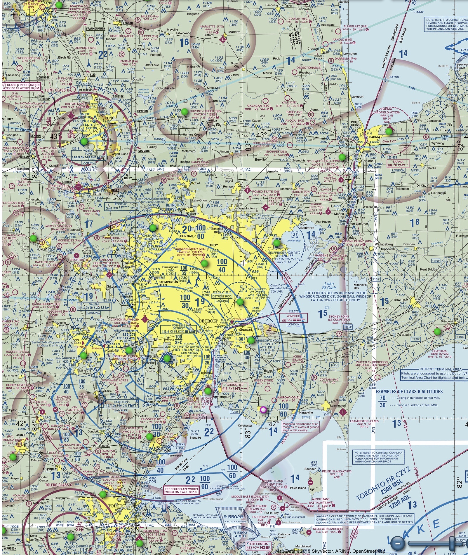

While I agree with @MapMaker53 about always referring to the actual sectional charts, I'm not sure how that reconciles with the letter from the FAA. Zooming out from the small section that @Drestin Black showed, you can see that large Mode C area. However if the FAA letter says he flew into Class D airspace then I just don't see that at all. The flight was well outside the Mount Clemens Class D airspace. The flight logs should show that clearly. Also due to the very distinct land mass features, even the flight video will show that he was nowhere near the Class D airspace.

I fail to see how this flight was in “mode C/class C space” . Llooking at the lat/long, this flight was more than 30 mile from the Detroit airspace. The magenta c means there is ctaf frequency for the airport.

I was not trying to conceal/confuse anything by being zoomed in on my original crop from the full Detroit Sectional Chart, let me include a larger version. Perhaps it's my old or uneducated eyes but can you please show me where you see this Mode C Area that intersects with the area of the flight (Just to the North West of the letter "E" in "Harsens Island")

The Mode C veil is irrelevant to this conversation because it does not restrict a drone from flying there. It just means that all manned aircraft entering that area must be using a Mode C transponder.
