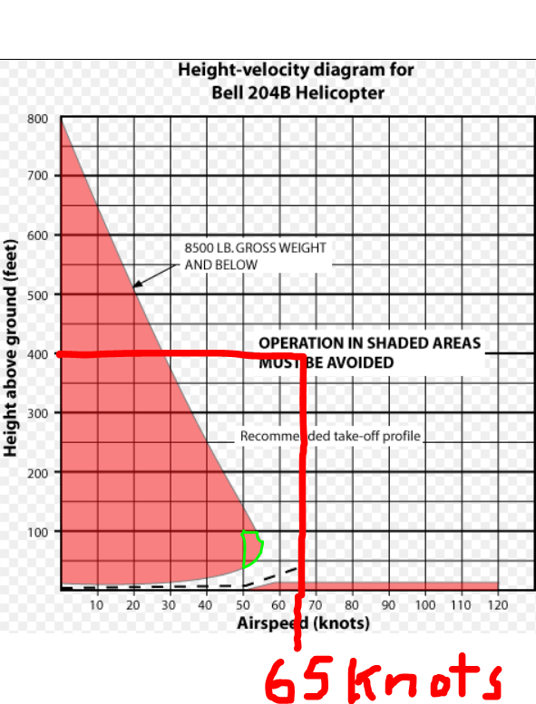

My proposal for Class H:
* All aviation must adhere to strict air speed limits of < 65 knots 150' AGL to 400' AGL.
* All aviation must adhere to strict air speed limits of < 50 knots from ground to 150' AGL.
* No flying below 100' AGL unless you are on landing approach or there is an emergency that requires it.
This allows helicopters to remain well within safety margins of the Helicopter Height Velocity Diagram for auto rotation:
* Class B, C and D airspace takes precedence over Class H, which makes sense because UAV's should NOT be in the flight path or glide slope of any runway, and should not be flying within 4 miles of Class B, C or D anyway.
