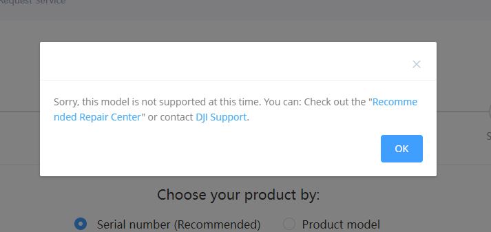

My advice is, send everything except batteries, drone, RC, spare parts, to the DJI repair shop. You can ship it there for free, and they will give you a free estimate to repair it with pictures. The estimate price, in my experience is very fair, pay it. Then, what they actually do is send you a new aircraft and a new RC. I just received a new P4PV2 and RC for $145 worth of repairs, in one week. The DJI repair shop has GREAT Service!
Not a lot of luck with that yet.
