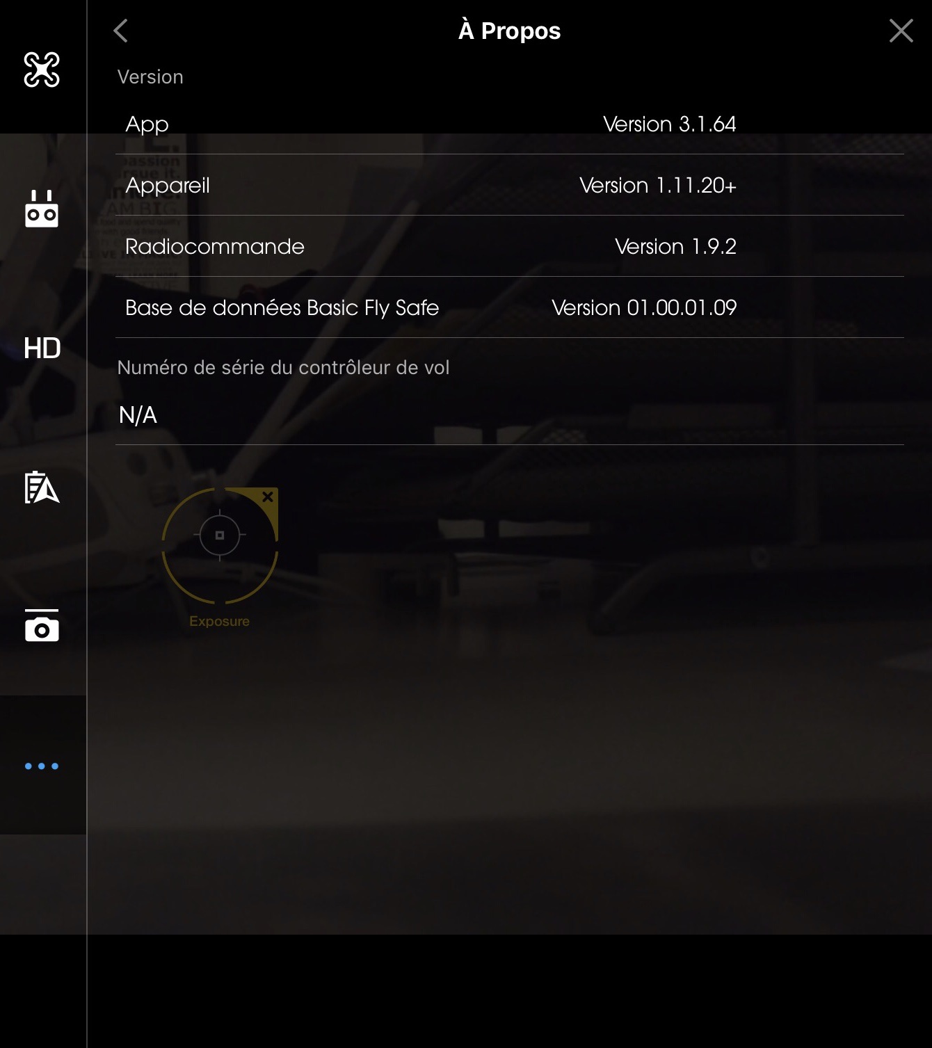

Look to see what firmware version the remote controller has and also the firmware version the A/C has. Then let us know what they are. You may have a firmware incompatible issue.
Reactions: jiminyfixit

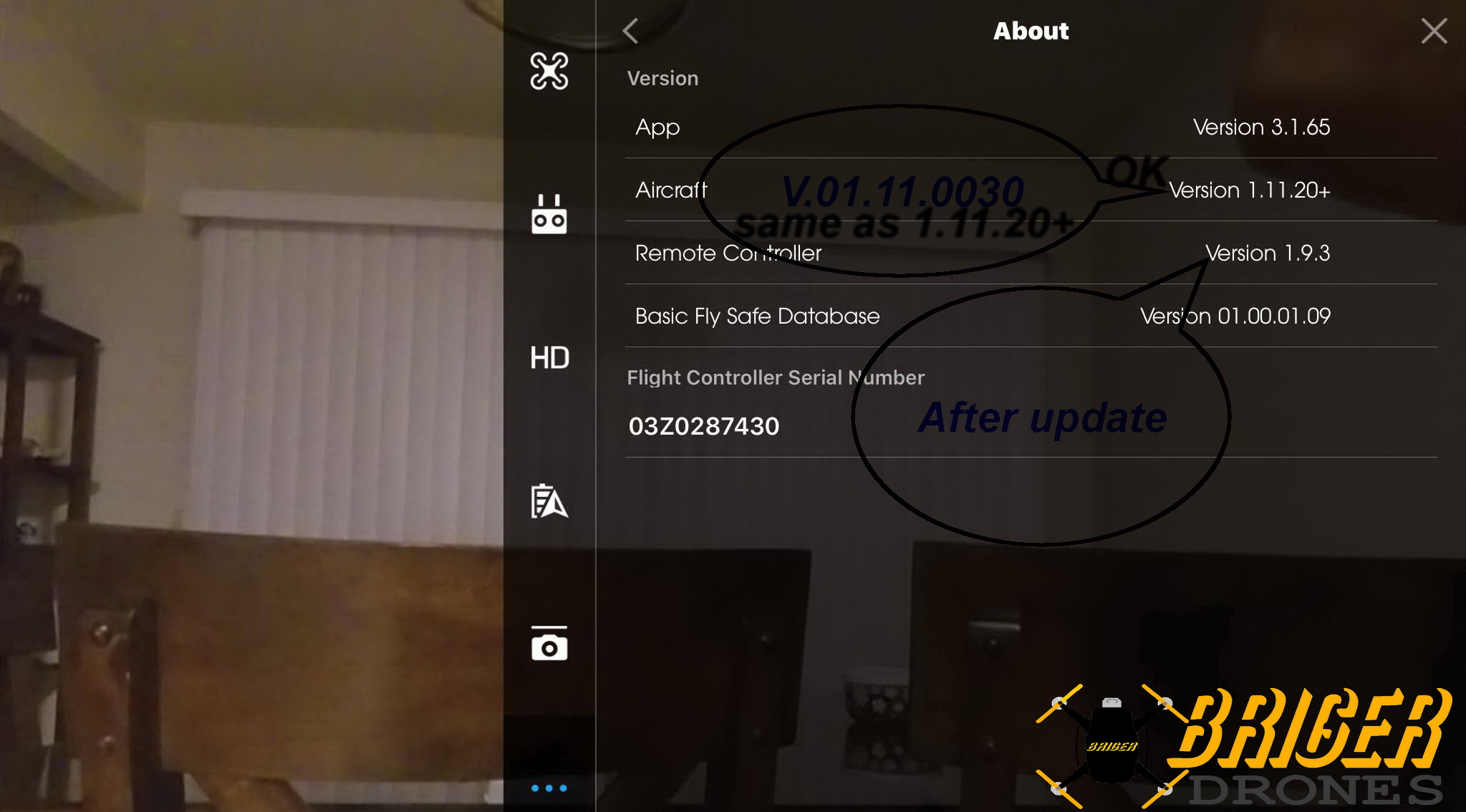

Here’s my firmwares info
Strange, there is NO mention of a firmware version 1.9.2 in the P3P release notes.
Anyways, it looks like you have to update the RC-firmware as well to v1.11.20.
In your picture there's a "+"-sign after the AC version number, this means there is something wrong with it.

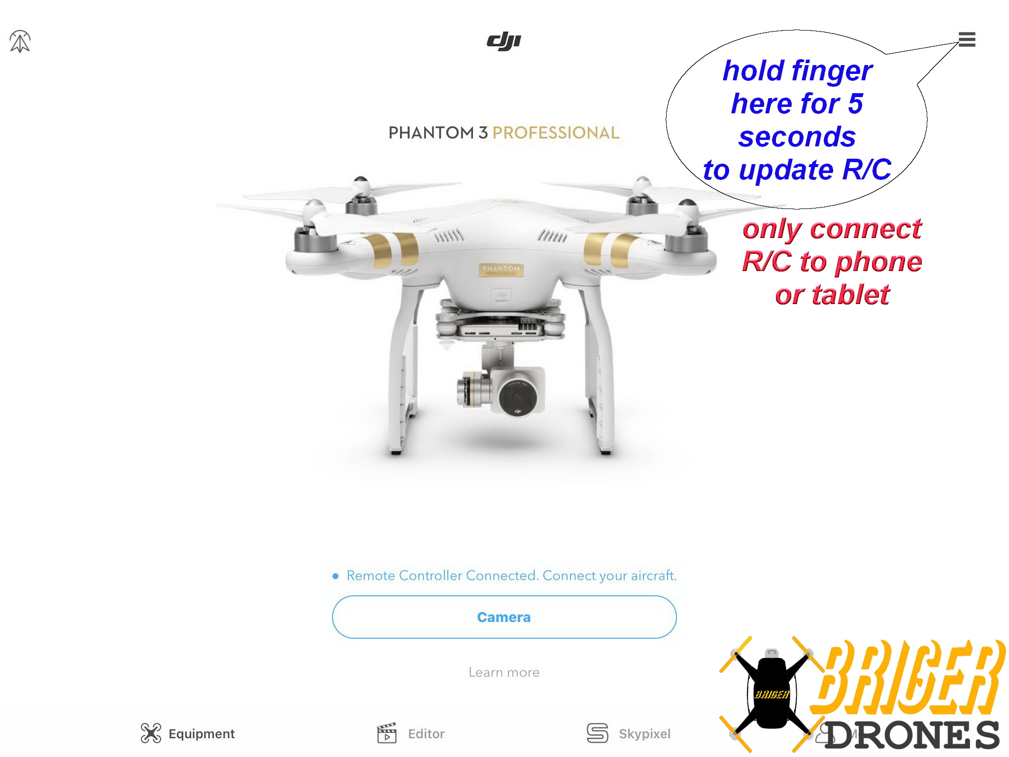

Go to the DJI P3P download site and download the PDF-file "How to Update the Firmware v1.4"
or
On page 4 it states you have to use the DJI GO app to update the firmware if the RC-firmware is v1.3.20 or above.
Also the DJI Go app version has to be v3.1.13(iOS) / v3.1.8(Android) or above.
According to the info on your picture and the Firmware Update Guide you have to instal the latest DJI GO app on your device and use the GO app to update the firmware of your drone AND remote controller.
All you need to do is reinstall or update controller's firmware and wheel will work.
There is no such thing as v1.11.20 for the RC.
v1.9.2 is fine for the RC. It is even noted as such in the release notes you posted.
Do you have a P3P or A? I’m curious which version you have on your own RC. Could it be v1.9.x perhaps? ;)

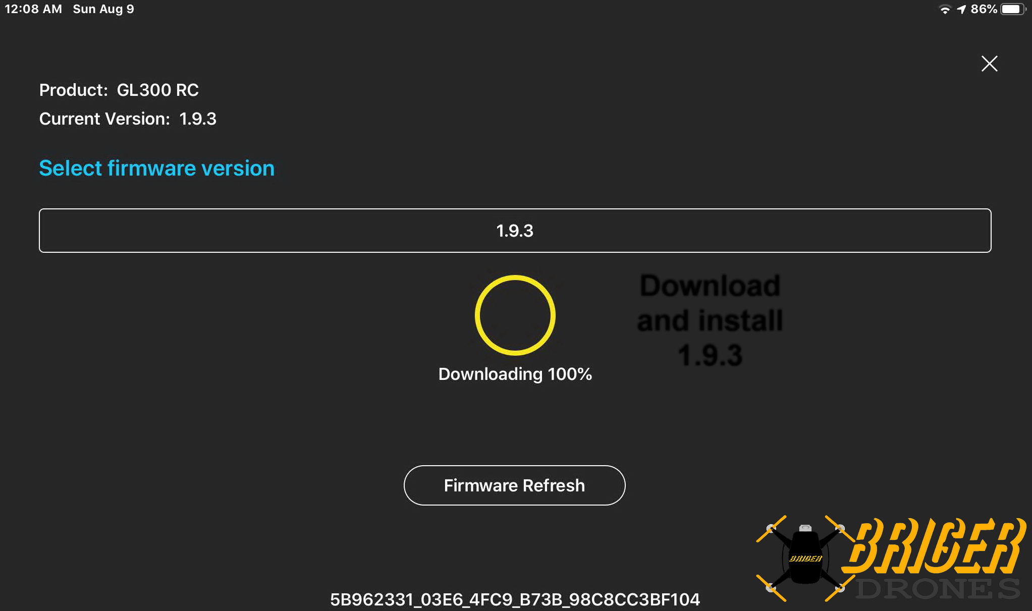

I've red on a DJI forum that the + sign after the AC version number will disappear after re-installing the DJI GO app:

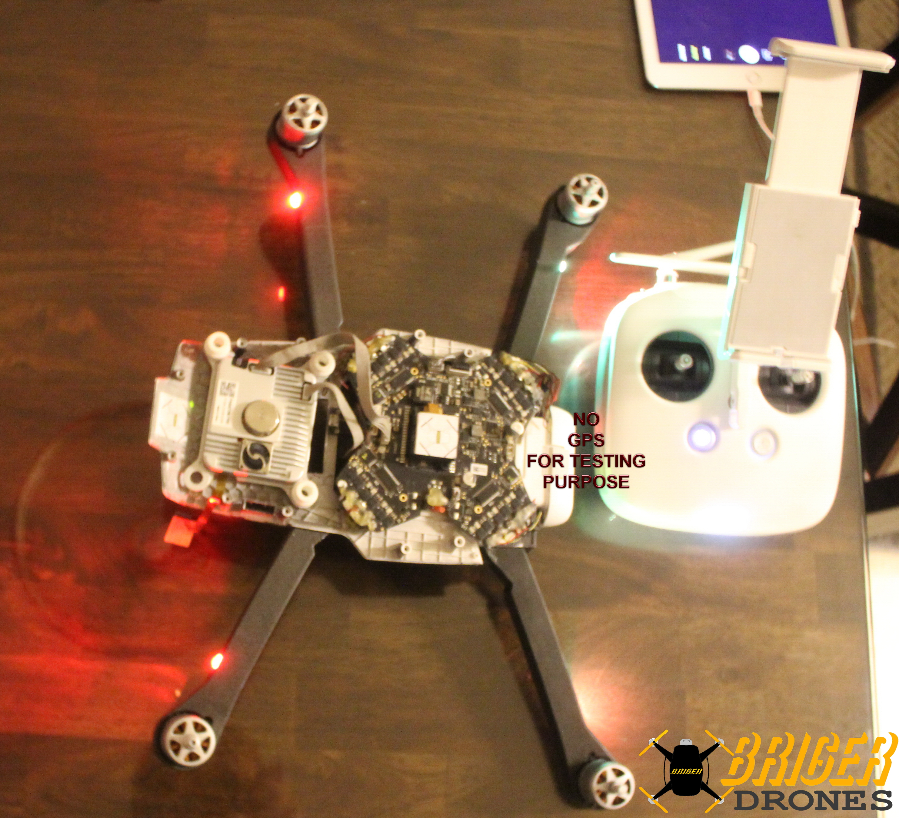

Forgot to mention, that is what I did with the Phantom 3 Professional but on my Phantom 3 4K mod which had the same issue did this: Gimbal, RC repair. Hope any of this work. Do you have a friend you can try testing on their drone and r/c?
All this worked for me doing a process of elimination.
Good luck and hope someone comes with a solution, will keep an eye on thread.
