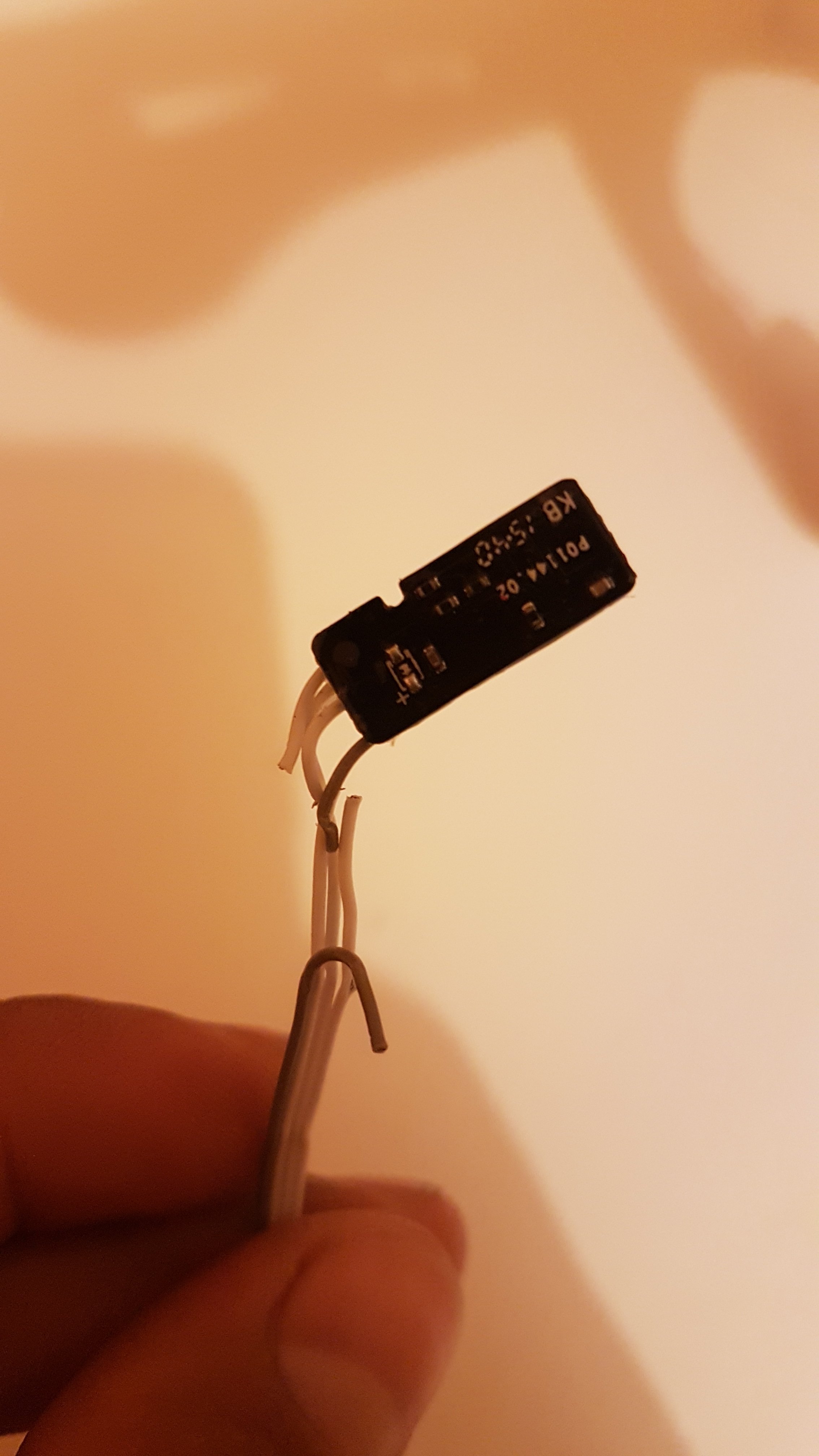

Hi everyone!
I have a serious problem. I change the shell of phantom 3 pro and when was i put the cable of compass on undercarriage i cut the cable.
i can change this piece (part 11), but i have other problem. When i turn on the phantom, on the camera sounds a continuis "beep" and i can move the camara since up to donw, but NOT side to side.
Obviusly, turn on the phantom without the compass and the question is:
Are these problems related or not?

Hi Mate
Why dont you just solder the cables back together...?
Waylander
Reactions: Technical Bob
Easy mistake,yip camera only goes up and down,no sideways movement unless hooked up to dji goggles (gimble tracking),yes try some solder,
Depends what you mean by 'side to side'. One doesn't have side to side control, but it does have 3 axis movement and it tests this on power up.
I don't believe the compass is needed for its gimbal test but it won't fly. You may have broken the thin flexible ribbon cable or one of the gray ribbon cables to the gimbal. Be sure the connectors are properly seated.
Hey everbody!
i fixed the compass, but i had the "wonderful" idea the to update the firmware to version v1.11.20 and i had problems.
