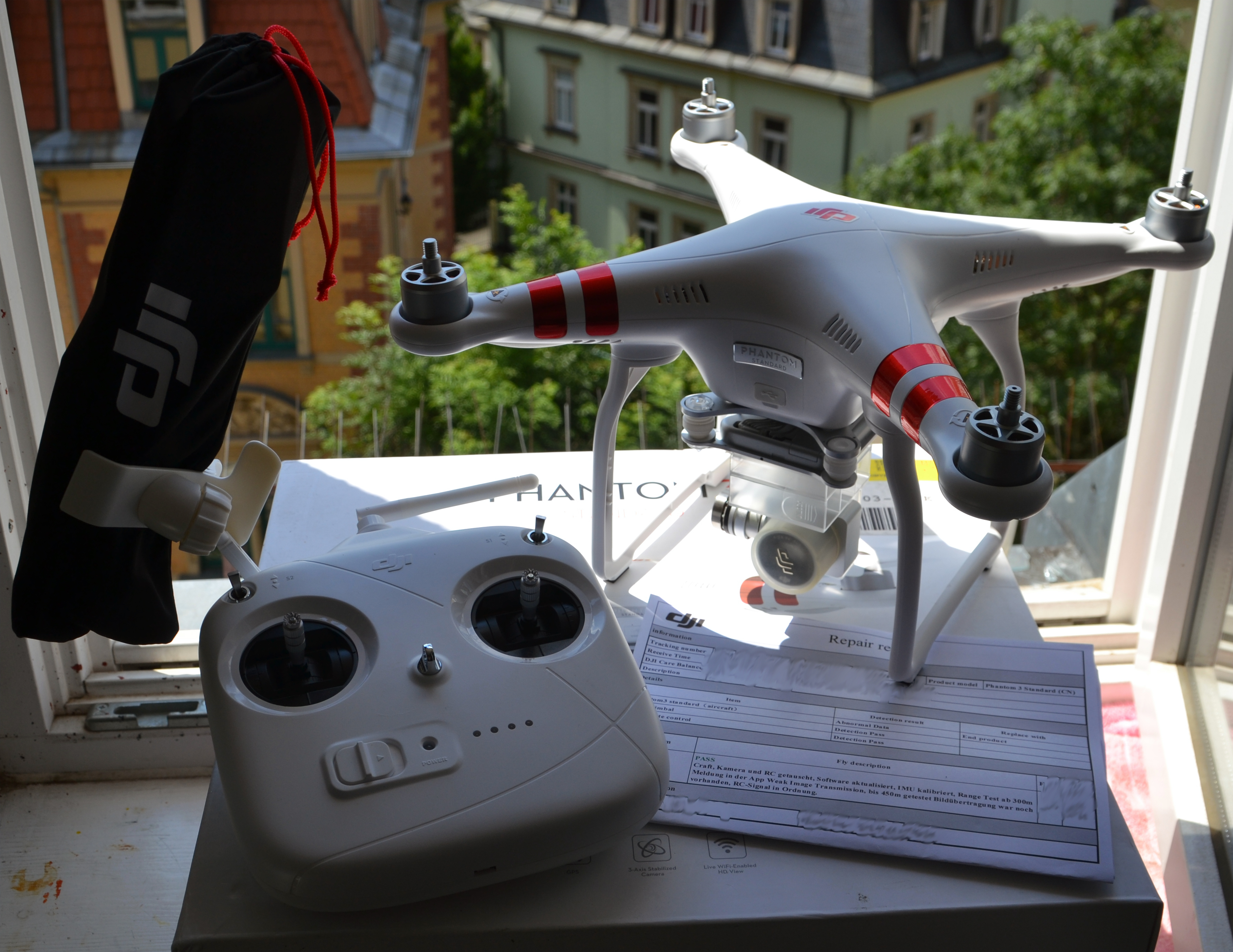

Had sent my bricked copter and remote to DJI Germany and after 4 Weeks they sent me an all new setup back!!
I tried to change the bios of my 8 month old Phantom 3 Standard (ca.400 flights) from EU to US, to fix this range problem and you know the rest of the story.. NO WIFI and **** ^^
Now I got a brand new Copter (US), Remote (US), Propeller Set in a bag, Charger (US), Tool Set etc. FREE OF CHARGE!!!!
I can´t believe that but thats the truth. :D
I can´t believe that but thats the truth. :DView attachment 59741
Welcome to the forum! I'm glad someone's had a good experience with DJI's support department - they were next to useless when I wanted support.
