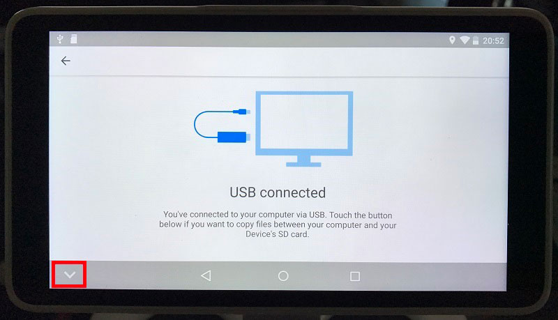

2) Swipe down from the top of the screen and tap the "USB connected" message.

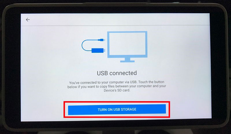

3) Tap the down arrow on the bottom, left of the screen to reveal the "TURN ON USB STORAGE" button.

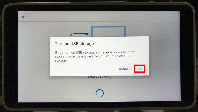

4) Tap the "TURN ON USB STORAGE" button.
5) Tap "OK" to confirm you want to enable USB storage.

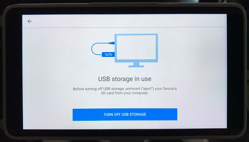

6) The following screen should appear when USB storage mode has been enabled:
7) Copy/move the files to your computer like you do when connecting other external devices.
