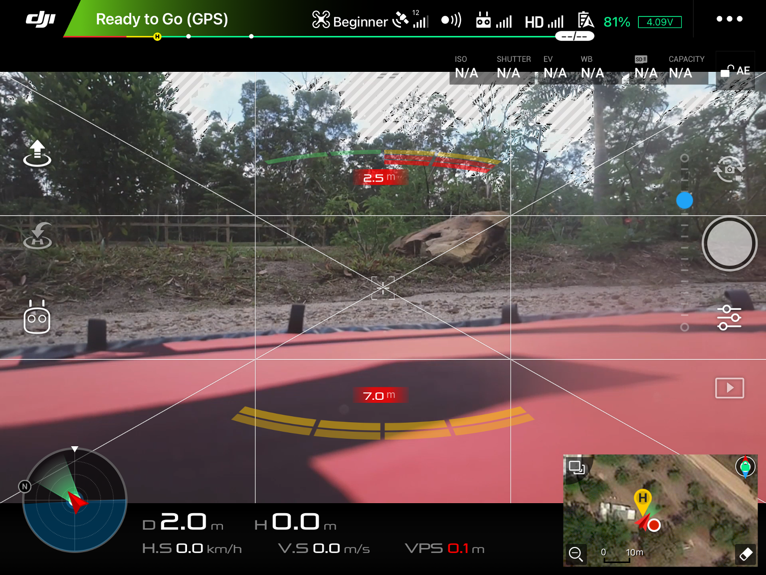

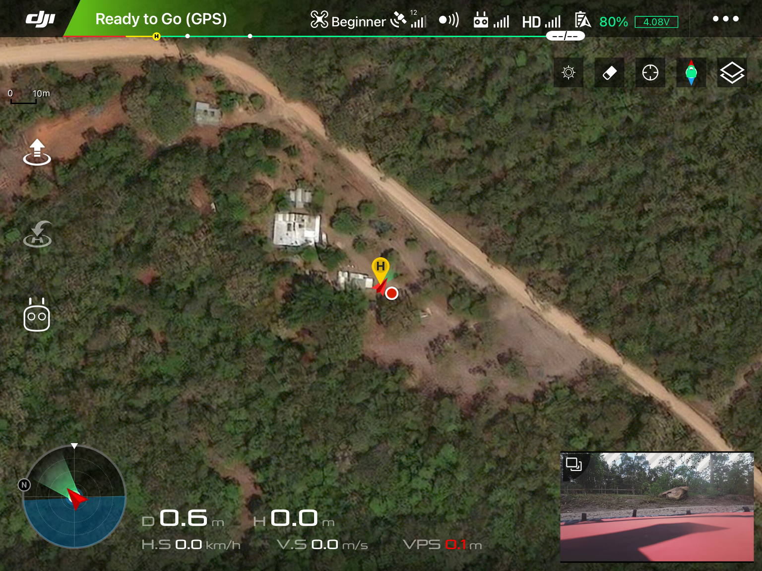

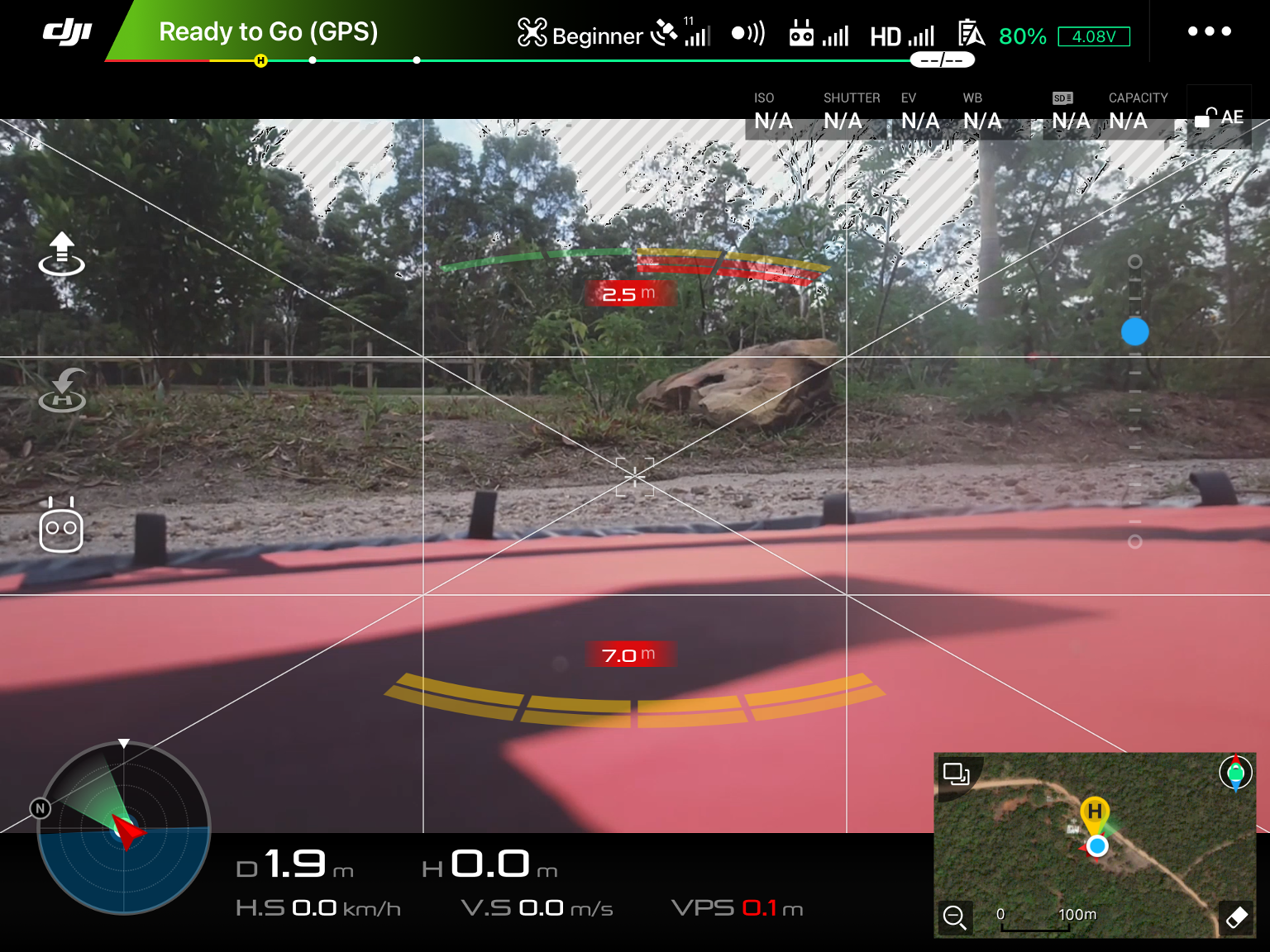

Hi,
First, I would like to introduce myself as an Australian Chief pilot and drone operator that use DJI drones
for professional use.
I have an URGENT and important question and need of your assistance.
Time ago I flew my drone Phantom 4 Plus V2 in a mountain area at about 700m above sea level.
It is at Mount Fox, 4850 Queensland, Australia.
I remember that day before I download on my DJI controller the last update from DJI.
Once I gave the command to the Phantom 4 Plus V2 to take off, it starts to fly first slowly up and then without any command speeding up in the sky vertical very high.
I realised that I lost the control, the motor signed max speed, I could not control the camera and it did not respond to my command to Return Home…
I had manually to command to go down and landing and finally it descended with speed even I tried to slow down and to stop it.
It finally landed hard with speed and the front UV Lens Glass Frame Gimbal Camera has been broken and need repair.
I cannot understand this abnormal behaviour even seem all has been well set up and the screen indicated ready to go.
This even I tried to fly in the beginner mode with the limitation of Altitude 30m and radius 30m of distance, however drone had the same behaviour.
Recently I I download again on my DJI controller the last update from DJI; however I am still hesitant to fly again until I may discover the reason of this drone behaviour.
Thank you very much for your concern and support.

or, if I do remember, this last one when P4P crashed:
DJI Flight Log Viewer - PhantomHelp.com
There was a problem in this flight:
You can see that as the drone climbs (IMU height increases), the VPS sensor is giving a false indication of height and shows 1 ft or less.
Something was causing the VPS sensors to give false height data.
It could have been something blocking their downward view or a malfunction of the sensors.

Perhaps this is the cause of the problem...
This:
Gimbal Guard Camera Lens Protection Plate for DJI Phantom 4 Pro Drone Carbon Fiber Landing Gear Protector​
that I inserted to protect the landing legs of the drone...
Perhaps it has obstructed the VPS sensor?
Most probably yes.
I am sorry that I did not realise it before and I took too much of your time.
However they are working very well on landing hard but or I will find an other position more near the camera (without obstruct the lenses) or take it out.
I will now attempt to fly again : )
Thank you
Definitely yes.
You could also disable the VPS sensors in the app settings.
I never found the downward sensors particularly useful.
