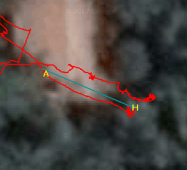

I do not see those things in your flight log.
Have a look at 0:38.
I can't see anything to explain it but there's one homepoint recorded at the start of the flight record and another at 0:38
1st home point 5.98899864 80.62282547
0:38 homepoint 5.98905091 80.62270236

I think this is "normal" behavior that happened because launch occurred before enough satellites were acquired. The AC will record a home point as soon as there is some GPS info and then record another when gpsHealth > 3. Usually this all takes place before launch. At 37.076 secs gpsHealth was still 3 and the home point was at it's initial position. A moment later gpsHealth became 4 and the home point re-recorded to the AC's current location.
View attachment 90950=>View attachment 90954=>View attachment 90953
