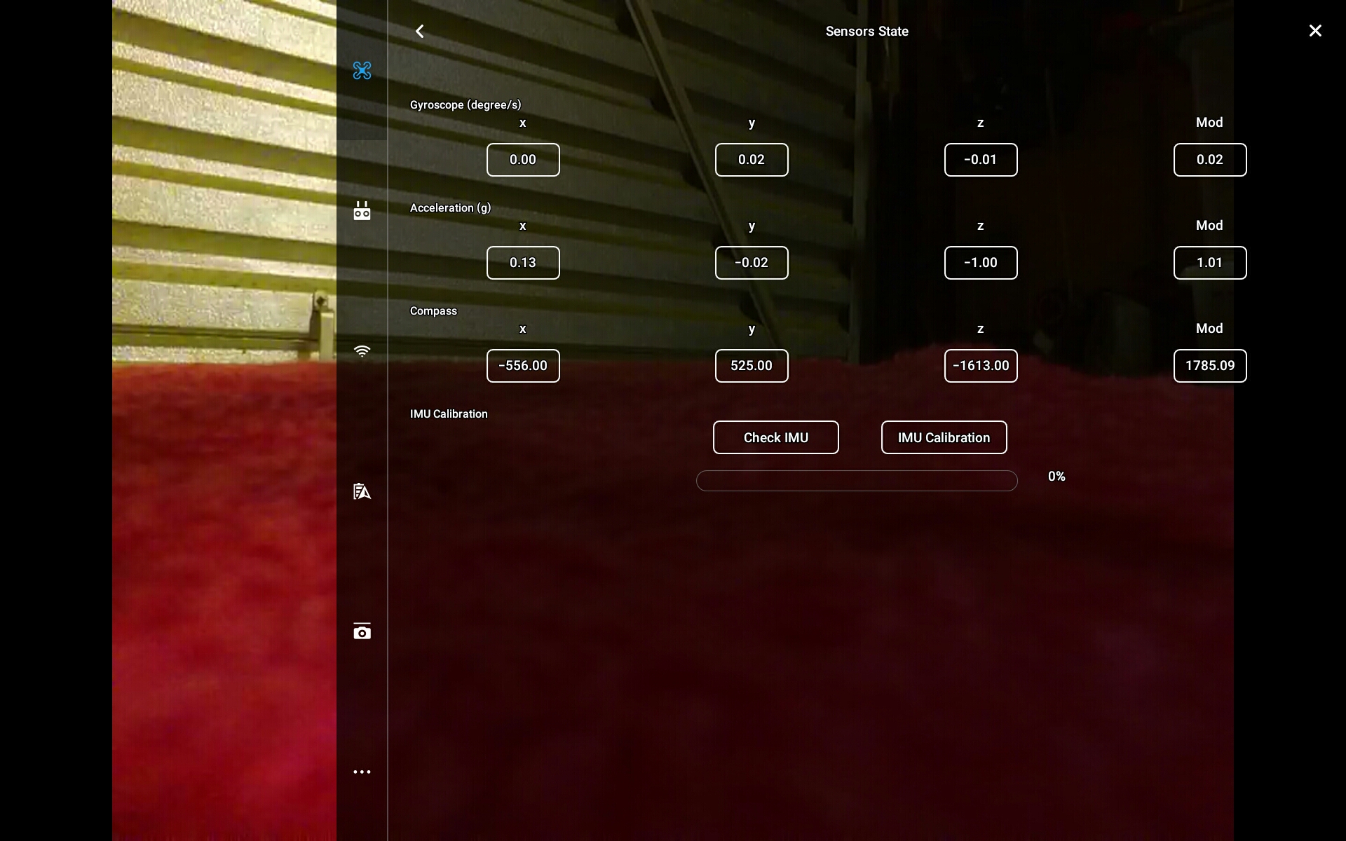

Just had idea to check what the compass and imu are doing,,you can give it a imu calibration check which sposed to show any abnormal behavior (the drone not me) ,,if it required it will show ,,there will be to much fluxuating of the numbers,,gosh I hope that right but sure that's how it go
Reactions: MotorCycle-Man

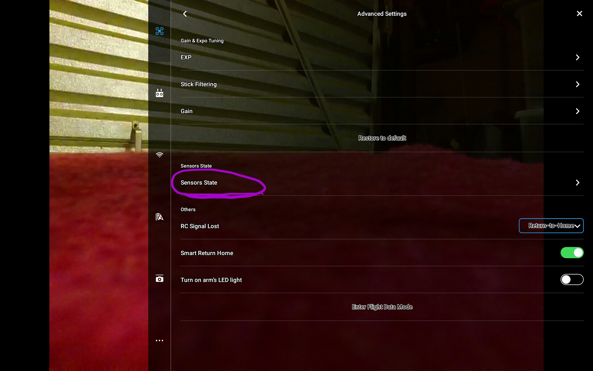

Have a look here,,,not 100% it will work but if something not righto,,start here,,this will hopefully sort out what up without digging deep,,,it probly would not hurt to to imu calibration to corect any drunken sensors,,,,,,,and yes watch the oil...it's not required,,,if not the right oil which there is a right oil it will attract dust and grit and work like valve grinding paste,,there is a oil ,non magnetic but don't know what called,,,these bearings are sealed and if they wine or stick they are shot,,oil just 5 min fix...berring has good life span like motor but on occasion they do xxxxxx themselves like any part
