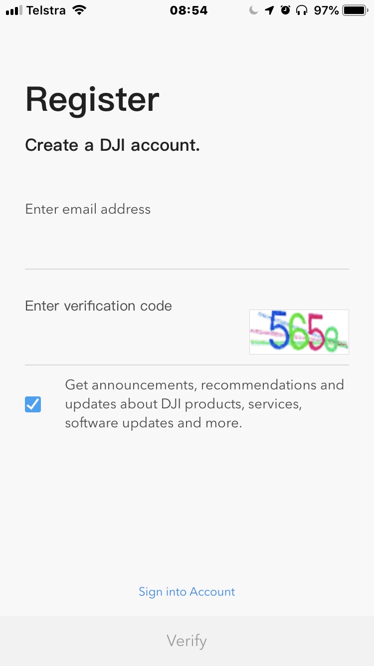

When i log in i see a home screen with advertising etc about DJI then it gives you the option to sign in or sign up so here is what happens
1/ enter my user name
2/ enter password
3/ enter captcha code (or how ever it's spelled lol)
4/ it asks to sign up but before you can you have to read terms/conditions
5/ The final part i click in to read terms and the next step only takes you to facebook or other social media platforms like twitter etc from which i can't do anything else after that.
I even shared it on FB and came back and the account still does not exist.

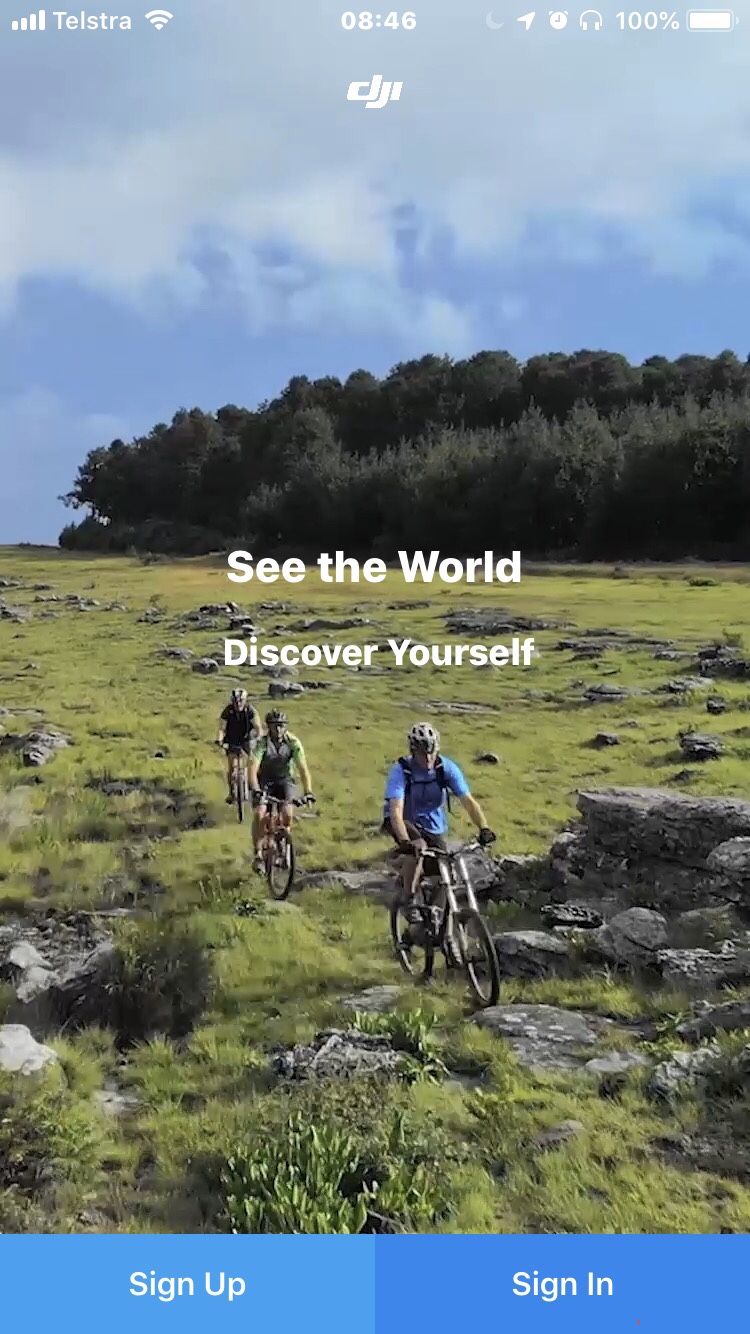

Hi if you are creating a new account then ,
1/ after down loading the app(for the P3 variety of drones as talked about above MAKE SURE you are connected to the internet not the drone wifi...
2/ Open the app and click on sign up if you are creating a new account or sign in if you already have one set up
3 enter you email and desired password the follows the prompts

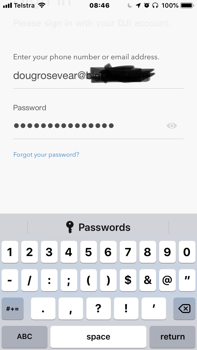

If you already have an account then click on sign in instead
Then log in with your email

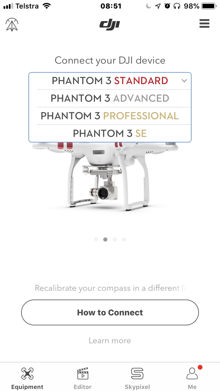

You will need to swipe left or right to find the Phantom3 drone family then click the drop down box to find the P3Se

Dan, the app is useless for registering a new account, go to dji.com on a laptop or pc and create the account on there, once created make sure you have internet on your device and open the app, once it gets to the sign in/sign up section hit sign in and enter your details, be warned that the app hides the sign in button under the keyboard and shows the sign up at the top left of the screen so once you have entered your details hide the keyboard and press the sign in button that is at the bottom of the page.
let the app go through its startup then kill the app and go through the normal connection method
