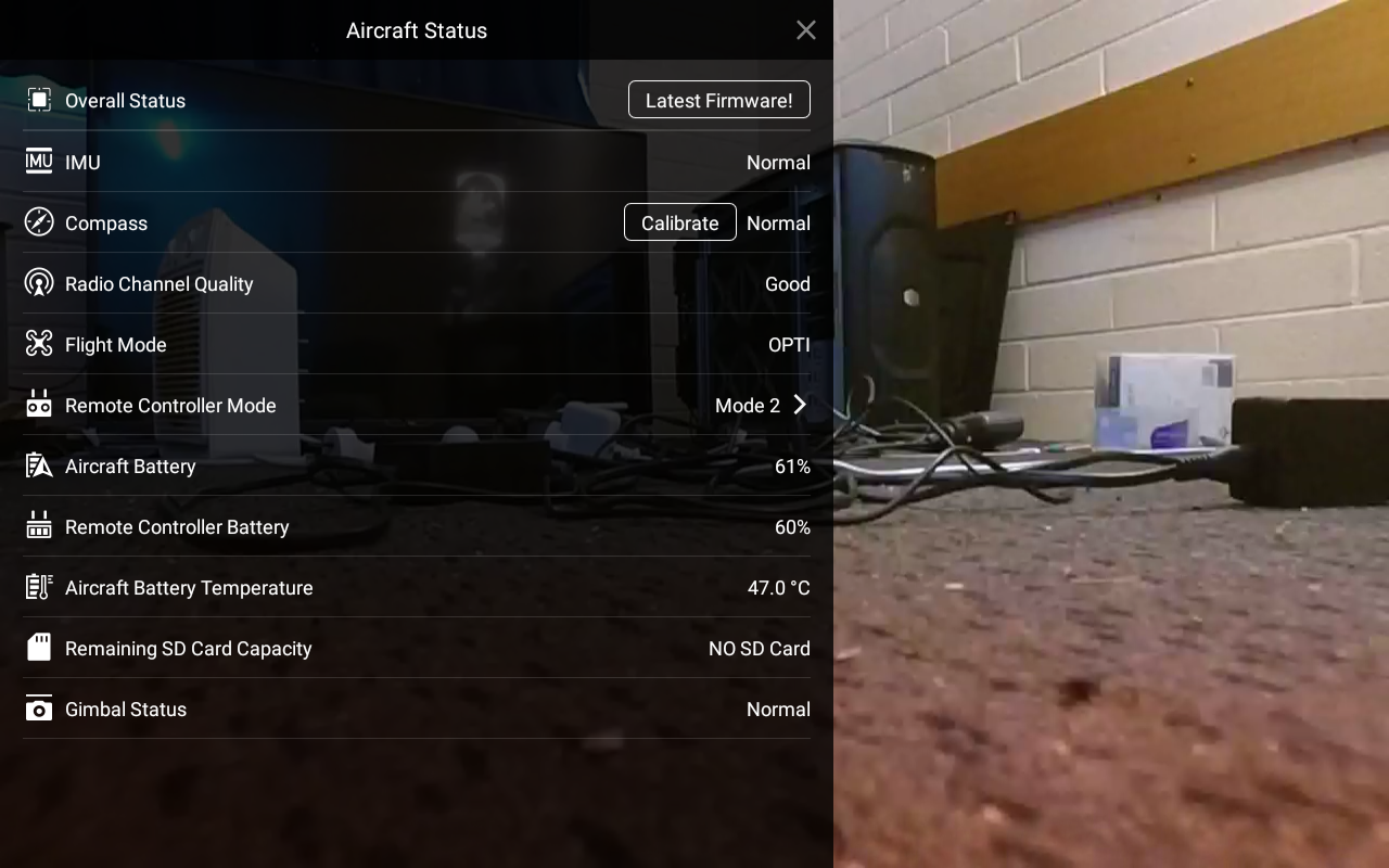

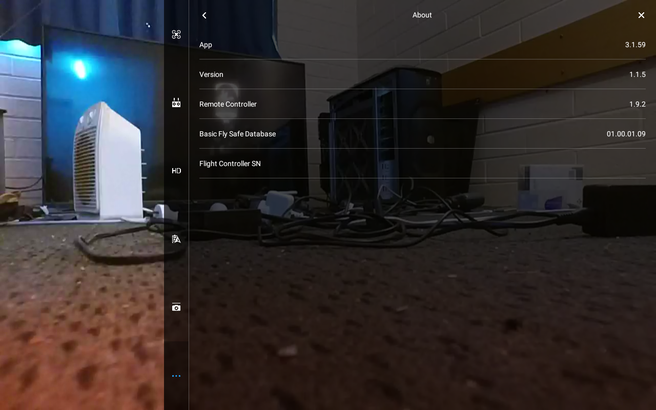

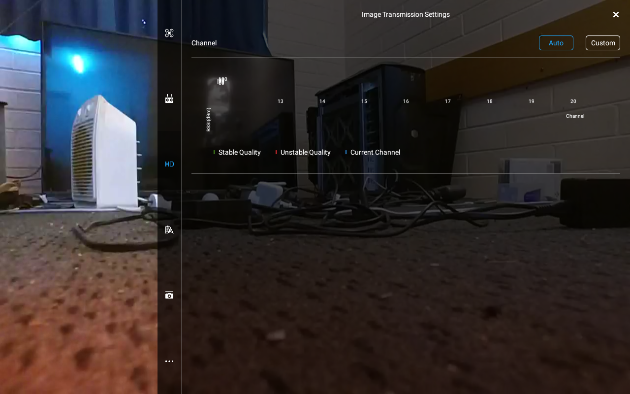

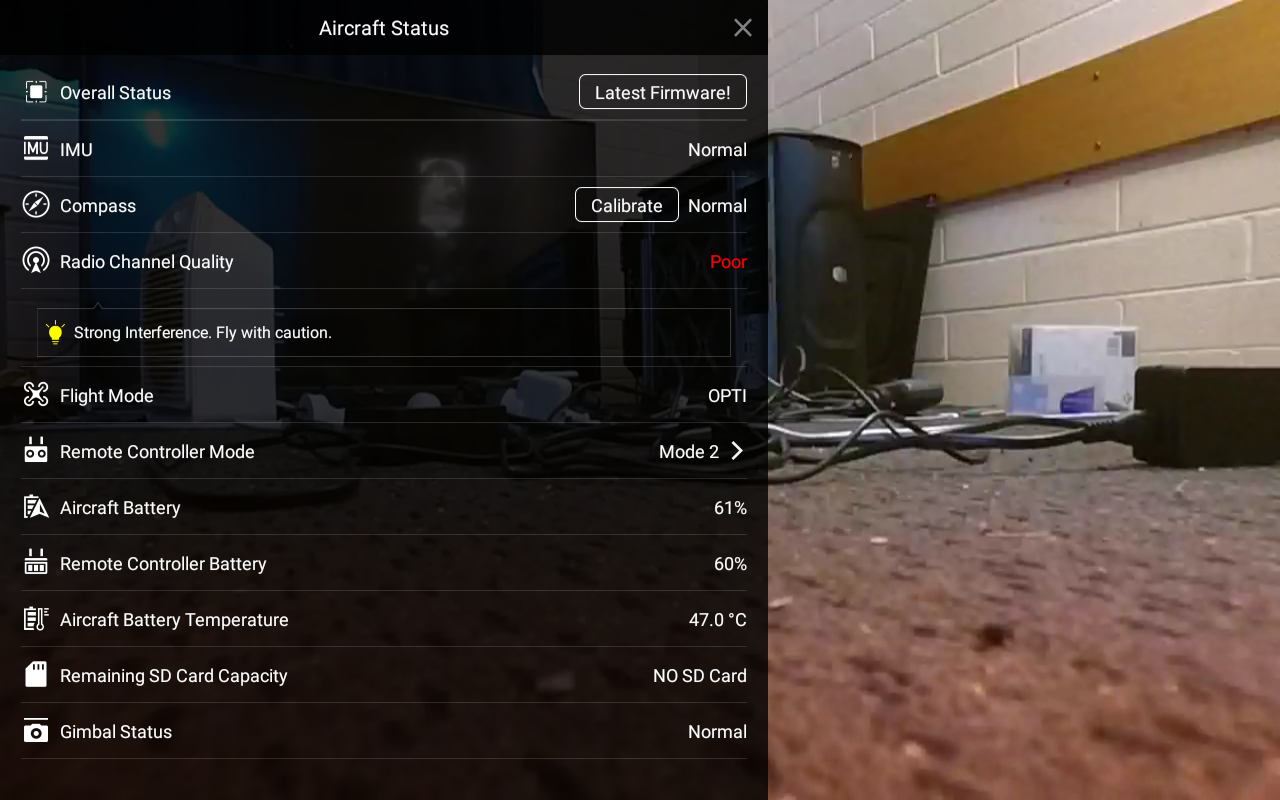

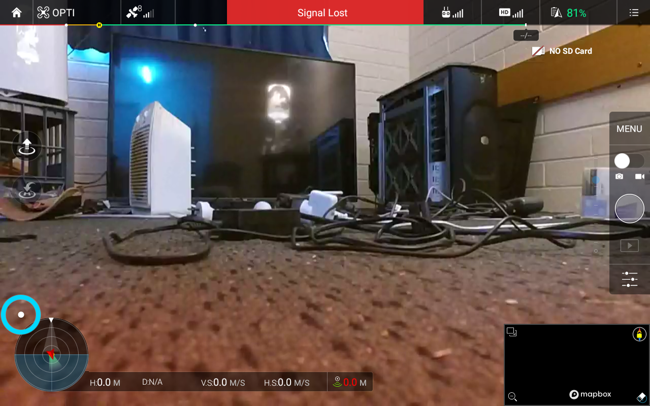

A few more screenshots of app
Hoping these may help in some way.
Rignt now im using galaxy tab with latest app to connect, i also have ipad i tried with old app that my p3s uses, no differenceScreenshot_2019-12-02-08-05-16.pngScreenshot_2019-12-02-09-02-25.pngScreenshot_2019-12-02-09-02-41.pngScreenshot_2019-12-02-09-02-43.pngScreenshot_2019-12-02-09-03-35.pngScreenshot_2019-12-02-09-05-17.png

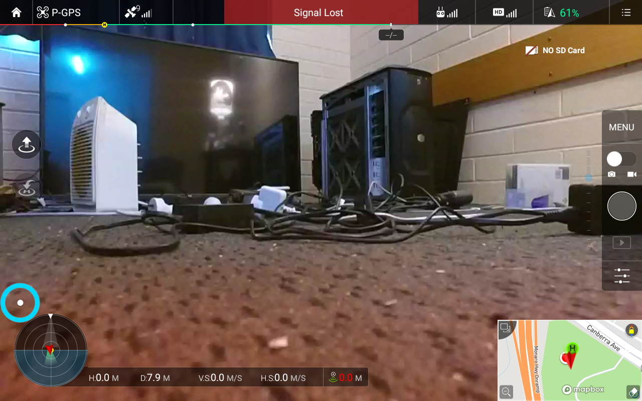

No where in your screen shots does it say "Aircraft Disconnected" Where do you see this? Also which Galaxy Tab?
The first pic, says signal lost the big red bit up the top... ahh signal..lol
the bird does disconnect at times
Rignt now im using galaxy tab with latest app to connect, i also have ipad i tried with old app that my p3s uses, no differenceView attachment 115925View attachment 115926View attachment 115927View attachment 115928View attachment 115929View attachment 115930
The thing that instantly screams out loudly to me is AC FW 1.1.5 with RC FW 1.9.2. What is that, the original AC FW from 4+ years ago with the latest RC FW? If it were mine, I would first install an AC FW version of 1.8 or later and then relink. In fact, I'd probably install v1.8 to avoid adding complications with later versions until I first had everything dialed with v1.8.
