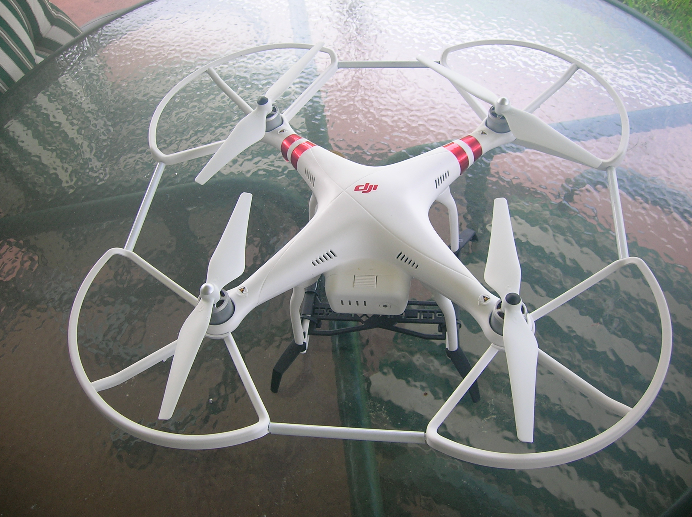

Did you use the String that comes with the Prop Guards ( If that was in the kit ) There has been one post here that the String came off & tangled in a Motor & it also crashed . After reading that , I removed mine & installed Carbon Arrow shafts , cut to fit in between the Guards & I have ran into a lot of branches & a Cement Power Pillar with no damage . Speed will be a factor , I will not take mine off , because of where I fly .View attachment 73809
Did you buy the shafts or make them? If you made them I'm interested in possibly getting some made.
