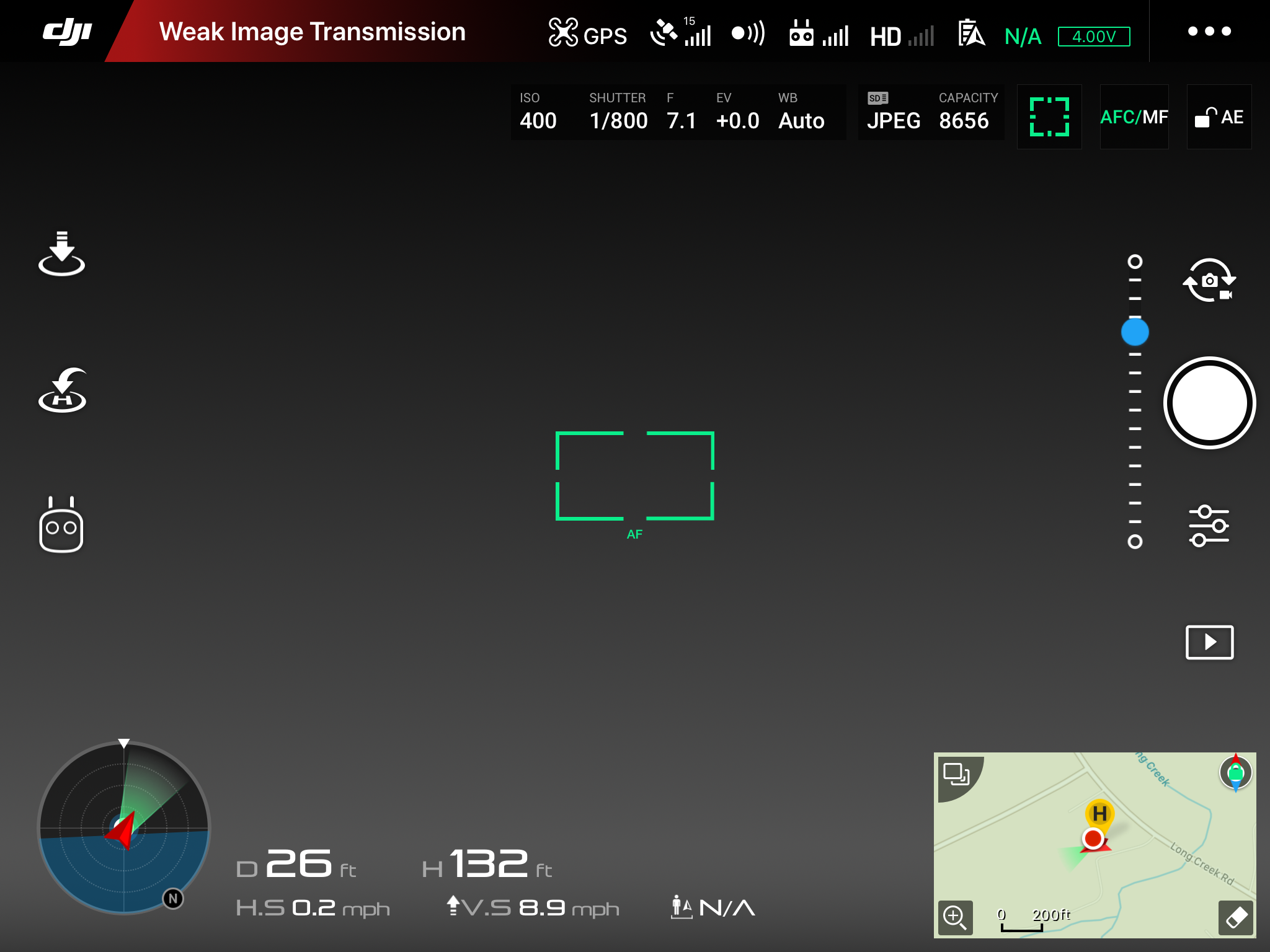

DJI just sent me a replacement drone for one that I crashed a few weeks ago. The day the new one arrived, I paired it with my existing controller and took it out to be sure all was good. I only flew it for a minute or two.

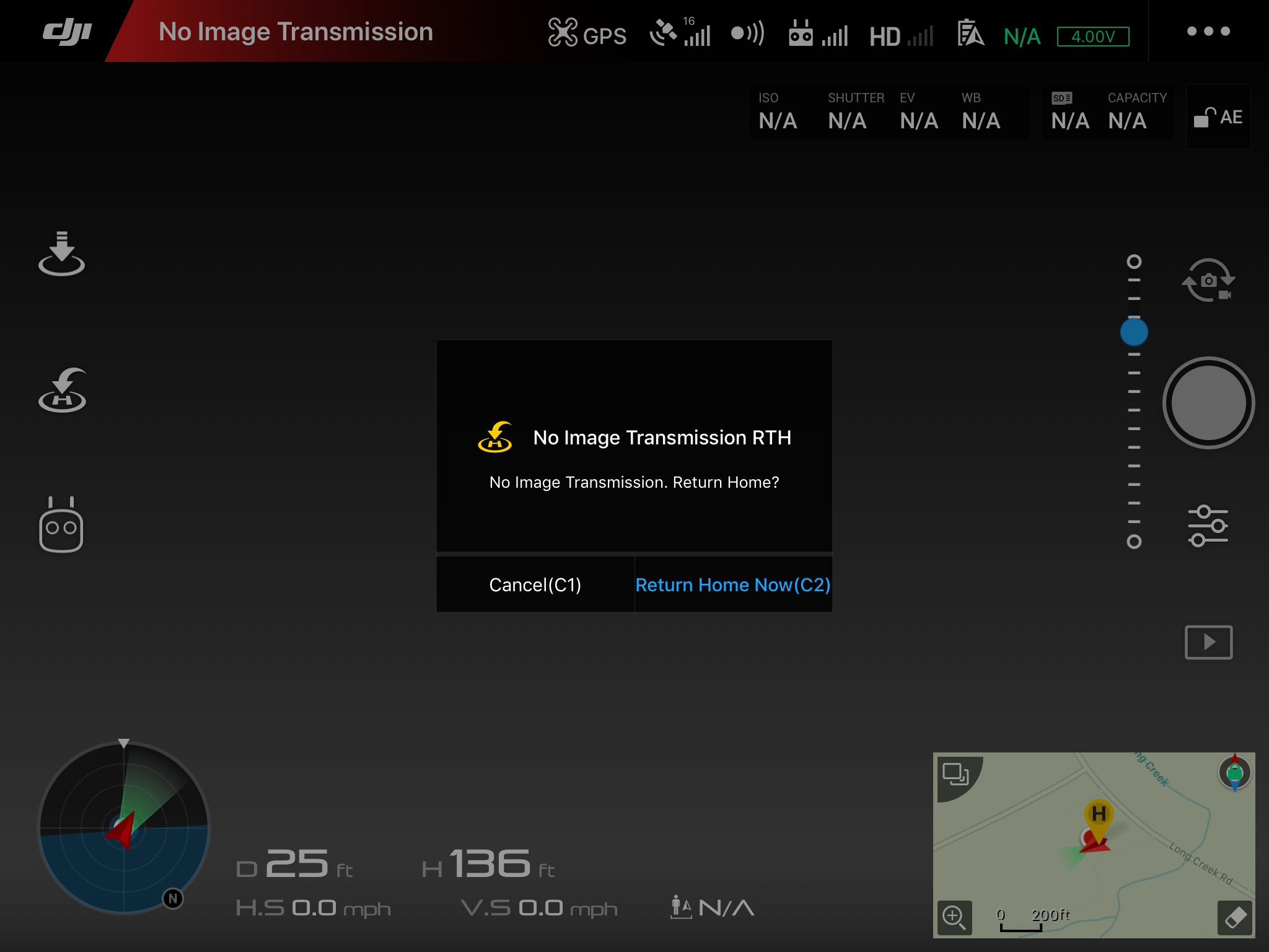

Last Saturday was the next time I used it. I launched it and after it got only a short distance, maybe 130ft, the screen went black. I got a weak signal message on the controller and it said adjust antenna. Then it said it lost connection and asked if I wanted to RTH. Since it was still very close to me, I said no, and I brought it back down. I tried it again just now and same thing happens. Any ideas?

From your image, it appears as though telemetry is transmitting. Video and Telemetry are transmitted together. If you are not getting video, I would suspect an aircraft gimbal issue of some sort. I will be willing to bet that this aircraft has the latest firmware which also has been an issue for some.
Yes, the telemetry is coming through to the controller fine. It is just the video that is not. Yes, it has the latest firmware. Any suggestions as to a fix? Send it back to DJI?

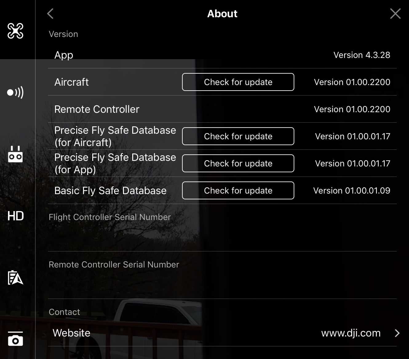

Just what firmware is showing up in the remote controller...touch the tiny bars in the upper right corner of the screen and when it opens UP...scroll to the bottom.....you will have a list of the firmware version and App version.... we are all waiting for that set of numbers !
Reactions: Capt KO
All seems to be the latest version.
