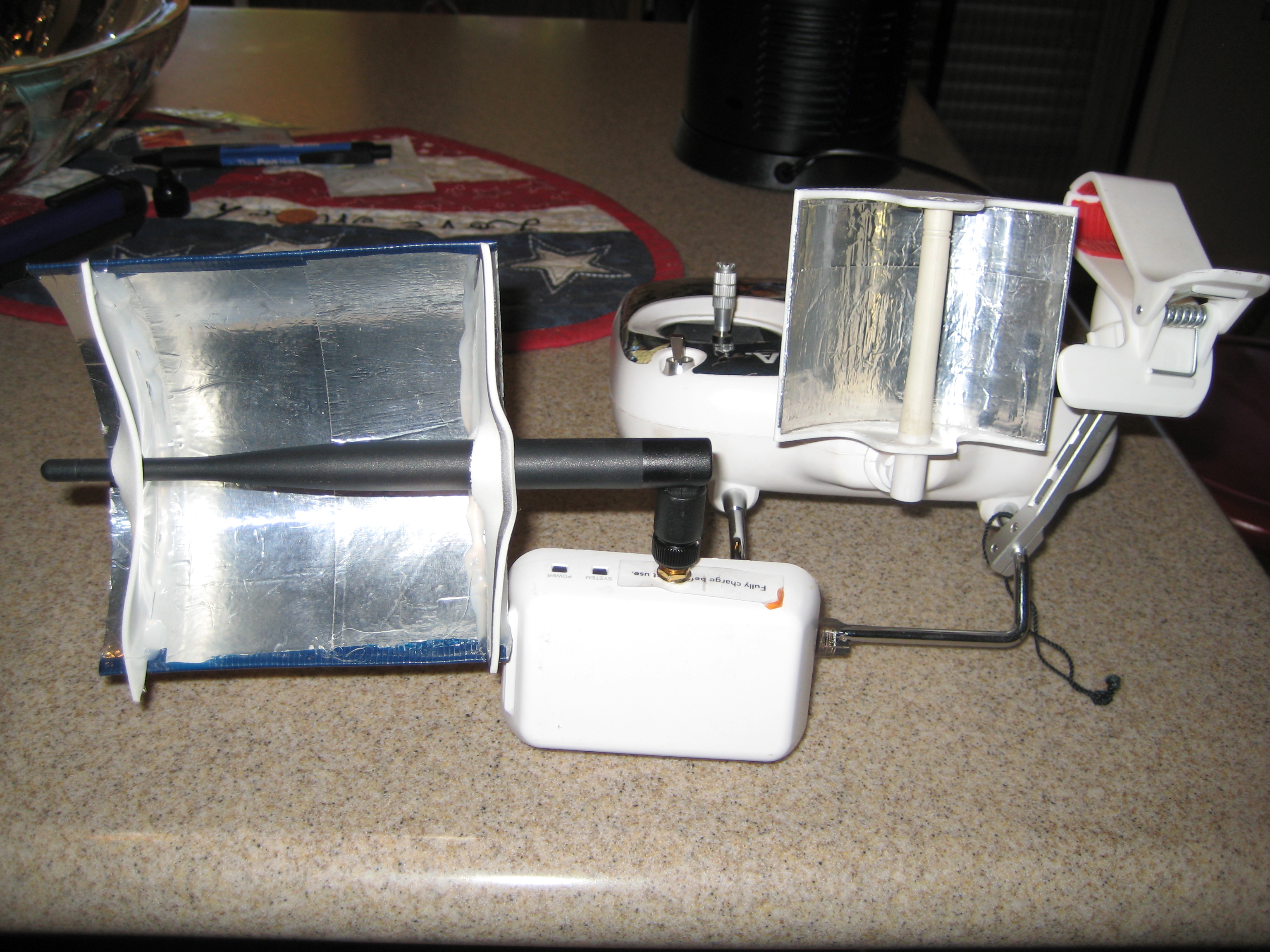

I was back out to my local spot this morning with Buddy Tony. I was having problems getting past 6000 ft ( the same place I went 10000 ft). I tell Tony I can get past 6000 ft and I was showing him And it made me a liar and went out to 11901 ft. I was going to stop at 12000 and I hit a no signal at 11901 so I turned around. Still running stock rc antenna with wind surfer & one external antenna on the wifi with a DJI puck antenna. I keep thinking I'm at it's limit and it keeps proving me wrong.

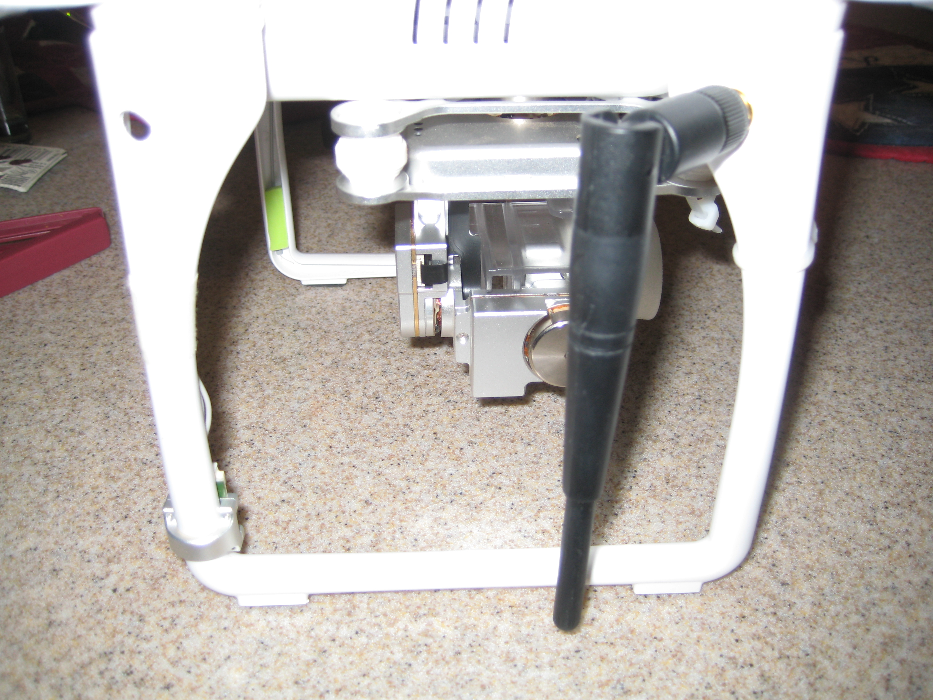

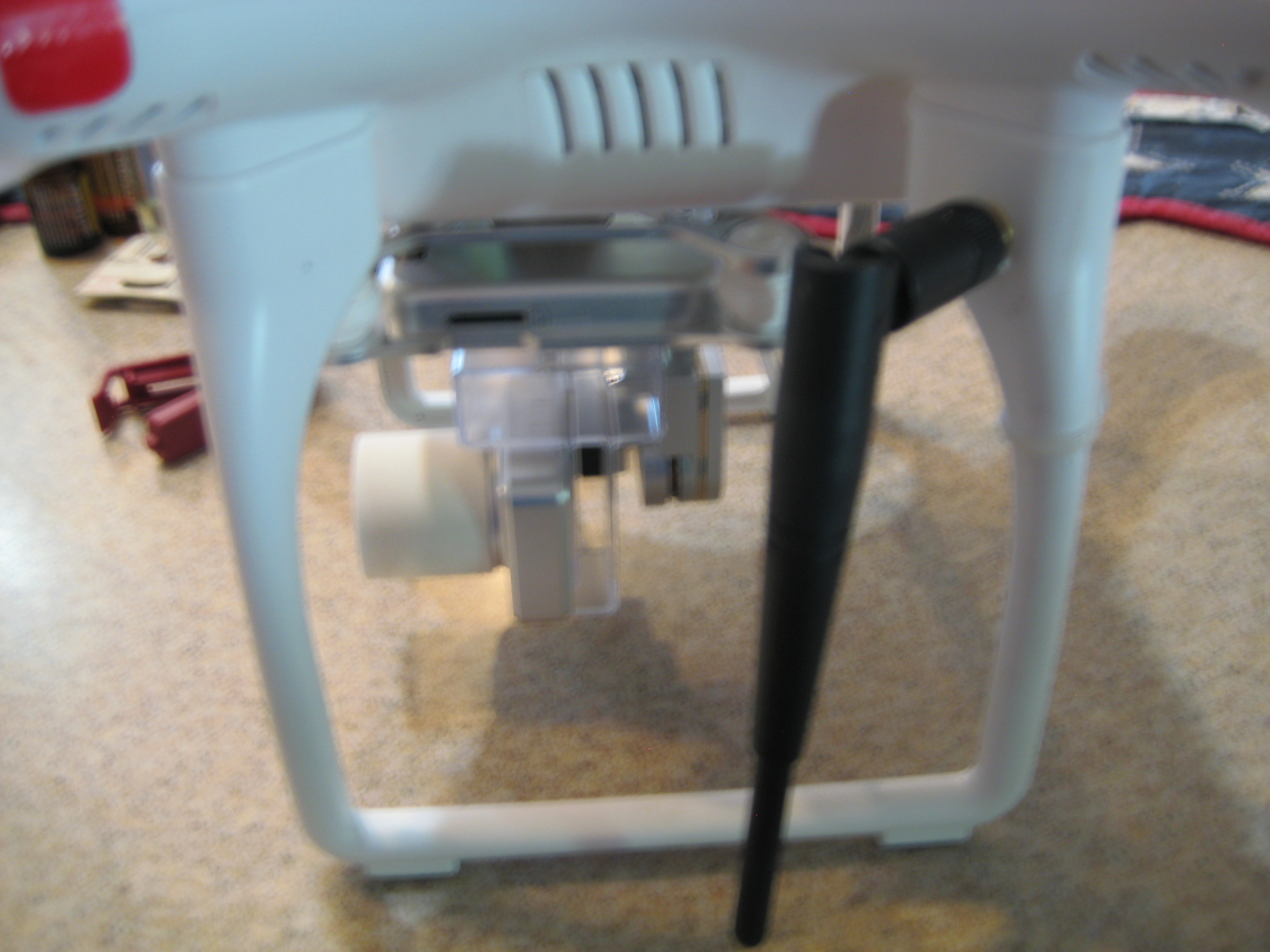

just running it stock on the most part. with wind surfs. using a Re700 with one external antenna and the internal puck antenna. on the drone just replaced the puck antenna's with the dipole. I also moved the range extender out about 1.5 inches. I found with the external antenna on the range extender it was cause problems with my r/c antenna. In the picture you can see it's out a little farther. used an Allen wrench epoxied it to the bar. you can see the end of the wrench in the picture. It did not seen to make any different by having the dipole sideways on the wifi side with the wind surfer. Oh and yes running in GPS mode until RTH kicked in.
