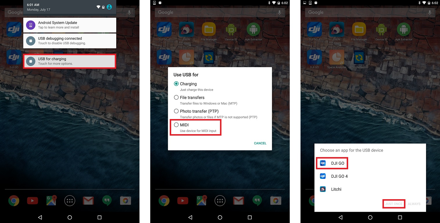

@JamesVG, I was able to connect the Huawei Ascend XT2 to my P3P with DJI GO 3.1.23 (the current version).
Are you sure you're running DJI GO 3? If so, make sure you have your USB port setup like this:
If that does not fix the problem, then try using a different USB cable. Perhaps you're using a charge only cable.

Thank you, the USB port selection made it work correctly.
The P3P and Mavic are both working now with the Huawei phone.
