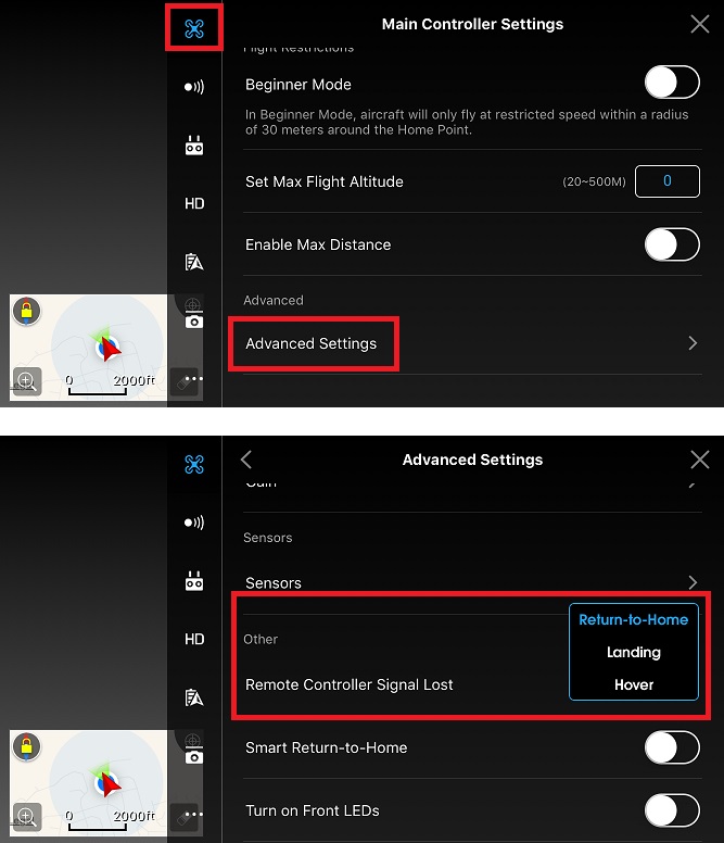

    By default, your Phantom will auto land at its current location 10 seconds after the signal has been lost when GPS is not available. You can choose an alternate behavior in the following section of DJI GO:
    If you set it to "Hover", that might give you enough time to reestablish the connection before it lands. If you're not able to reestablish the connection, your Phantom will auto land at its current location when it reaches the critically low battery level.

    It will do whatever is selected in my screenshot above. When any type of RTH is initiated, your Phantom will always auto land at its current location if it does not have a GPS connection.

    As your screenshot states, this setting is only when the "Remote Controller Signal Lost".
    For example, if I power off my remote controller (assuming that the Phantom has GPS lock) it will either return to home, hover, or land. This setting has no bearing on what will happen "after the signal has been lost when GPS is not available" as you stated.
    If the signal has been lost AND GPS is not available, how would it return to home?
