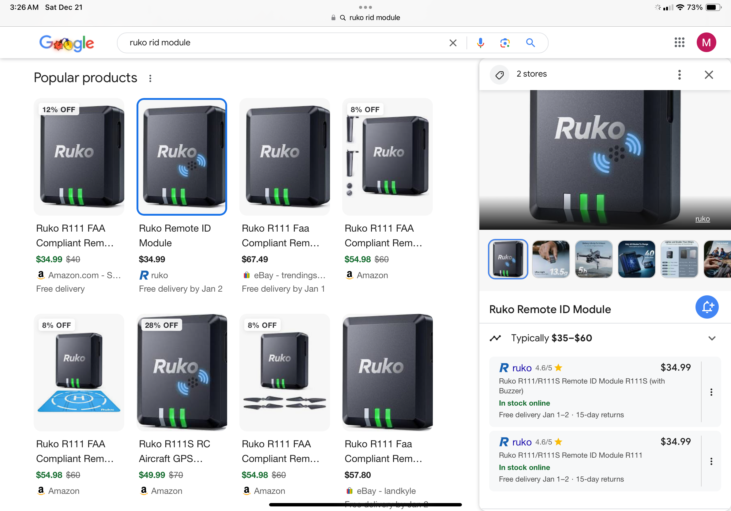

I’ve got the RUKO, it looks to be a similar size. There’s really not enough flat surface above/below the battery box. I’m going to try it on one of the rear legs and see if I have the RTH issue. But under one of the arms might work. The RUKO comes with a sort of zip tie with a mounting square attached to it.
