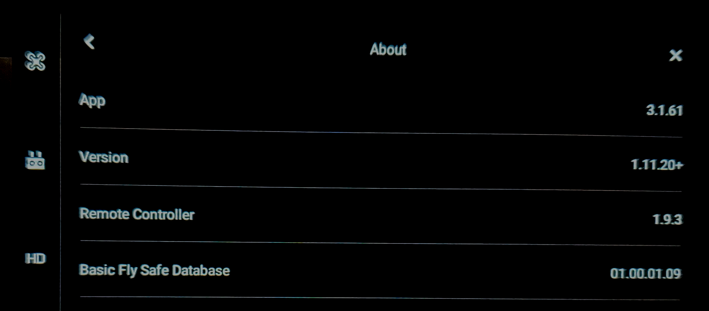

The next day I started it and had no disconnect issue. I did not fly it, I did this several times in the next two days and have had no disconnects. I wanted to test the controller so I turned the craft and the controller on and walked outside, got in my vehicle and was able to drive more than 500 feet away before I lost connection. I drove around my block and then at about 700 feet away the drone reconnected and stayed that way all the way back to my house. Keep in mind that the signal had to travel through trees, houses, cars and probably a few people and animals. I'll have to test fly it when I have a chance and report back. Here is an image of the about section of the app. I have access to the misc folder, those text files have a lot of info on them.
