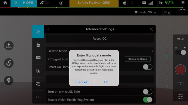

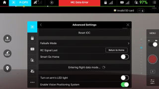

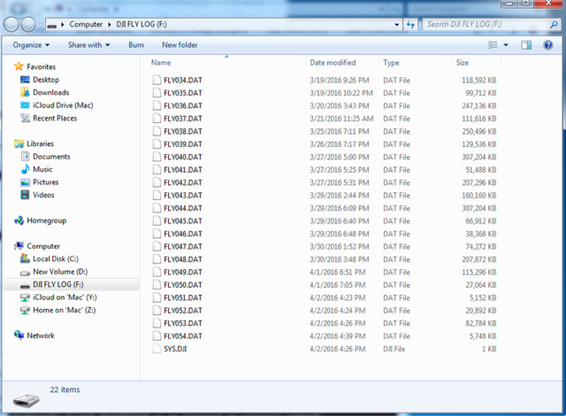

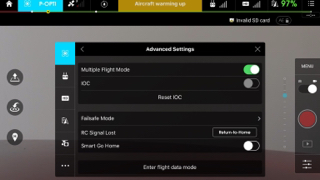

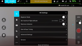

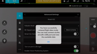

There's a micro-USB plug on the front of the aircraft. There's also one on the Gimbal - but that's not the one we care about. On the very front of your molded plastic shell, there is a rubber flap that covers/hides the port.
Before you connect any cables to it, you need to run the DJI Go app and connect to the aircraft normally. Then:
1. Click the icon in the very top right corner to bring up your settings.
2. Click the top icon in settings. From the screen that appears, scroll down and click on "Advanced Settings".
3. On the Advanced Settings page, scroll down and click on "Enter flight data mode". Click OK on the popup that will appear, then wait 30 seconds for the next popup that says "You have successfully entered flight data mode".
4. At this point, you can turn off your iPhone/iPad and your Remote Control, but leave the Drone powered on and plug it into your computer. Make sure you plug into the micro-USB port under the rubber flap on the front of the drone.
5. After a few seconds, a new drive will appear in Windows Explorer or you may get a popup asking if you want to open a folder to view files. Really, at this point, your drone is nothing more than a USB flash drive.
6. Use Windows Explorer to view the files on the drive which will be named FLY###.DAT. Find the ones with the date/time stamp matching the time of your incident and copy it to your computers desktop!
7. Disconnect and power off the drone.
8. Upload the file here!
You don't know if the files from the incident exist or not unless you follow this procedure and look. Even if they are gone - you should see files from the test flights that you've made today - but I'd bet there's a pretty good chance your .dat file from the incident is still there!!!
Why don't you humour us and have a look? It will be good practice for the next time something goes wrong and you need to submit the .dat file to us. If the file from the incident is gone - go ahead and upload the one from your little test flight today and maybe someone will take a look to see if they can see any messed up sensor readings.
I've attached photos of every step so it should be pretty easy to follow.

So what's up here? This post above states that they replaced the entire unit but I just watched your first video in which you say they definitely did NOT replace the entire unit. You also said that someone helped you try to get the logs off of your iPad - but the logs people were asking for are not stored on the iPad - they're stored on the drone itself.

Since the .DAT wasn't available I wanted @Romans109 to retrieve the .txt. Here's why. There are two types of FollowMe mode fly-aways. 1. the tablet doesn't have GPS data that is accurate enough. The data required to determine this exists in the .txt file. 2. The tablet has the correct GPS data but somewhere between the tablet and the FollowMe mode P3 navigation module that data gets corrupted. To show this conclusively both the .txt and the .DAT are required.
However, type 2 FollowMe mode fly-aways also have the property that the data corruption always occurs (and the fly-away begins) exactly when FollowMe mode is initiated. From @Romans109's description I speculated this is what had happened. Since the .txt contains velocity and flyCState I was hoping that it could be shown that the P3 sped away on it's fly-away at the moment flyCState=25 (i.e. FollowMe mode). Although any conclusion that it was a type 2 FollowMe mode fly-away would be circumstantial it would be compelling never the less.
I talked to @Romans109 on the phone to try and get the .txt. We did the whole bit. Start from connecting the P3 to the PC, downloading the directory. etc. The only thing he had in the DJIFlightRecords directory was the file indicating the flight records that have been deleted.
I'm sure there will be those who think the missing DJI FlightRecords are the result of some fraud ridden attempt at a conspiracy to hide the truth. I don't think so; I was on the phone with the guy and he just doesn't care enough to pull off something like that.
One last thing. If the P3 had it's main board replaced then the internal SD card is new and will not have the .DAT from the incident.
