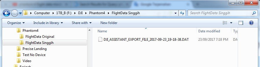

I used to use DatCon app to convert internal flight data into CSV format from my old Phantom3. But I still figuring out how to do the same with my Phantom4 since there is no "Flight Data Mode" inside the DJO.GO.app. I did get the flightData using the DJIAssistant2, but DatCon is no longer support it. Any Idea?

I used to use the
I used to use DatCon app to convert internal flight data into CSV format from my old Phantom3. But I still figuring out how to do the same with my Phantom4 since there is no "Flight Data Mode" inside the DJO.GO.app. I did get the flightData using the DJIAssistant2, but DatCon is no longer support it. Any Idea?View attachment 88628
DatCon does support it. Are you using the latest version (2.6.3)? Alternatively, just post the DAT file via Dropbox or similar.
i was struggling run Latest DatCon 2.6.3 inside my PC for the whole night, but 2.3.0 just working fine. I don't know what's wrong. Is this the correct .DAT we're talking about?? Thanks for your reply....
