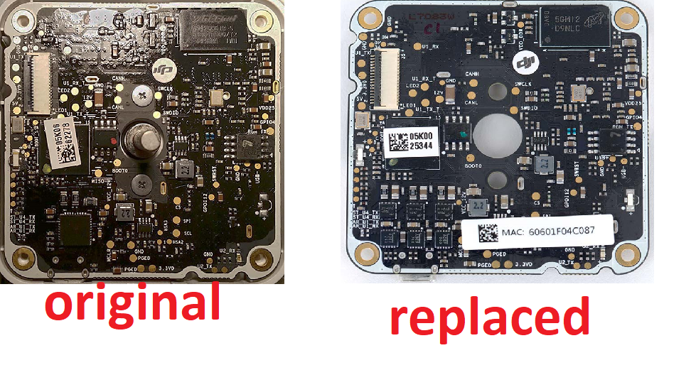

I replaced the gimbal top board on my Phantom 3 standard and after power on the gimbal led still solid red. I attached a picture with the original board and replaced.

I attached the pictures:
