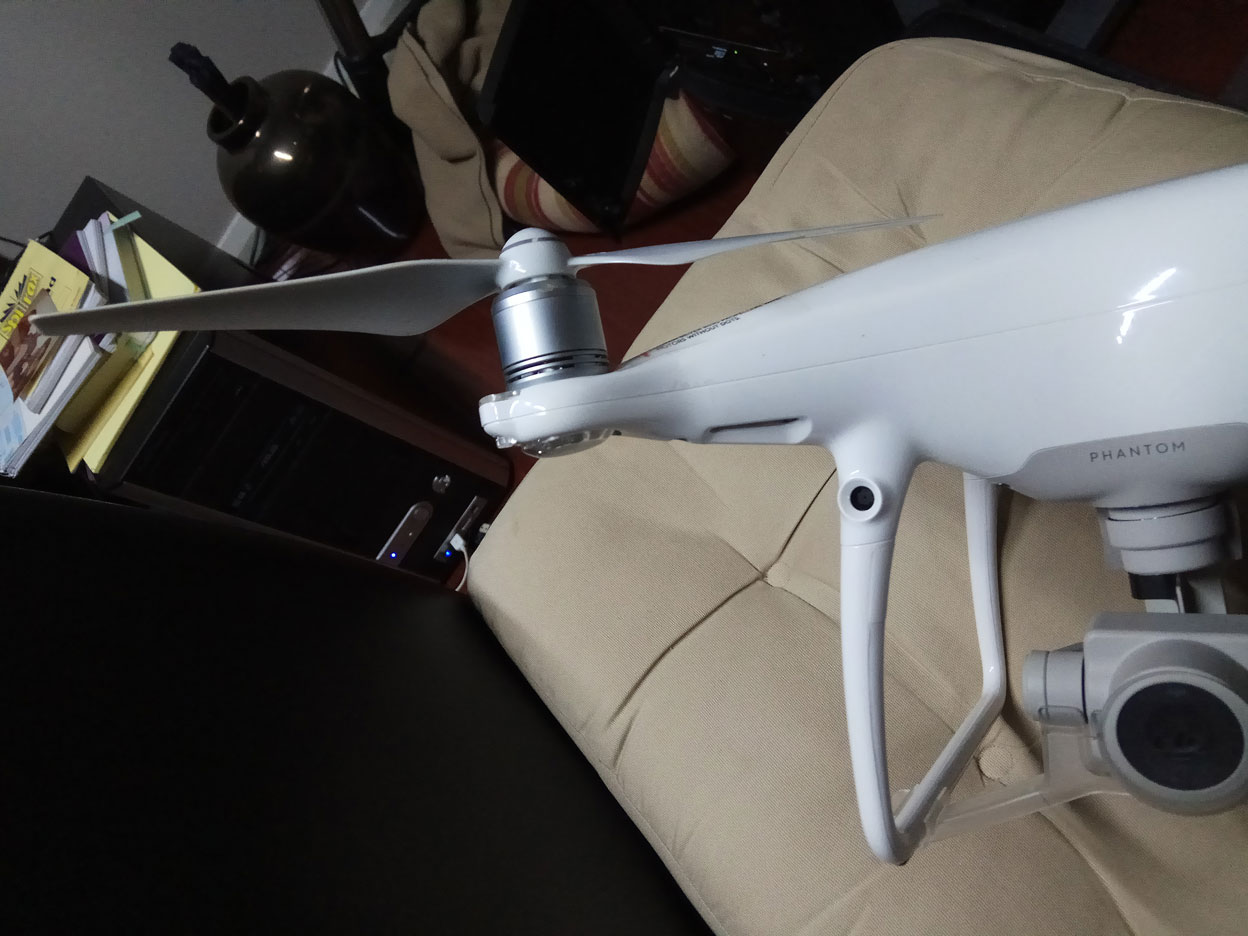

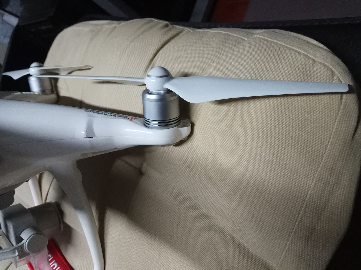

Hi guys,
I now have this issue as well after I hit a an air vent in flight. It gave the drone a good bump but did not break anything, just creased the upper and middle shell.
I am getting gimbal overload messages.

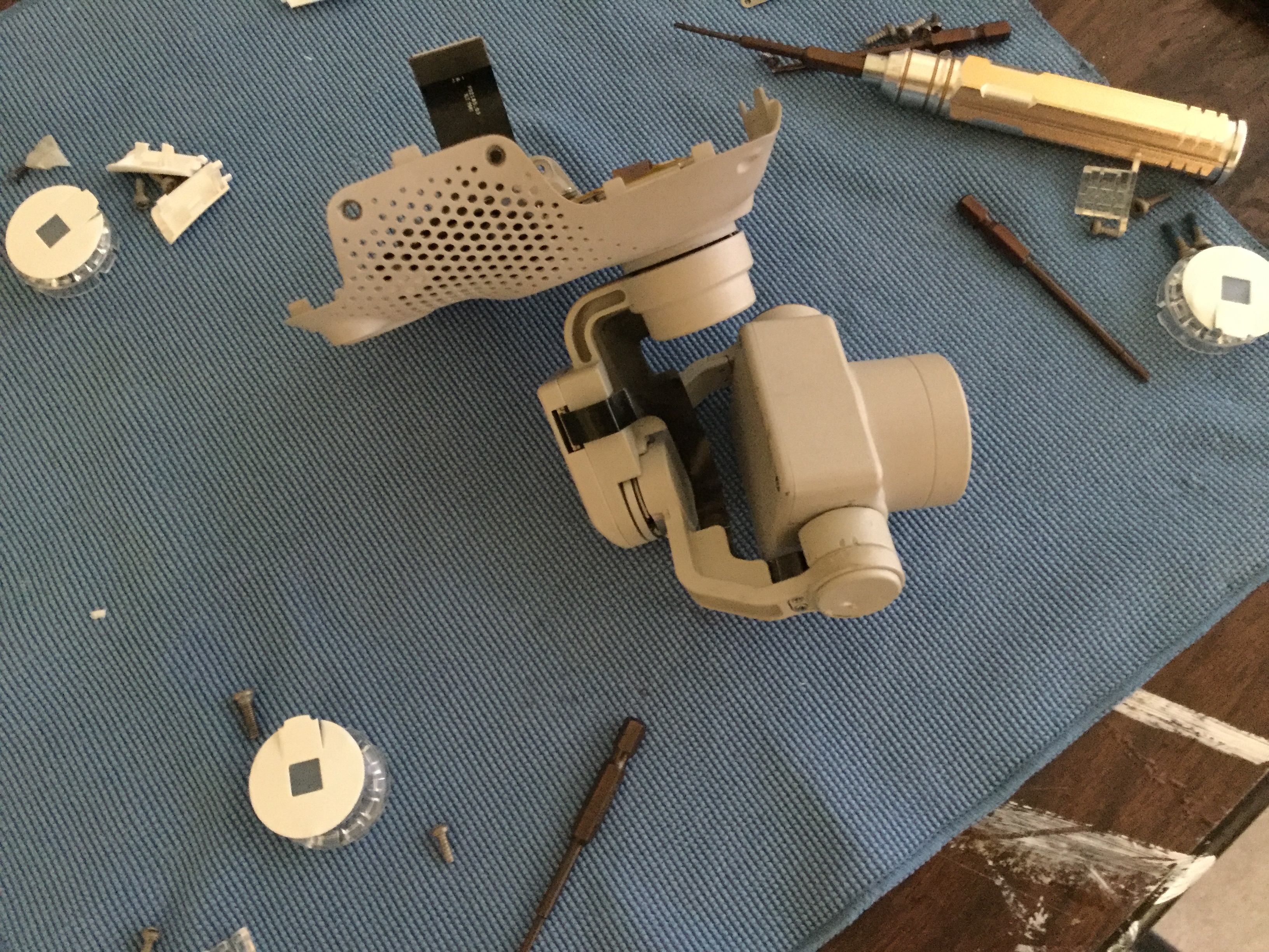

You might have bent the roll arm. Or, the ribbon cable may have moved where it is glued to the roll arm.
Hi Kewald,
Would you be able to post a photo or link to the roll arm as I am hoping to replace the shell myself as I have found a great shell replacement guide from this forum. the crease in the front right prop/motor arm is amazing as there is not a mark on the other side of the arm.
did not even mark the prop...

Hi Kewald,
The gimbal roll arm is the normally horizontal arm that connects to the yaw arm and to eac side of the camera.
After you remove the lower and middle shells be sure to check for internal damage. An impact hard enough to crease the shell could have resulted in visible internal damage and invisible electronic damage.
