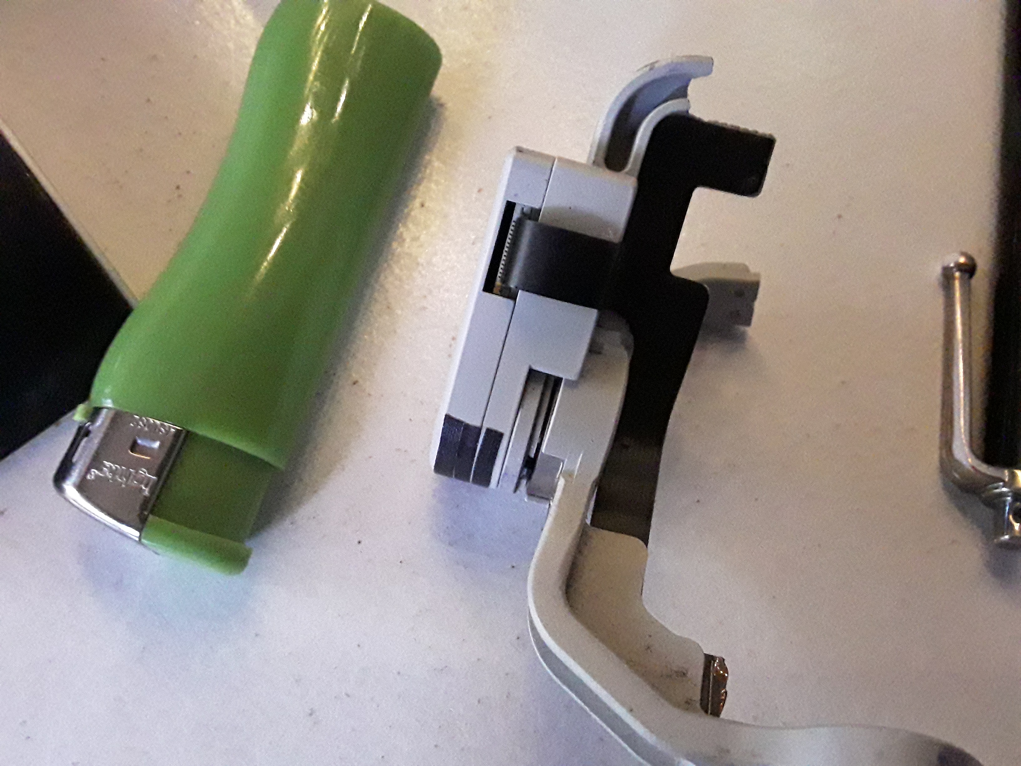

Oh no one likes a crash,sorry to read,Um, gimble ribbon look ok ? I sure the gimble motor I pressed together,any unusual play in this area,,to me sounds like only just making contact,this old p4 one just for example,any play in this motor,possible this motor could have been damaged on impact or hard knock,it's not gone over tight has it ,,if mine I would carefully dismantle and if no damage reassemble it might come right,if not and gimble cable ok you might need to buy a replacement gimble motor, easy to change,hope this help a bit
