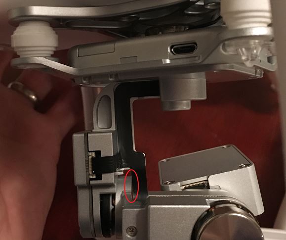

The camera on my P3S is tilting and I believe it is being caused by the ribbon cable too close to the gimbal arm. When I move the arm back and forth I hear it scratching against the cable. Below is an image of the cable which shows it resting against the arm. Does anyone else have this close of a clearance between the two? If not then anyone know the best way to tackle separating it?

The ribbon can be easily moved if you think that is the problem. Most the time there is a misalignment in the roll motor shaft and the camera. There are lots of U tube videos that show you how to line it up.

Just press your thumb down to that part of the cable and drag it out a little bit while pressing down. It will move and you'll be just fine.
Ended up being caused by a lose screw inside the gimble, which is probably what WV Rootman was referring to. Just took it up for a test flight and it worked great. Thanks.
