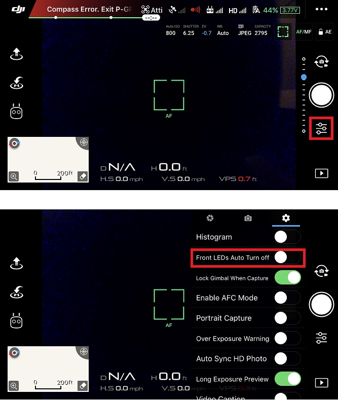

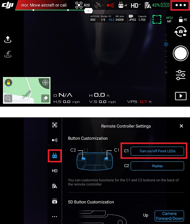

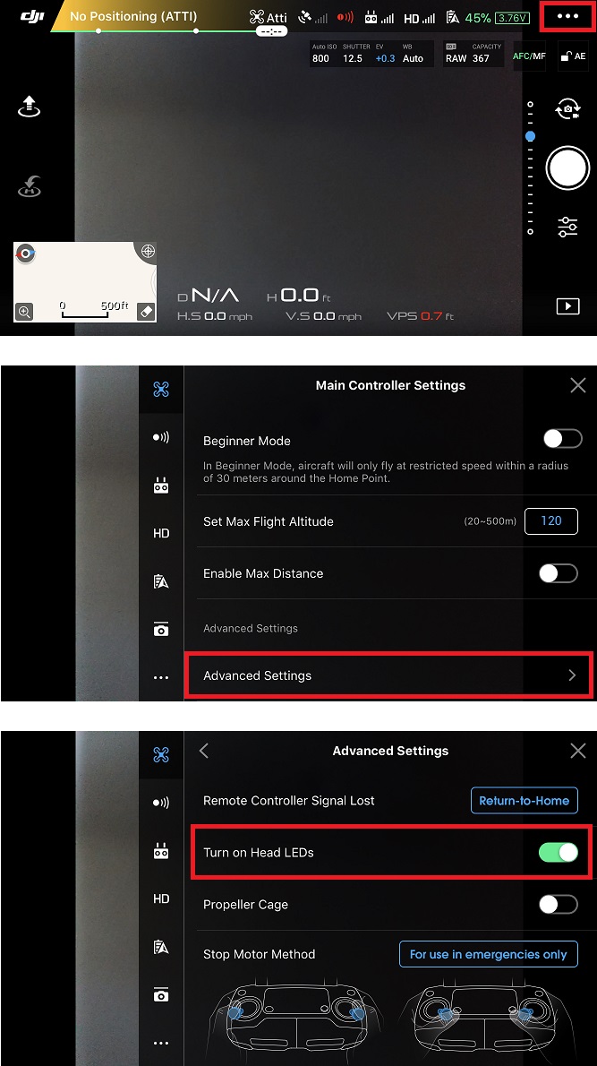

I own an amazing but second hand P4. The normal red front lights are off. Pls remind me of how to switch them on. Thanks chaps.
It’s in the settings in the app. Hit the vertical dots in the upper right corner (go4) and review all the settings because you need to anyways, you’ll find it.
The front LEDs can be configured in the following sections of DJI GO:
