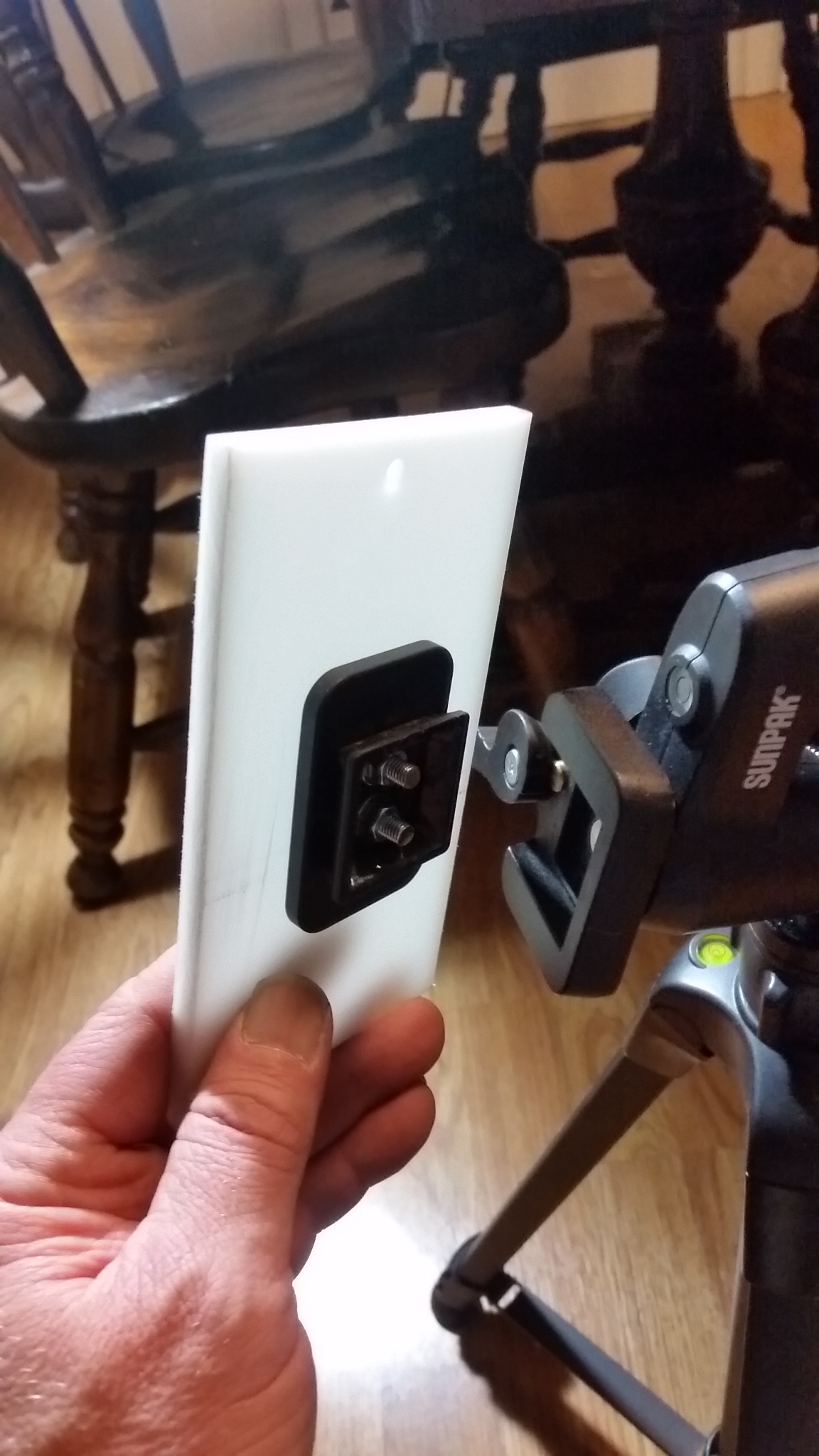

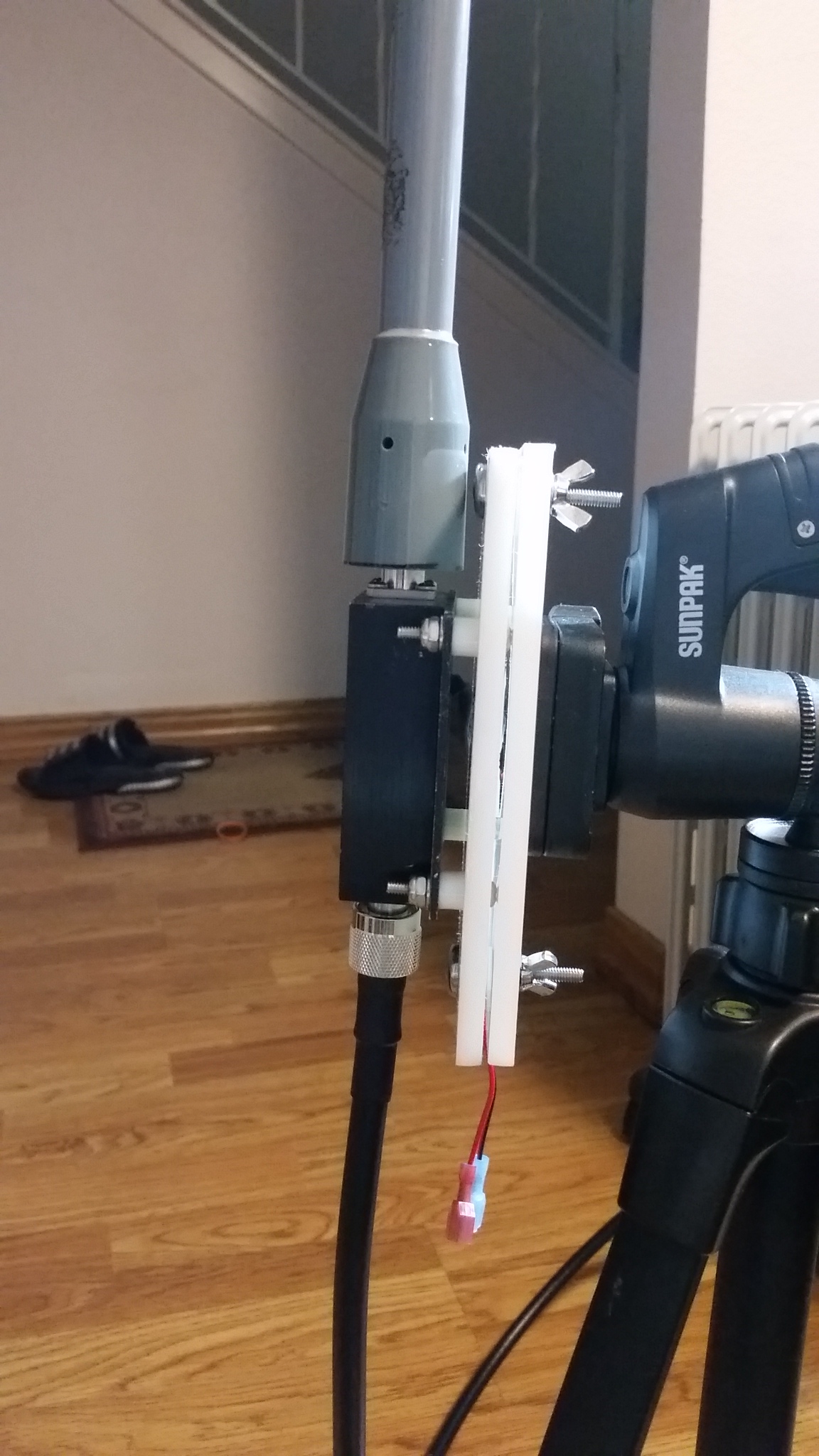

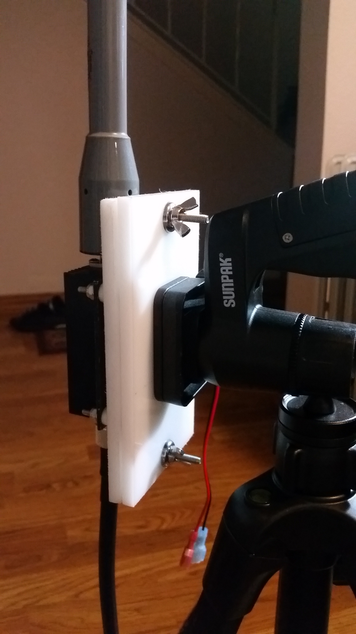

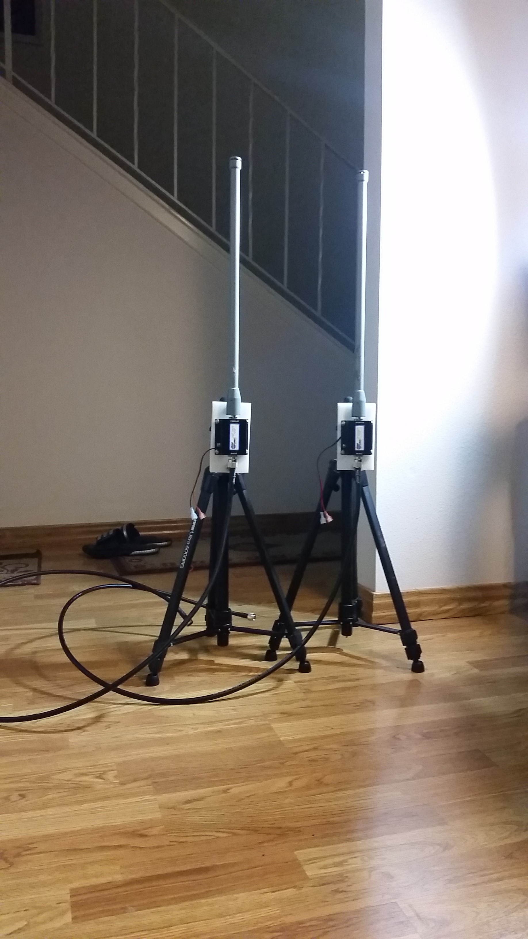

Spent a week planning/buying materials. Finally got the RF-Linx mounted. Ready to test, and they better work. Got them a month ago and havn't even had a chance to test yet. Was waiting for LMR-400 cables and various N connectors. I'm also fabricating mounts for my TP-Link panels for this tripod mounted method. The mounts are interchangeable with each antennas mate surface to the tripod.73771[/ATTACH] 20170117_195027.jpg 20170117_192439.jpg 20170117_195902.jpg 20170117_195834.jpg

Nice McGyver skills. Love it! I'll dare to guess that your replicating the backside of your mounting bracket for the extendable mast for easy switch out?

'Zactly.... Interchangable mounts/amps combo any to any.
