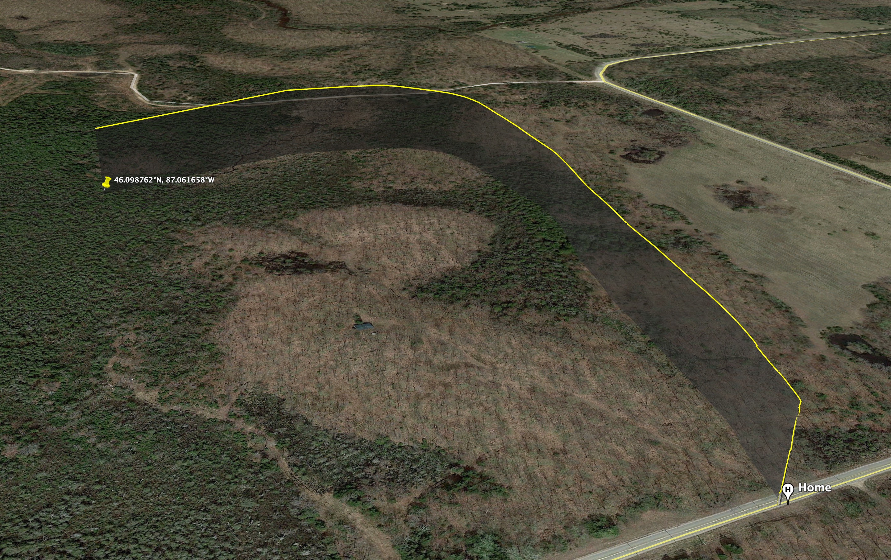

So yesterday I was flying a forty-acre parcel for a buyer when my P4P obsidian decided it wanted to misbehave and flew away, never to return. Sooo I am waiting to see if DJI is going to replace it, but if not I will be looking for another, I don't believe I will need any accessories like remote or batteries.
Here's what a short summary of your flight data looks like: DJI Flight Log Viewer - PhantomHelp.com
The recorded data only lasts for 4:05.7 and it appears that you were in full control until the data ends.
You were losing signal with a few lost downlink messages after 3:29 and the downlink was lost for 32 seconds on one occasion.
Signal was lost completely a few seconds later.
Losing signal isn't uncommon, but it usually results in the drone initiating RTH and coming home.
Possible explanations for a drone failing to return include:
Obstacles on the RTH path, strong winds, or .....
Your drone settings include three options for Loss of Signal Options.
These are RTH, Hover and Land.
The default option is RTH and this never changes unless you change it yourself.
Looking deeper into your settings, I see that the Failsafe Action that was set is: Land
Your drone will have commenced autolanding soon after losing signal.
The place to look is at 46.09876 -87.06166, and possibly a little further west.
Unfortunately, that looks like its forested and might be difficult searching there.

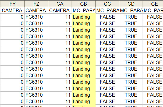

I looked in the Verbose CSV file to find the Failsafe Action setting.
It's in column GB of this spreadsheet: http://www.phantomhelp.com/LogViewe...htRecord_2020-01-28_[13-43-36]csv-verbose.zip
The full column heading is: MC_PARAM.failSafeAction
But because that's pretty complicated, here's a snapshot from it with the relevant part highlighted:
Reactions: RodPad
Ok, when I look at the logs you downloaded I do not see those columns, I will have to look into it deeper to locate that information. Thanks

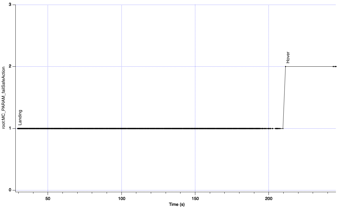

The failsafe action was actually "Hover". That explains why it did not RTH, although not the cause of the loss of connection.
At the end of the flight the sticks were centered. Since there were no wind issues the aircraft should have hovered in place until low battery caused it to land. I'd agree that it should have landed very close to the last recorded location:

Where are you seeing that?
Why does MC_PARAM.failSafeAction show Landing?
After the signal was lost and then reacquired. I've found that sometimes the reported action is not accurate until after it has been implemented.
