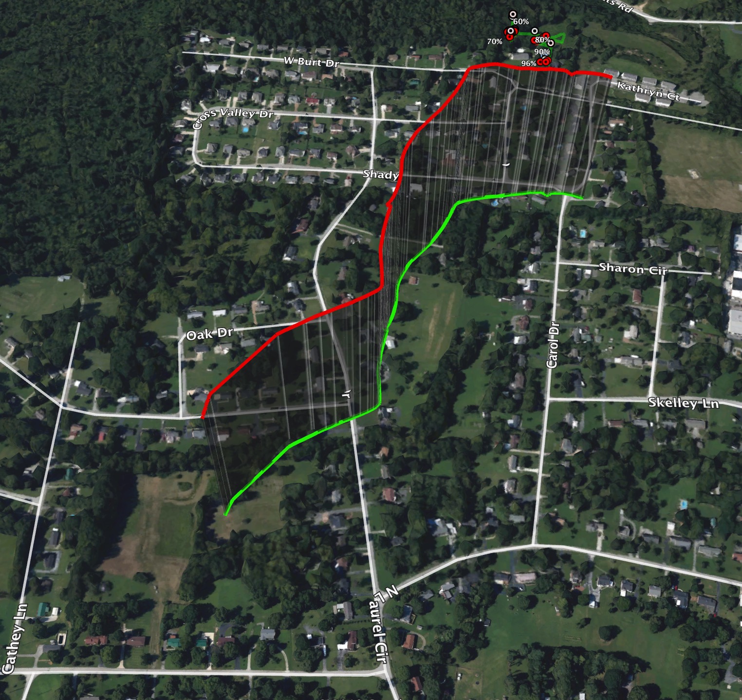

Those are kinda scary velocities - I don't believe them either. I did some calcs using the GPS coords at time 582.501 secs and at time 585.754 secs which yielded a velocity of 10 mph, heading 201°. Seems like another poster speculated the wind was 10 mph, although at a SE heading.:)
We don't know the scale of the GPS DOP signals except to say they aren't the "standard" scale. But, GPS(0):pDOP and GPS(0):hDOP both have relatively low values. (Compared to the first part of this flight and other flights I've seen).The numSats is 16.
So to answer your question I'm leaning towards the GPS coords data are probably OK.. Those velocities do give one pause though.
OK - working directly from the last 5 seconds of GPS coordinates I get basically the same 10.4 mph @ 200°. I think I posted the wind calculation from AirData, which was around 10 mph out of the NNW, but I'm not sure how much we can trust the log data that it was based on, so if it was drifting on a course of 200° that's probably not inconsistent.

Seems the problem was intermittent. There are intervals where the data is clearly wrong. But, when it was working the data was accurate as it doesn't show any randomness. I still think it's downwind of the tack location on that geoImage. That is, if the kid doesn't have it.

Agreed. It's unfortunate that we don't have any idea of the status of the uplink when the downlink failed.
So I should continue Southwest? About 200°? That is about where that field is on the Tack location from where I took off
That was the last recorded track, so yes. If it lost uplink at the same time and was still in ATTI mode then it will have auto landed. From 80 m up and descending at 2.5 m/s and a 5 m/s drift it might have traveled another 160 m.

This shows the GPS data from the flight record.

That his last known coordinates correct? It looks like it still pretty high at that point but starting to come down so maybe we will give it one more shot!
As @BudWalker pointed out, those later GPS coordinates appear to be quite credible.
@Kissthesky This and the last GPS coords puts the P4P about here.
