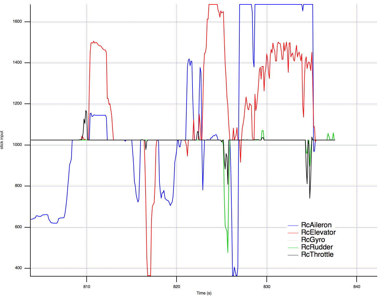

There is some strange stuff going on in the log file. The PhantomHelp viewer shows the aircraft in ATTI for the entire flight after takeoff, but the AirData equivalent shows it going in and out of GPS mode several times, complete with warning messages. However, the AirData log also shows zero satellites for the entire flight and no lat/long recorded, even when it shows GPS mode. The PhantomHelp log file shows up to 7 satellites at times, but also no lat/long.
That said, it looks to me from the stick inputs and inertial velocity data that you became confused at the end and actually applied the opposite stick inputs than you intended and simply flew it into the cliff. The graph below shows the final few seconds before impact at 833.1 s, and both elevator and aileron were accelerating, not decelerating, the aircraft. As a check on the flight behavior, the second graph shows the same data for the entire flight, from which it is clear that the aileron and elevator behavior were consistent through the flight. Does that seem like a possibility?

Yes - the yaw/compass heading data are good. It did not rotate and was reacting correctly to rudder input right up until it crashed. It was on a heading of approximately 72° until about 10 seconds before the crash, when you rotated it counterclockwise to a heading of approximately 27°, which it held until it crashed.
In terms of speed, it was travelling at just under 80 mph (36 m/s) at impact according to its inertial sensors, which it can integrate with respect to time to get velocity. But it was in ATTI mode and had no absolute position data, and hence no absolute speed data (i.e. instantaneous differentiated position). I don't think the FC is really able to control speed at all in ATTI mode - it is only holding alitude and attitude.
