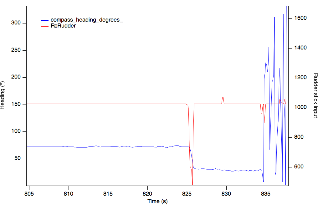

Yes - the yaw/compass heading data are good. It did not rotate and was reacting correctly to rudder input right up until it crashed. It was on a heading of approximately 72° until about 10 seconds before the crash, when you rotated it counterclockwise to a heading of approximately 27°, which it held until it crashed.

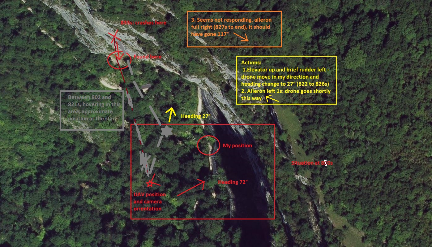

A little bit more context below:
In the red window, the situation when the last picture was taken, at around 802s. This picture is below.
Then in grey some short moves of the drone in the area between 802 and 821s.
In yellow, the last actions.
In orange, the attempt to bring the drone back.
I can't see how, at any moment, with a heading at 27° and pushing the aileron full right, I could have crashed the drone like it did. Absolutely no wind at the moment.

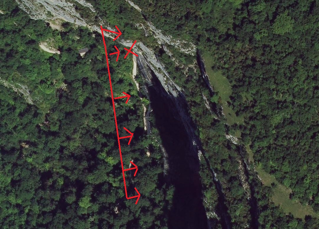

When I said the heading was 27°, I was referring to the direction that the aircraft was pointing. Its track (direction of travel) was reporting very different, 121° just before impact. So it was facing NNE, and traveling ESE (i.e. sideways to the right). Right aileron would be accelerating it.
More worryingly, the log data do not seem to agree well at all with your aerial map. Integrating the inertial velocity data with respect to time to get position relative to takeoff point, we get the following position trace:
That doesn't seem consistent with your map at all, so I'm not sure what to conclude. I cannot see any inconsistencies in the log file data itself, unless I'm missing something that should be obvious. I guess I'll try the same exercise with a known good flight log file to compare inertially derived position with GPS.

Well, that's weird. At first I thought you might have inverted X and Y coordinates, but it doesn't seem to fit either.
I'm quite confident that the drone crashed going sideways (thus pulling right to compensate), so it seems logical to get something like 90° between track and heading.
My flight path should look like that, the cross is where I took off (and never landed...):
My flight path should look like that, the cross is where I took off (and never landed...):View attachment 86679
Yes - I spent some time look at the coordinate scheme, but that appears to be correct. Did you have the drone in sight for the entire flight, or enough of the flight to be confident where it was?
In terms of the sideways crash that seems consistent, but presumably you thought it was flying to the left if you applied right aileron to try to stop it. The recorded motion and pitch data seem to indicate clearly that it was flying to the right.

At the very end of the flight there was some compass anomaly. But, it was very small and didn't have any significant effect. The magnetometers were making it look like there was CCW rotation. But, totalGyroZ (computed by integrating and summing gyroZ) didn't show any rotation. This might have been a problem if the flight hadn't been stopped short by the impact.
The velocity and Yaw data show the heading was roughly 36 degrees and the direction of travel 128 degrees. Also, full right rudder was being applied. I believe this is consistent with @sar104 's analysis. BTW, in this flight the Yaw and velocity values will be magnetic, not true. This is because declination is computed from the GPS data which wasn't available.

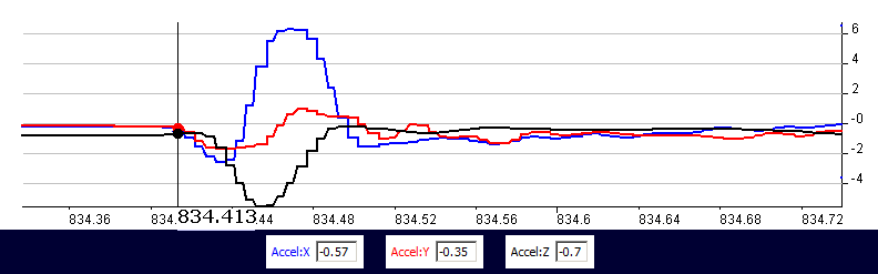

The accelerometer data is confusing and doesn't present a clear picture of the impact. At least I find it confusing. I always have to remember what positive and negative accelerations mean in terms of an impact. Initially, there is relatively small negative X and Y acceleration indicating the impact was in the left rear quadrant. This is followed by a much higher positive X acceleration indicating impact in the front. I've attached a .zip containing a .csv for the last 4 secs and at the highest sampling rate possible. Maybe someone can make some sense of this.

Interesting discrepancy between the DAT file yaw and the log file yaw data in the seconds leading up to impact. Is that variation normal?
Thanks for your participation in the discussion. Heading of 36°, and direction of travel of 128° are not compatible with an impact on the left side of the drone, and with how things happened. Those values are can't be correct, and there is definitely something wrong here...
But I still don't get if and how this anomaly may have disrupted the attitude of the drone... I mean, trivially, any problem there might be regarding the referential, the left, right, front, back sides of the drone remain the same, and when using the controls, I don't see why the referential would interfere there? Except for yaw...
If this asumption is true, do you agree this means:
- either this anomaly may, or may not have lead to the crash, but anyway I didn't have control at all on the drone anymore and it decided itself what to do. Meh...
- or the drone was effectively accelerating and hit rightwards, and then there must have been a 180° turn at some time. If so, there should be a record of that command between the moment when the last picture was taken and the time it crashed. If there's no such record, it means at some time I lost control of the drone too...
In that case there is a good chance the compass anomaly was the reason it lost its orientation. I can't confirm that this U-turn has occurred, it can be really fast. There is something that could confirm this scenario: I took pictures of the drone before sending it to repair. It was badly damaged (TBH, I didn't want to look at this mess too much, it was quite depressing), but it seems the right arms have been more damaged:
Are you affirmative about the left side impacting first?
