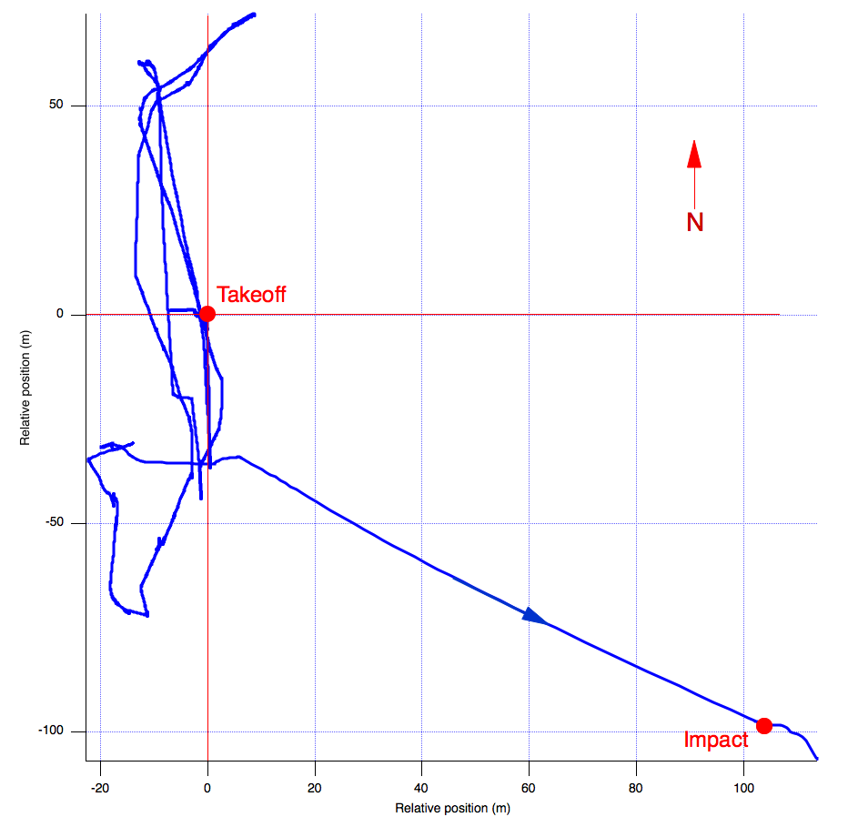

More worryingly, the log data do not seem to agree well at all with your aerial map. Integrating the inertial velocity data with respect to time to get position relative to takeoff point, we get the following position trace:
That doesn't seem consistent with your map at all, so I'm not sure what to conclude. I cannot see any inconsistencies in the log file data itself, unless I'm missing something that should be obvious. I guess I'll try the same exercise with a known good flight log file to compare inertially derived position with GPS.

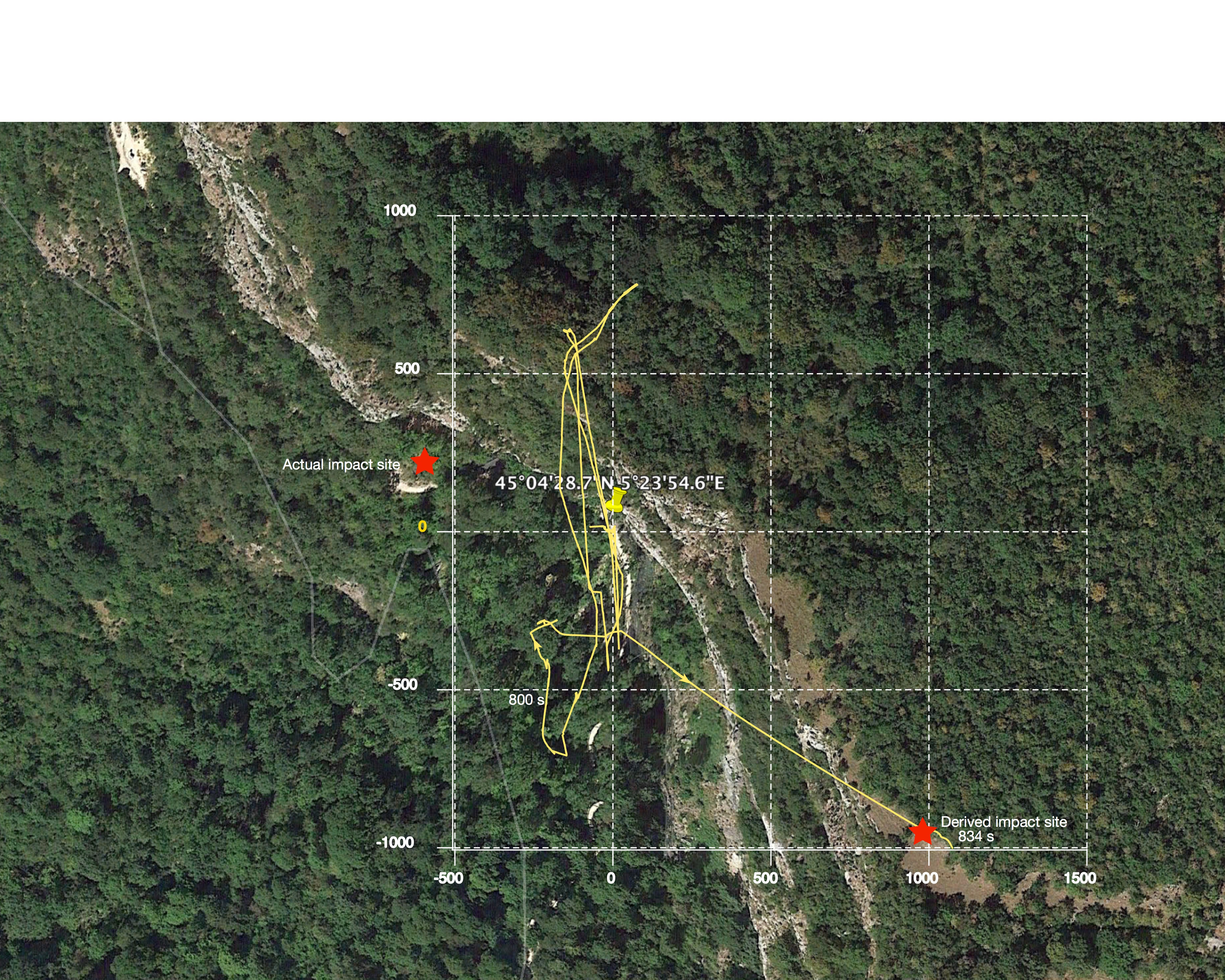

Overlaying the integrated and scaled X, Y velocity data, i.e. position, on the aerial map gives the following:
Note that its position at 800 s (well into the flight) is approximately where you indicated previously. That could be coincidence, but it does suggest that the inertial data are good. But within 30 seconds, those data, consistent with the yaw and pitch data, show it heading fast to the SE.
The aircraft was unambiguously flying to its right, based on pitch and roll data. Right aileron was accelerating it further. The remaining question is how was it moving NW when the data all indicate SE?

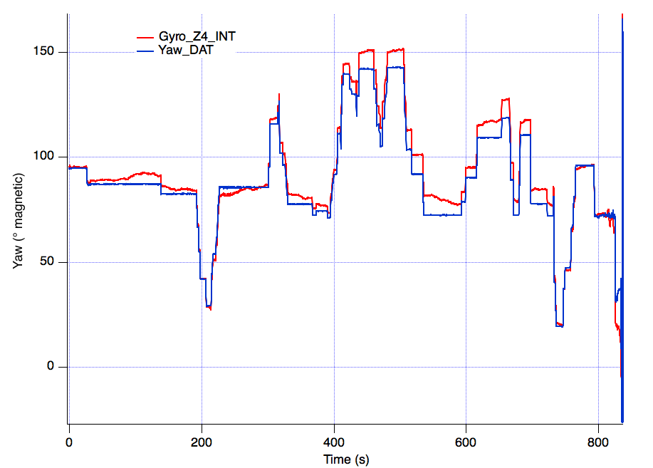

To check whether the compass could have been completely wrong I took the gyro Z data from the DAT file (rotation rate in degrees per second) and integrated it with respect to time over the entire flight, with an intial value of 94.5°. If the gyro is accurate, the result is the instantaneous yaw angle as a function of time. Comparing that with the recorded yaw angle from the compass yields the result below.
The agreement between inertially derived rotation and compass heading is quite good, suggesting that the compass and Z gyro are both working fine. Looking at the last 30 s of the flight:

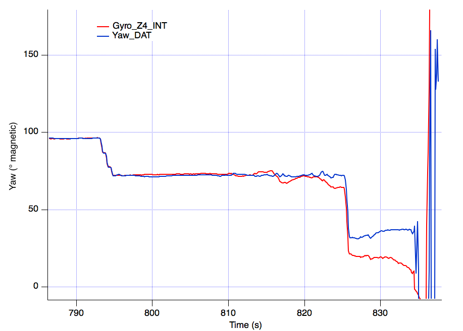

Still pretty good agreement right up to impact at 834 s. By both measurements, the aircraft was facing NE, and therefore flying SE, and that is completely consistent with the integrated accelerometer data. No room for the possibility that it was flying NW, which would have required the data to be 180° out.
I cannot find a credible explanation for the discrepancy between the aircraft flight path and impact location that you described with any of the recorded data in either the log or the DAT files, which basically agree with each other. I'm afraid that I'm completely out of ideas.

Here is what I had in mind (and what the pictures show) - red first, then blue, then purple:
I have to keep in mind that Google orthomozaic basemap may not be a true orthomozaic, and that some important correction could be applied to the picture. There is some kind of cave where the circled area is positionned, but I think the track is far too much north compared to my initial position.
The end of the track is pretty consistent though. It seems to me that it is not consistent anymore from the moment it starts moving east (where the yellow and red tracks cross).

Here is what I had in mind (and what the pictures show) - red first, then blue, then purple:View attachment 86716

In terms of the orientation of the aircraft at the end, there is one other slightly puzzling thing that I should mention that I omitted before. In the comparison of the magnetic yaw reading with the integrated Gyro:Z data, there was a clearly apparent gyro normalization error - at least that's what I assumed it to be. The DAT file itself contains the integrated raw Gyro:Z data as "totalGyroZ", but those data are appear to me to be wrong, as seen below.

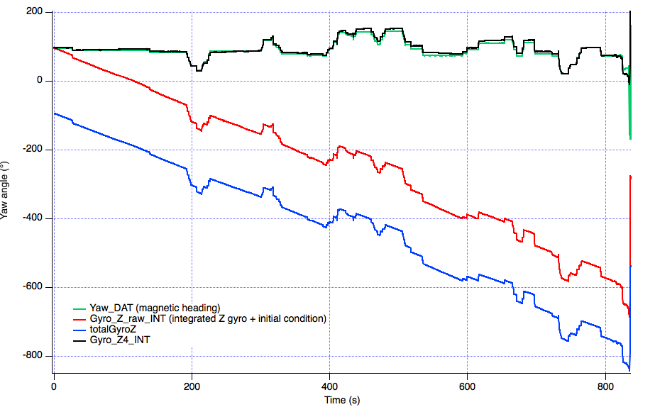

Two things bother me about totalGyroZ (blue). Firstly, inspection reveals immediately that just like in my direct integration of Gyro:Z (red), there is an obvious superimposed constant negative drift compared to the much more believable magnetic yaw data (green), which must represent a baseline error in Gyro:Z. My other concern is why totalGyroZ doesn't start either at zero or at 94.5° which is the initial recorded heading. Instead it starts at -95°, which is 180° off the original heading.
I normalized the Gyro:Z data by doing a linear fit to the integrated data and subtracting the slope from Gyro:Z, then integrating wrt time and finally adding the initial condition (94.5°) to give the black trace which, as I mentioned before, is very similiar to the magnetic data.
But, totalGyroZ does start at 0. It just isn't reset to 0.0 when the flight starts. It's a computation done by DatCon by integrating and then summing gyroZ. Technically speaking the gyroZ doesn't drift; it has an error that becomes a drift when integrated. Here that drift is about .80 degrees/sec. That's a bit on the high side. I don't see how this could affect the incident though. Yaw is being corrected by the compass although at a low gain.
totalGyroZ is useful in analyzing incidents where the Yaw value is suspect since it's independent of the calculations that the FC performs to calculate Yaw.
magYaw is also computed by DatCon from magnetometer data and then corrected for roll and pitch. It's also useful n analyzing incidents where the Yaw value is suspect.
