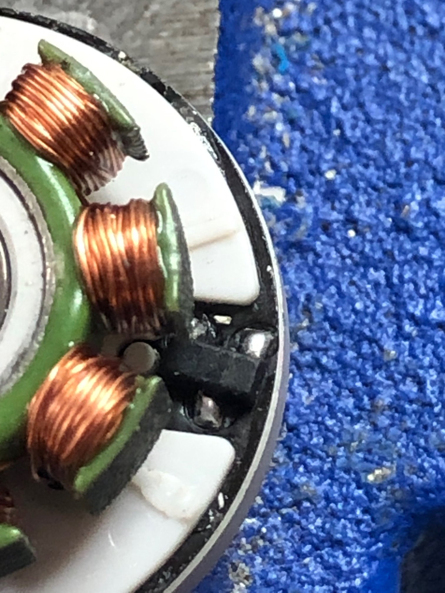

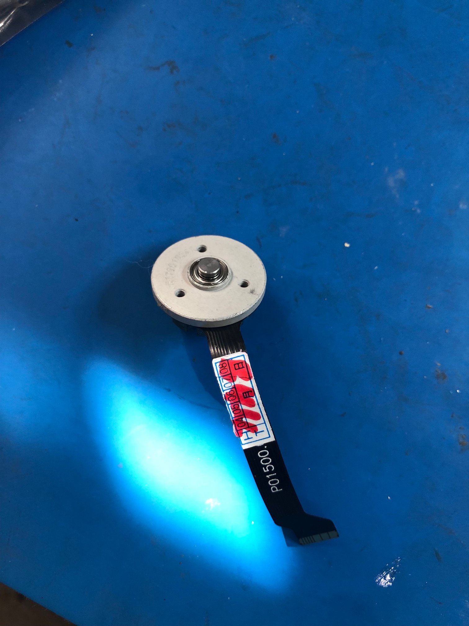

My guess is that the yaw motor hall sensors got damaged. Hard to say for sure but they get damaged in almost every crash. You would have to take the yaw motor out and inspect the hall sensors with a magnifying glass.
Reactions: Starz
yes. this is what it looks like. Any scratches and it will act weird.
