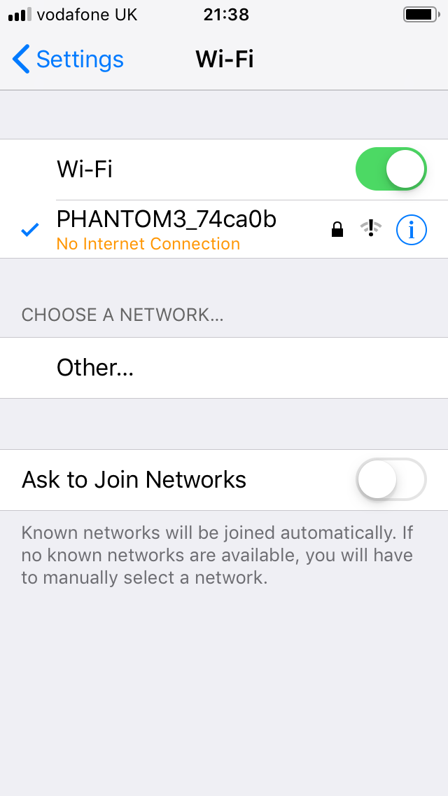

Hi Oso, yes, strangely the other two wifi options I have for my phone do work - but then here's what it's telling me for the Phantom . So I am assuming that if I could re-enter the password, (it was set up on another network, but that shouldn't make the difference - should it?) then it might re-set itself. Here 's a screen shot .
Thanks

To me, the screen shot you posted shows that your phone is already connected to your remote controller's WiFi network.

Thanks Oso, but below the Wifi it says "No internet connection" and the bars are crossed too. Surely that not correct??

I already explained to you earlier in post #4 above that it is normal to see "No Internet Connection" since your P3 does not provide a connection to the internet . Perhaps you missed it in my post from yesterday afternoon (US time).
Perhaps read through these search results to see the same as I've explained. :)
