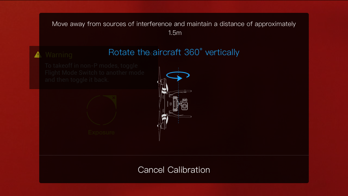

Good point! I did think of it earlier and thought Id tried at least to re-calibrate. Today when I charged up, tried again, the lights on the drone changed to green! But stationary, as were the red lights. I took it out to re-calibrate but couldn't get any further as this kept coming up on the phone. I'd tried jiggling S1 before and after that.
I turned off for fifteen minutes, tried again and we're back to the old flashing yellow lights again....

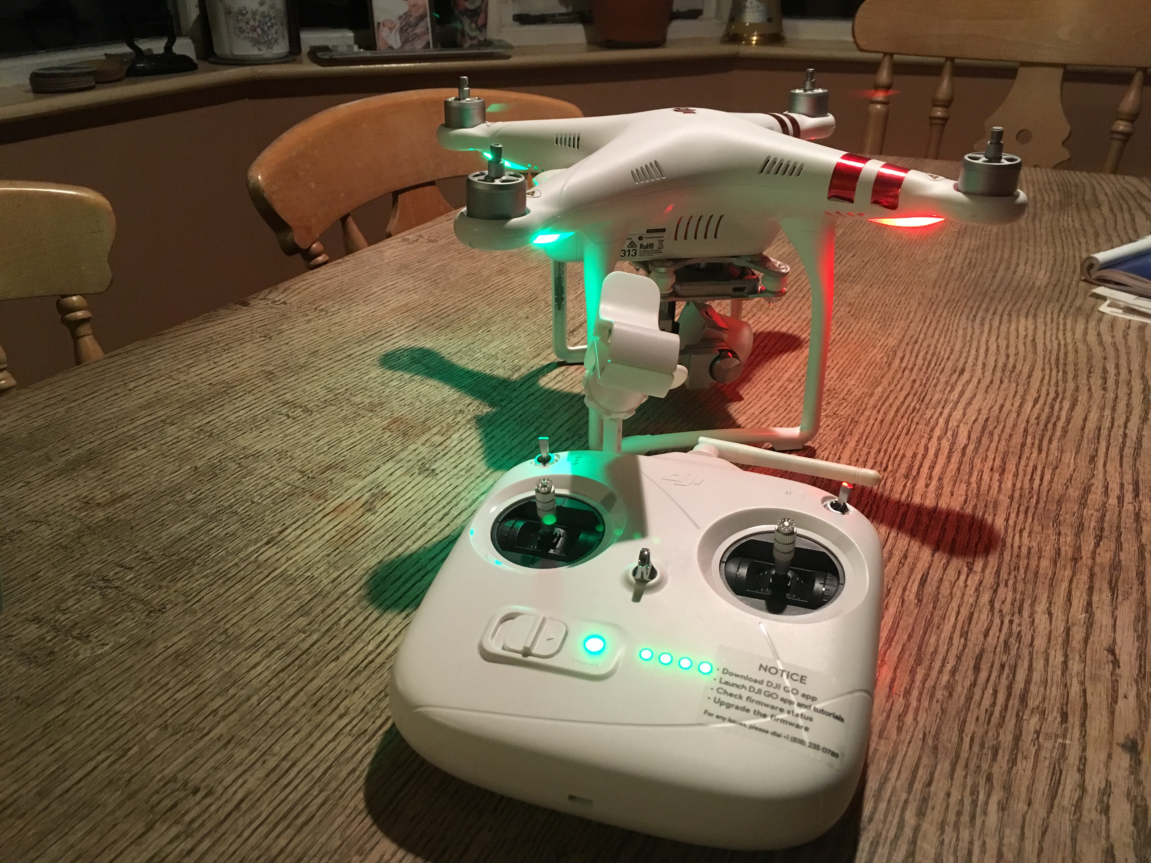

If you get it back into the situation as pictured with green lights coming on, on back two legs, put it on a wooden table without the props, and check to see if the controller is really in control of the drone. Check to see if you can start the motors , by pulling both joysticks inward and down simultaneously and hold them for no more than 2 seconds. If the motors start up, let go of the joysticks. Its not going anywhere as long as you removed the props. Now with the motors running, pull the throttle(left Stick) all the way back and hold it there. The motors should shortly shut down. It should actually lock in place. Unlock it once the motors have stopped.
Now consider the status lights on the back two arms of the drone.
The status lights on the back two arms of the drone are trying to tell you something.
One, the drone is in a different part of the world now.
Two, you have got the drone inside, and it probably cant see any GPS satellites. It is not sitting level, and its probably too close to metal object(springs in the chair perhaps)
Three, when you take it outside, It has to go thru a warm up period for the IMU
Four, It probably needs the IMU calibrated, and then a GPS Calibration and then a compass calibration.

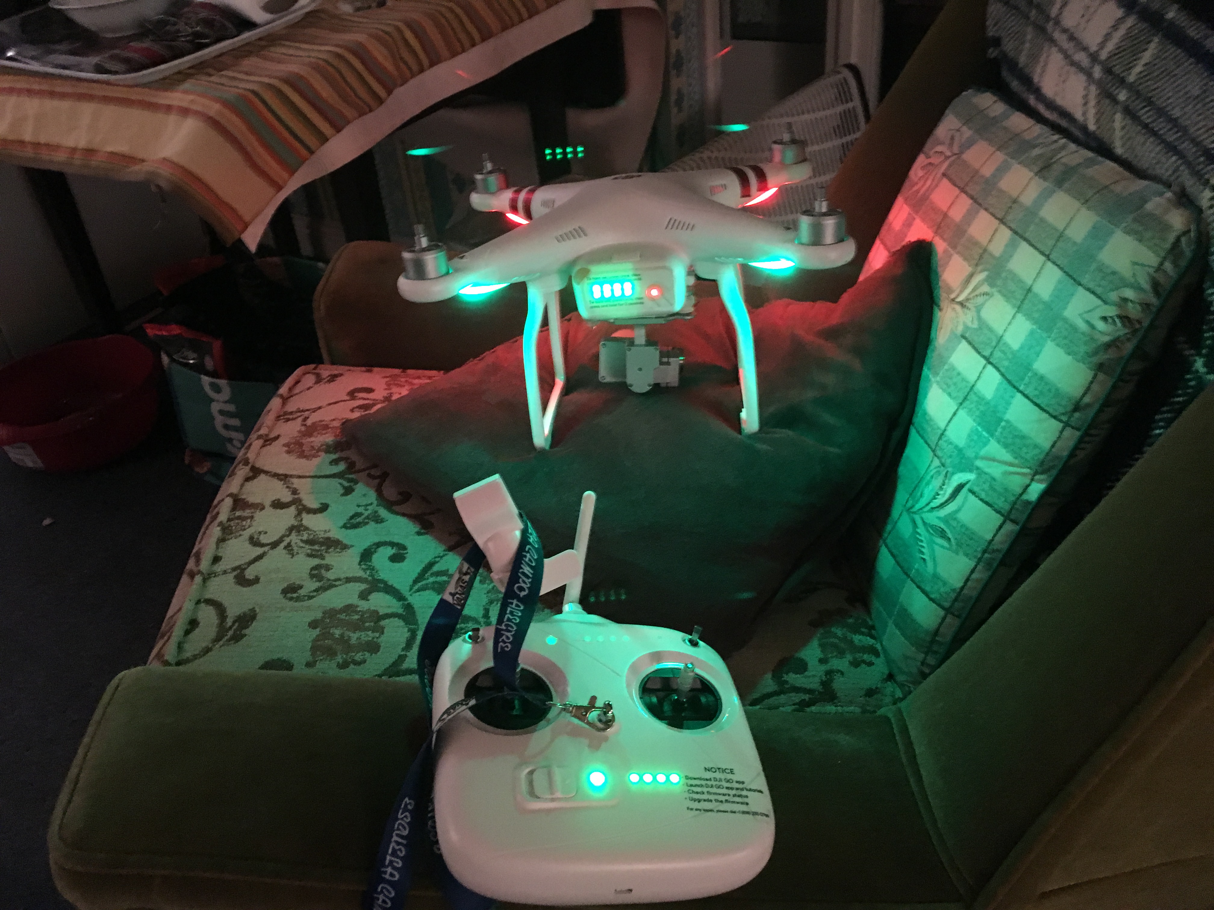

Many thanks again. Lots of detail and I followed what you've recommended. The drone is basically new, so the battery is in great condition. I did calibrate the IMU - the DJI told me that it had reached 100% but didn't give me an option after that - so I assumed that it had worked. I repeated it, then calibrated the compass. Got non-flashing green lights but the link button was still on red, no movement from the motors. The link light and the Power light on the controller turn red after a while, as you'd mentioned. Still no go...
