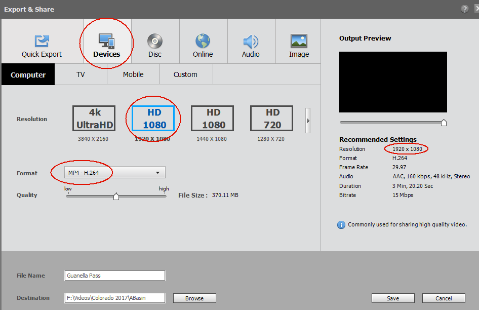

Sure, that system should work great for 1080 renders and editing. I've used Elements before and it works good, easy to use. However, it is a little querky on the render. When you render the video to export, go to "Devices" tab and change the resolution to 1080. I think that's your issue, because you have to set it to 1080 every time you export the edited video. I haven't been able to solve that problem, I don't know why it doesn't remember that I always want 1080. Look at that and see if that helps.

When you export from Elements 15, here's the settings below you want to have before clicking "Save". Just click on the "HD 1080" (turns to blue box) and you should be good. Also, make sure you select your destination folder with the "Browse" button to make sure you know where to find the file after it's done rendering your video.
Thank you, thank you, thank you!
