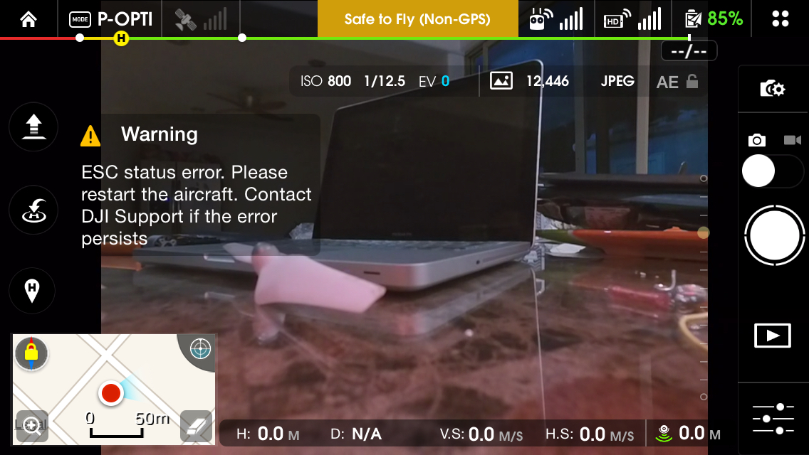

ESC Error After Prop Guard Install, HELP!

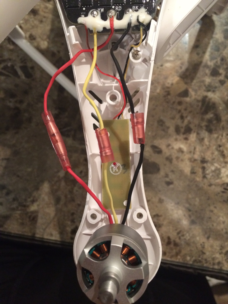

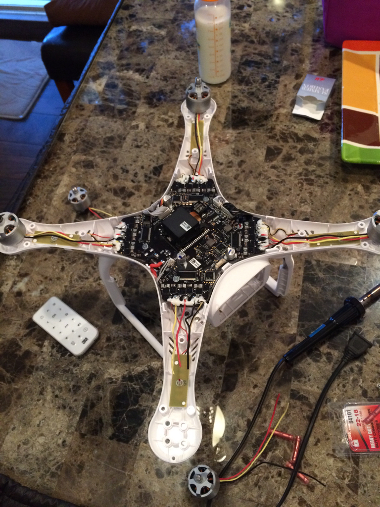

I'd use crimp splices in the field to get flying again but wouln't not consider that a repair.
There's a soldering iron in the photo so I assume you can solder???
If you're afraid to go at the PCB at least solder those connections and use your preferred insulation method.
If he is a good solderer only. I soldered mine and it was a chore. Had to sand the wires on the motor where I stripped them to get a good solder joint. There is a coating on those wires that make them difficult to solder, even with a good hot iron-- 850 F , and flux. Got it done but it wasn't easy with this wire. I would't recommend it for someone with limited soldering experience or good soldering tools and material.
bobmyers. soldaste wire cable ?? ESC did not have the status mistake ?? excellent today will try to replace solder connectors

I'm in a world of hurt. I just used DJI's old prop guards and found out after the fact the screws were too long. Will DJI still cover this if its a motor or ESC issue? I just submitted a ticket and probably won't hear anything back until Mon. I plan on calling in as well on Mon. Has anyone had experience with this?
