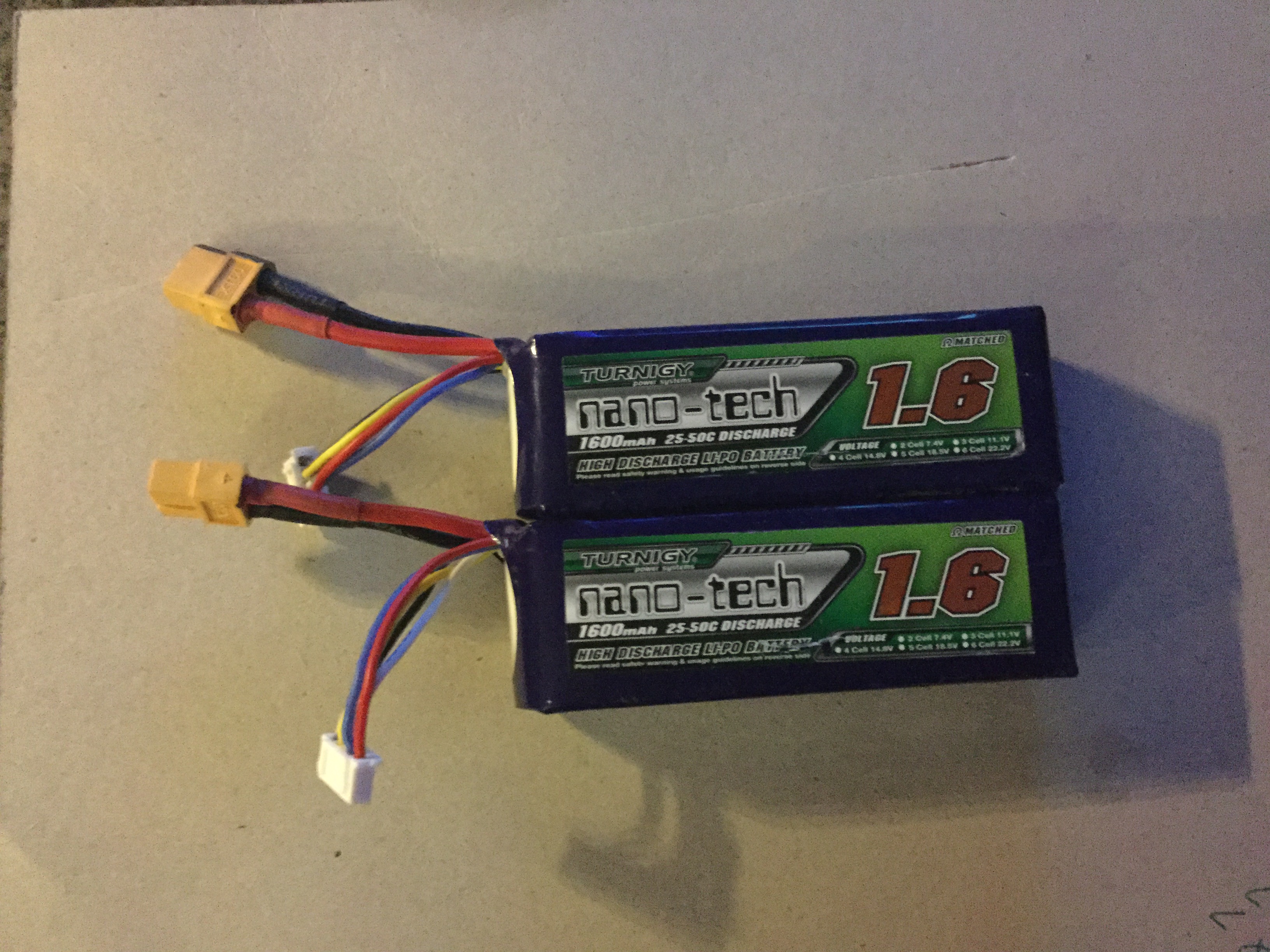

I knew you weren't, but, as I see it, that's the only way your method would add flying time over the parallel method, which requires all three batteries throughout the flight. First of all, I'm only getting 15 minutes out of the stock battery on original motors and original shell. I get 8 minutes more by adding the two 1600 externals. I only get 2-3 minutes more with the 2800's. Running the batteries in series cannot prolong the flying time over parallel because the weight of the extra batteries isn't changing inyour alternative. You still have to lift that extra weight throughout the flight, no matter whether using them in parallel, or in series, one after the other. The switch won't change that. Also, none of the externals are powerful enough to fly the bird alone. The internal battery is 4480 mAh. Even the 2800's are only 62% of the internal mAh, but they also already add 247g each to the payload, so you can't go bigger.

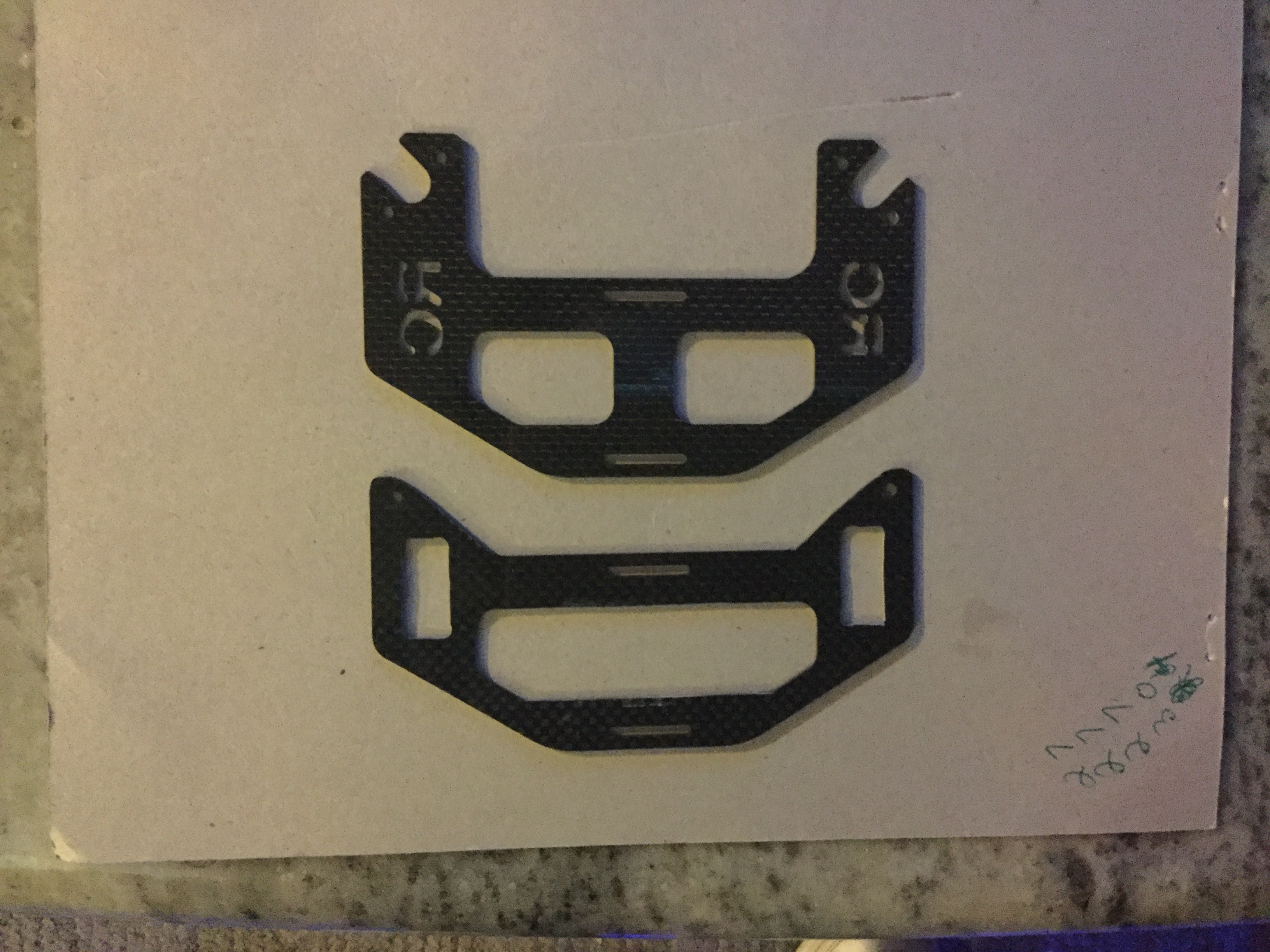

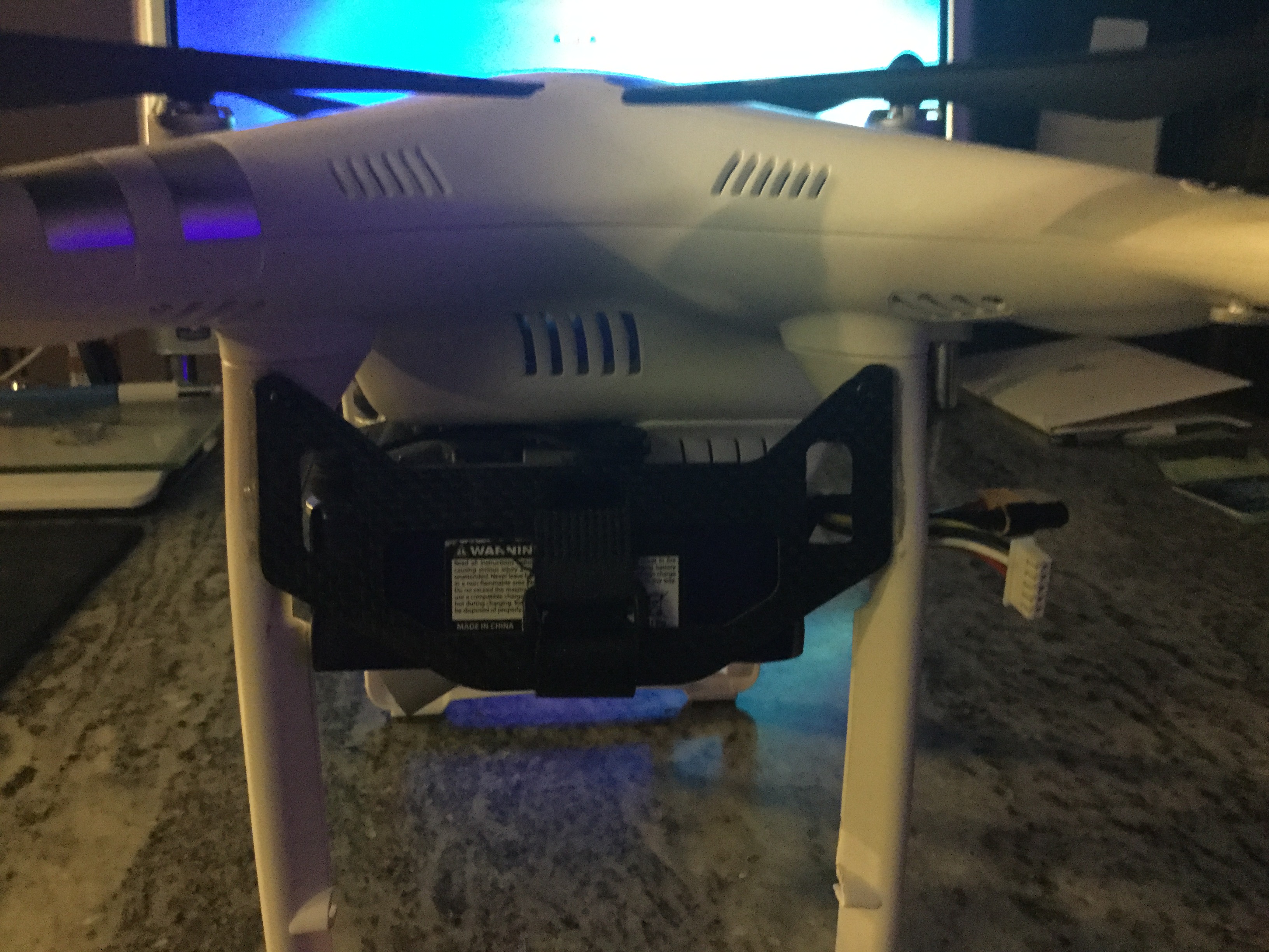

Battery mod part 6.6 haha anyways cut and shaved off 6 grams on battery tray and 6 grams off batteries cut off about 3/4 cm.12grams every gram counts!!!!image.jpegimage.jpeg so could mount the trays like this fits in case tucks battery under quad away from prop wash....battery tray from hobbyking or ebay
Whats your goal with these mods , silver? Have you come close to them?
Well longest flight times and long distance record is one goal,and just to share some ideas..the closer I get to spring time the closer I get to my goal mmmmmmmwwwaahaha.
