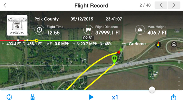

I just flew a flight and had a top speed of 38mph. I'm on the newest firmware.
I made it home pretty quick in RTH mode! Strange huh!
It was making good time so i left it in that mode all the way back. New firmware glitch???

I've noticed when I play back the flight on the app like that it seems to show a much faster speed than what was actual. I'm not saying that's what happened here but for me the app isn't very accurate with the speed on the flight path replay.

I know I wasn't going this fast during my flight but the app shows a much higher speed .
Yeah i agree its not always spot on. I was in rth mode its usually what 12mph.
It was probably a glitch .
