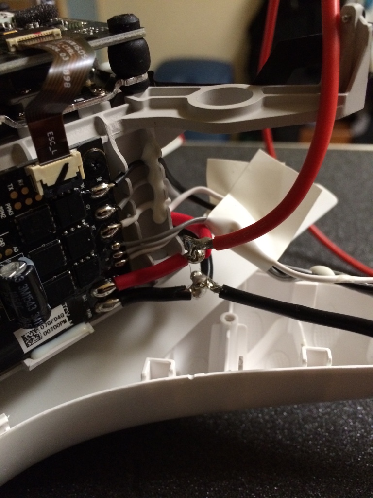

Yup I got tired of jerking around with the battery trying to charge. I was wasting too much time trying to get the battery to behave and it doesn't leave a warm fuzzy feeling before setting out to go 10mi out. I had nightmares of it shutting down a few thousand feet away.
Can the guys who have done the aircraft power mod confirm that these are the right power leads to solder on? Circled below (stole image from a pic Mohan posted some time back). Just need a second look before i solder :)
That's the spot!
On the lead wires your soldering to those just tin them up with a lot of solder on the end and then sit them right on top of that DJI glob, and melt it all together, don't get discouraged it takes a minute to melt that DJI stuff, don't breathe it who knows what they use over there

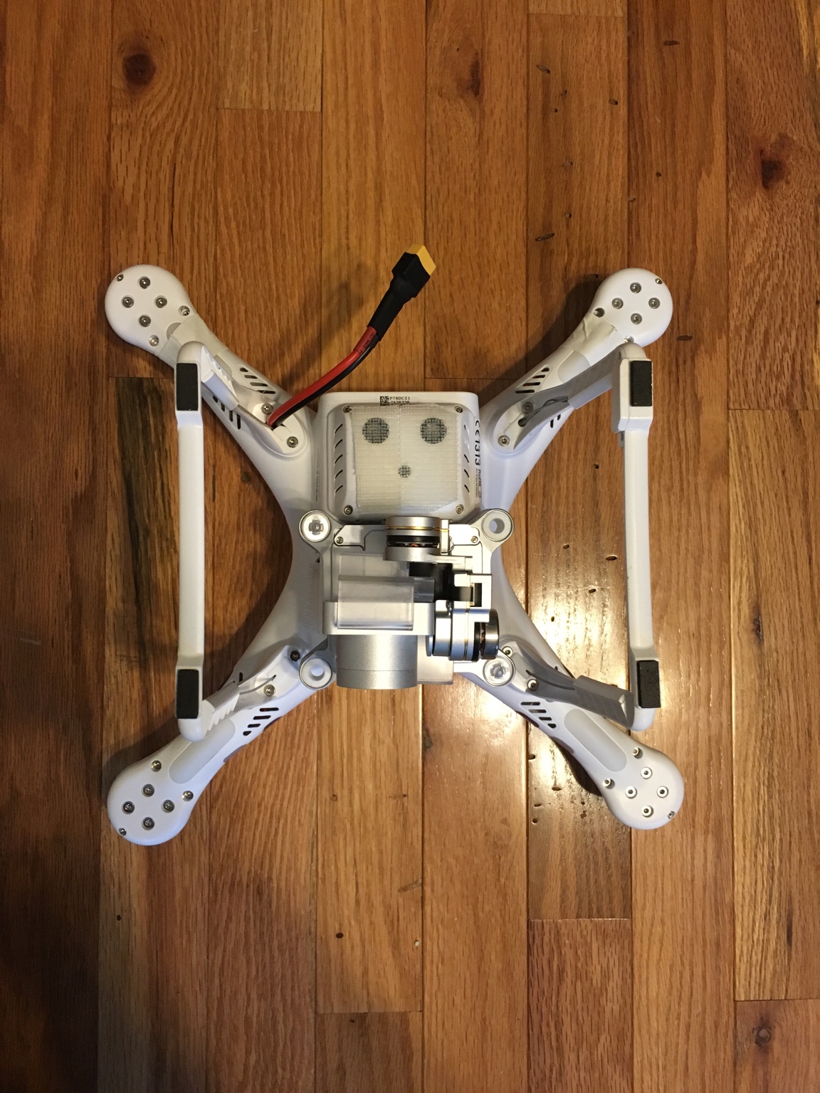

No I dont think they came loos, but something went wrong. And I think it has to do with tying in the wires like that. I wish I had not dune it.
I havent done the a/c mod on the p3's (I just did the battery since my P3's were under warranty)
But I have done many P2's in that same spot on its main board, and I've never had any issues.
But if someone's worried about it or not confident in it, they could always tie into the wire instead of messing with the board like I did with the P4
Just remove some of the rubber casing on the wire and solder directly to the wire, cover it with a little liquid tape

Can you expand a tad more maxwell? Why don't you recommend? You had the aircraft power mod done and had bad results? I followed the details on you losing your phantom (sorry!), i thought that was the battery you ran .. are you attributing that to power mod directly to the aircraft? I'd rather not do this, but screwing with the batteries is frustrating and i gotta switch out a motor either way, so figured while I'm under the hood might as well. Please share more! :)
I don't think there's no harm in modding the aircraft, if while soldering the leads on,
You pop the battery leads off the main board and then do not get them soldered back on properly, maybe there could be a harm there. And if you're worried about that and not confident that you can solder at that point, just strip some of the wire casing off of the axle battery wire lead and solder to that, then you don't have to mess with the DJI soldering point
Reactions: Digdat0

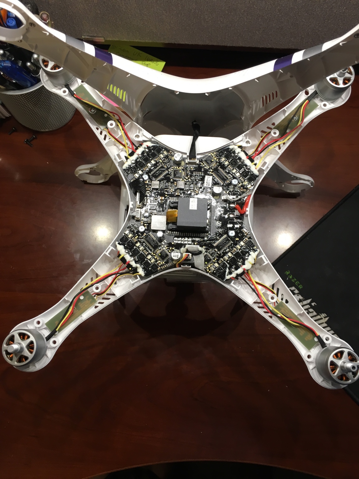

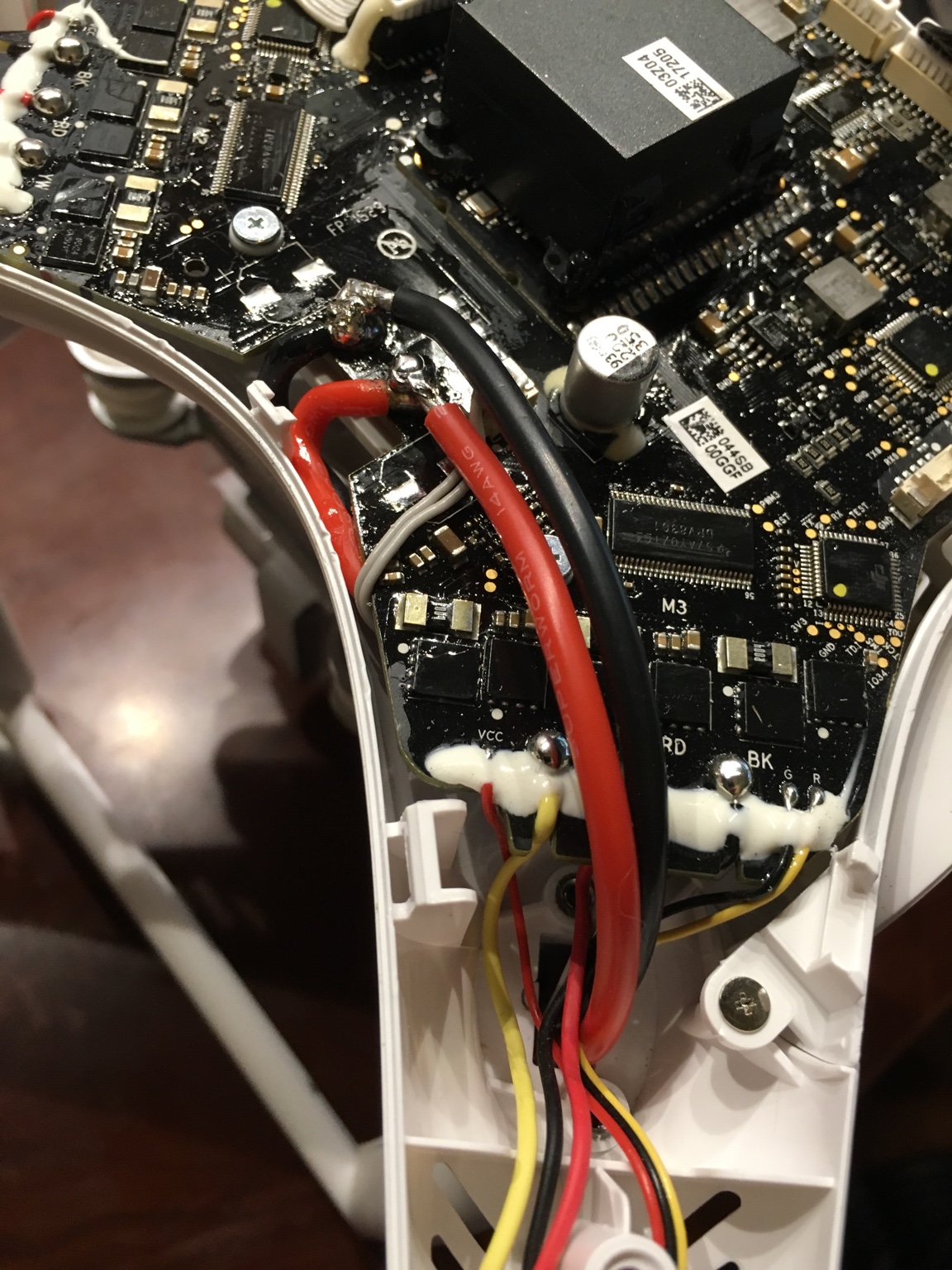

No issues soldering the main board. I have flown a bunch since doing all 3 of my birds. Many 40min flights on all of them. Just do clean soldering and you have nothing to worry about. I have been so comfortable with the bird side mod that I undid all of my battery mods.
The PIII is the easiest one you're going to do! On the P2V plus you have to take off the Wi-Fi module and then get a really flat soldering job so the Wi-Fi module sit back down properly. On the P4 you got to take apart what amounts to a small computer and then you don't have a lot of room to solder or fit wires, and then it's a pain in the *** to put it back together without smashing some antenna wires
No issues soldering the main board. I have flown a bunch since doing all 3 of my birds. Many 40min flights on all of them. Just do clean soldering and you have nothing to worry about. I have been so comfortable with the bird side mod that I undid all of my battery mods. View attachment 59933
