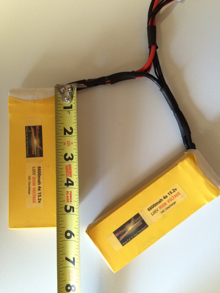

Just got my 6.6 split back from Tom at Midwest horizon.
I originally sent him my 6.6 MultiStar to split because it was just too heavy as a single battery all the way to the rear. So I hadnt anything to lose by having it split.
As a single battery you gave me 39 minutes on the p3S, I only got two flights out of it as a split and it only produced 30 minutes. Then it was way out of balance and wouldn't charge. Tom did a rework and concluded that it might have been a cold solder on one of the aluminum tabs. Those tabs are very fragile and for any of you have that done it, are almost impossible to solder to! He found a solder that was specifically for aluminum and reworked it. I'm hopeful that now maybe I can meet somewhere in the middle of 30 to 39. I'll let ya know.
As a single battery you gave me 39 minutes on the p3S, I only got two flights out of it as a split and it only produced 30 minutes. Then it was way out of balance and wouldn't charge. Tom did a rework and concluded that it might have been a cold solder on one of the aluminum tabs. Those tabs are very fragile and for any of you have that done it, are almost impossible to solder to! He found a solder that was specifically for aluminum and reworked it. I'm hopeful that now maybe I can meet somewhere in the middle of 30 to 39. I'll let you knowhttp://horizonfpvantennas.us/product/6600ah-4s-hi-voltage-power-mod-v3-6/
This is what I use https://www.amazon.com/Harris-500K-Al-Solder-Aluminum-Solder/dp/B001HWFM9Y. The flux that is included with this kit is no joke. If you hold your solder to the tab and don't "cut" it with the iron you will be left with your solder line welded to the tab :D
