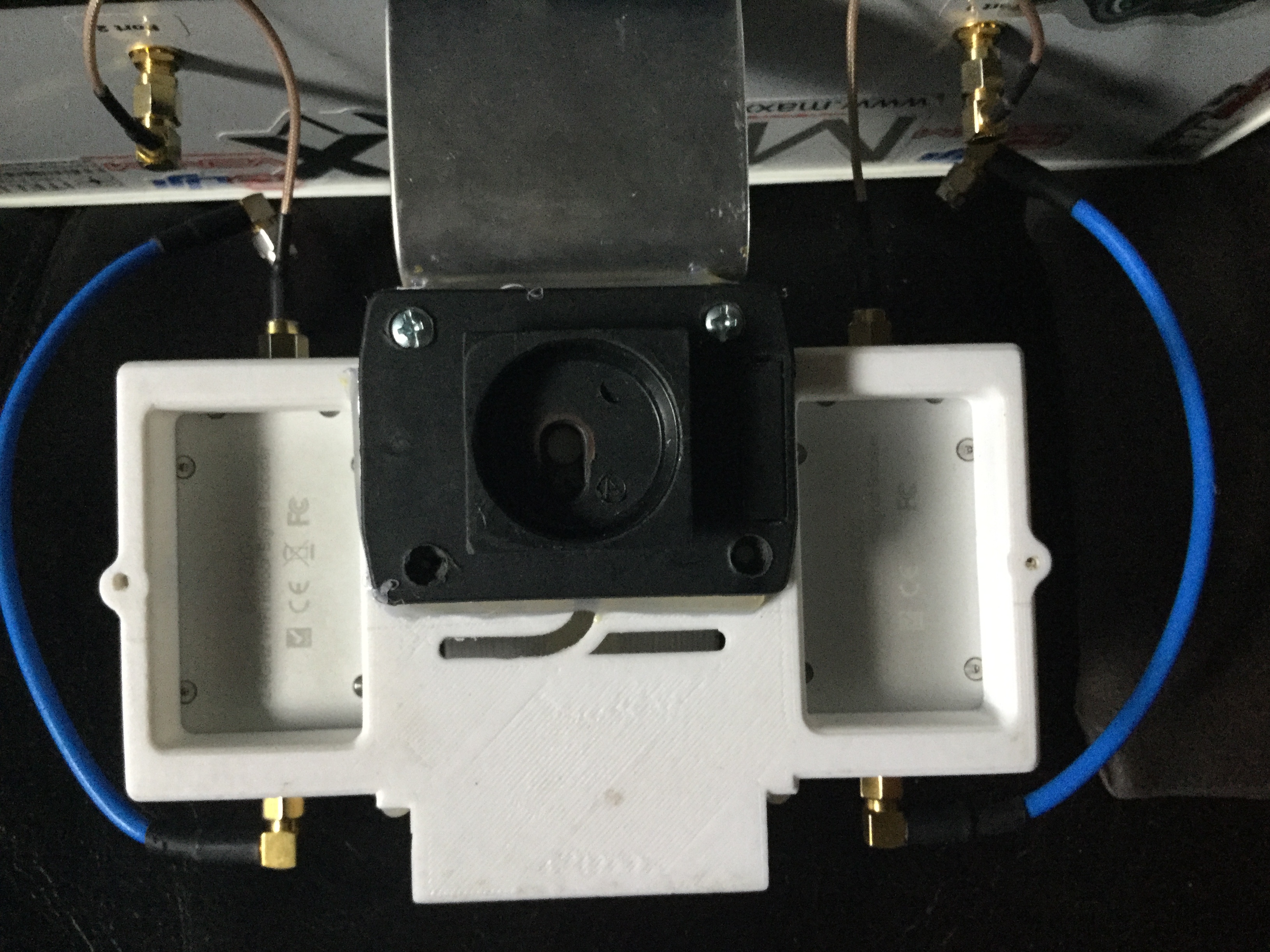

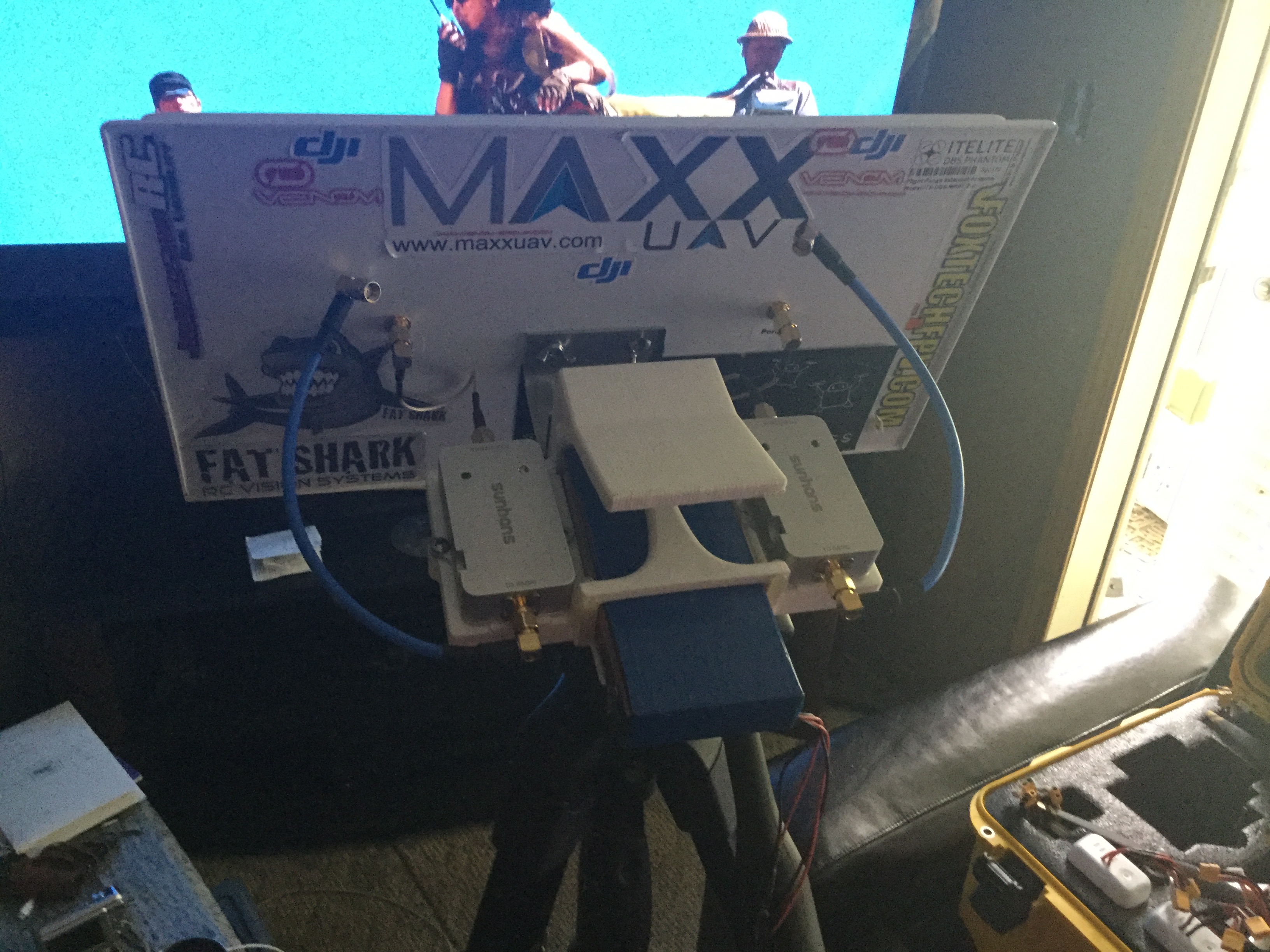

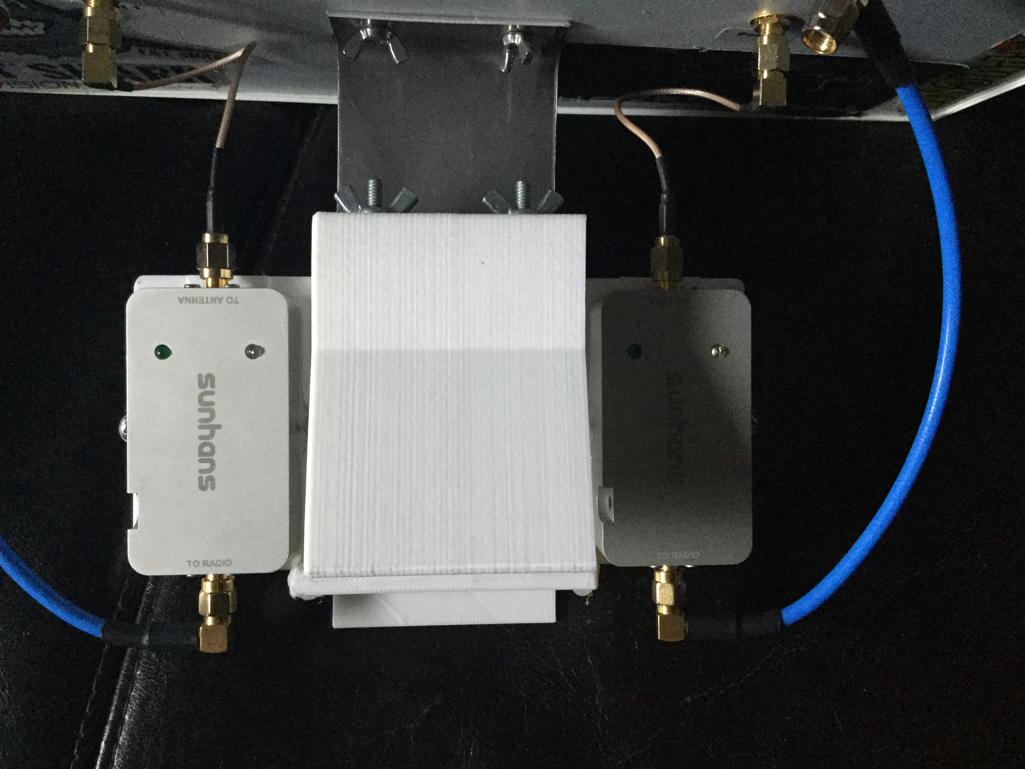

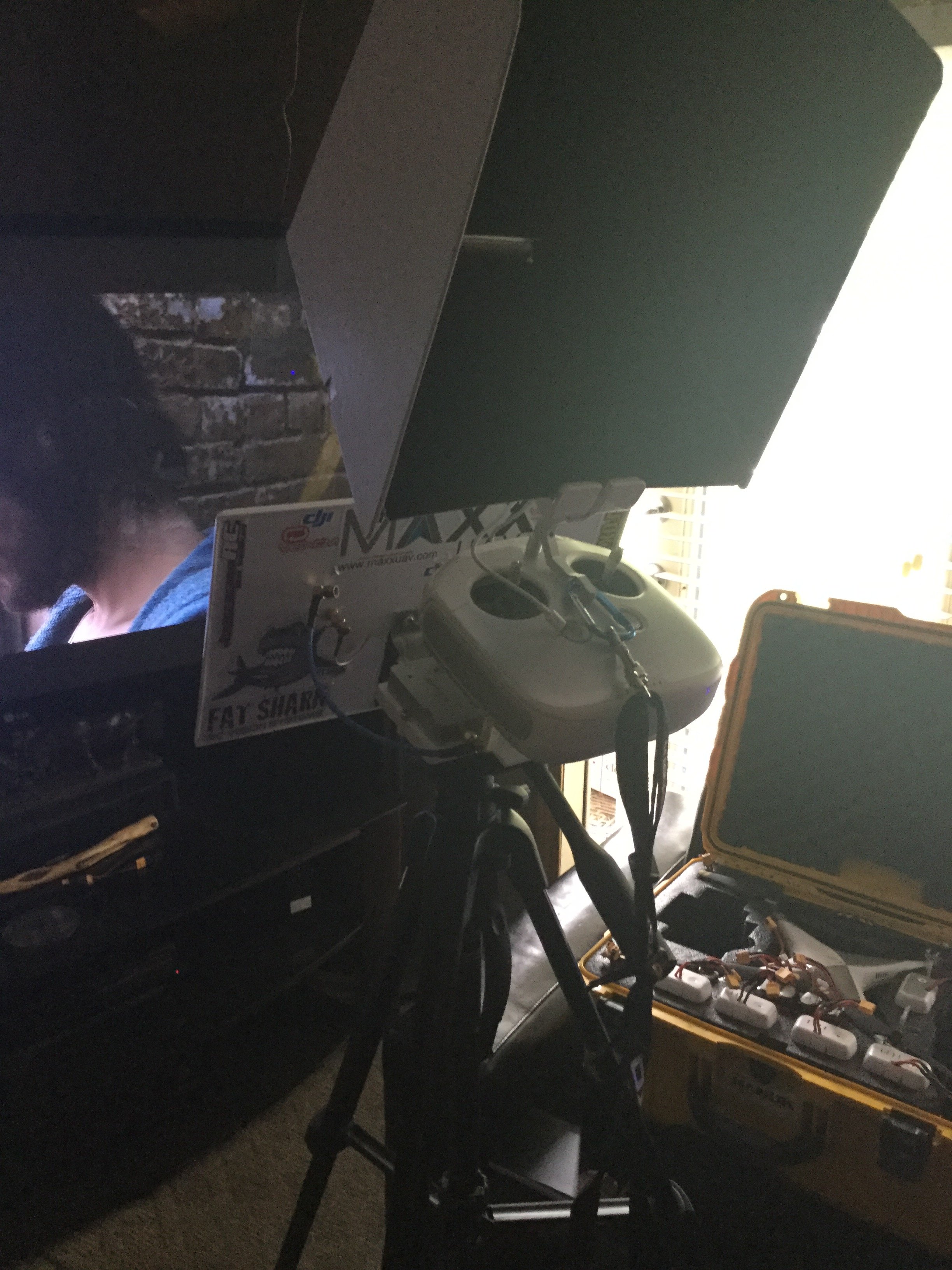

Got the amps today, here is how I mounted mine since I don't use tripod, I use a secraft tray and device holder.

Nice set up its what I like to see people sharing there mods pic says a thousand words!
