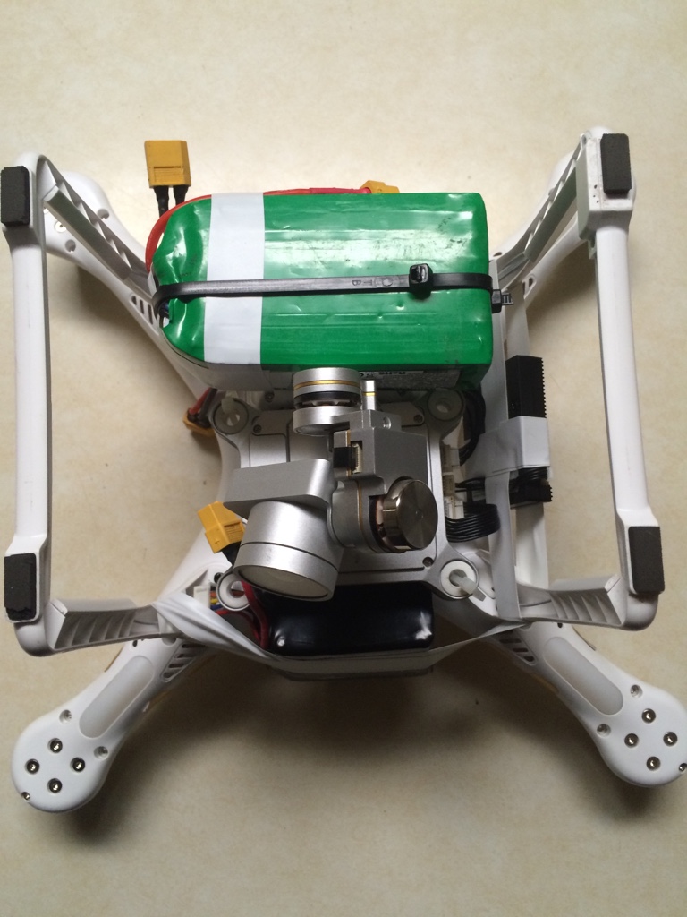

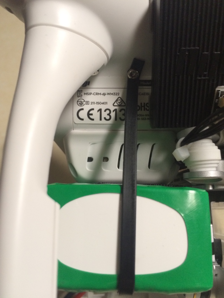

They are very tight to the bird, plus it fits in my case with no trimming!
I especially like how it uses BOTH screws of the landing gear......

They do, which is something I didnt like about the carbon fiber mounts. Also, the rectangle cutout between the screws is large enough for the white foam wire gasket to go back in.

Yeah me too, 5.2 MultiStar rules the roost! I'm just trying to find a little something add on it, since it only gives me 32 to 34 minutes! So far the 2.0 Maxamp strapped to the front of the bird is a nice balance that will probably give me
A 10 mile run on the right day
I still dont get why you're only getting that much. Your main batteries are good? I just ordered 2 more and this from B&H. I'm gonna rig that up so I can use my lipo charger to try and revive that dead battery.
Yeah just strap it under the VPS, turn GPS off in your app. Just plug it into one of them the other one can go unused. Wait until it says ready to fly GPS before you plug the MultiStar into your aircraft. If Dji battery starts blinking because the multiStar sometimes has more juice than the DJI battery you need to fire the engines up and hover as quick as possible and it'll stop blinking, if you don't do it soon enough the main battery will shut off, you have to start everything over

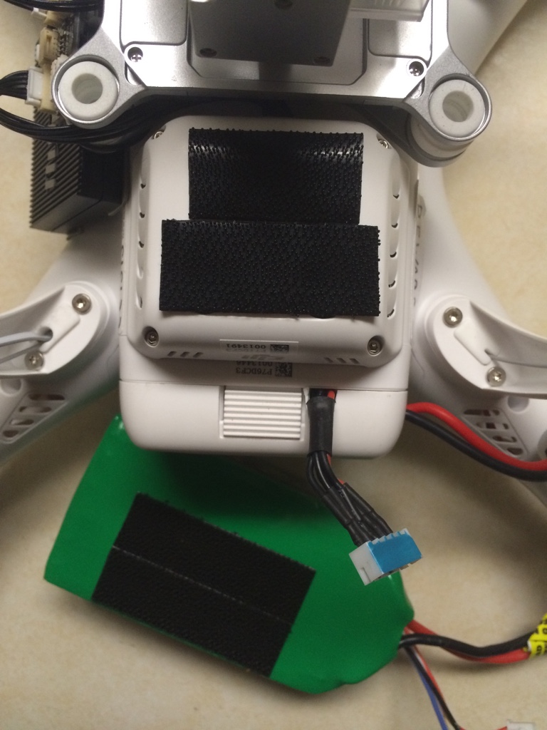

Ok!!! Please let me know how to attache the lipo to the VPS ???
That's the best battery I've tried out of many. The horizon 5.2 split is giving the guys down in Florida their best time, but that battery hasn't worked for most of us.those of us who've tried to 5.2 single battery have been getting amazing results out of it! The timer on the go app doesn't even start counting down from 25 minutes until 10 to 11 minutes into the flight
Use zip tie only? or Use dual lock also?
Most guys are using dual lock, I prefer to use both, I crash a lot and I don't want it falling and off and ripping something apart, or even worse fall off and be dangling in flight
