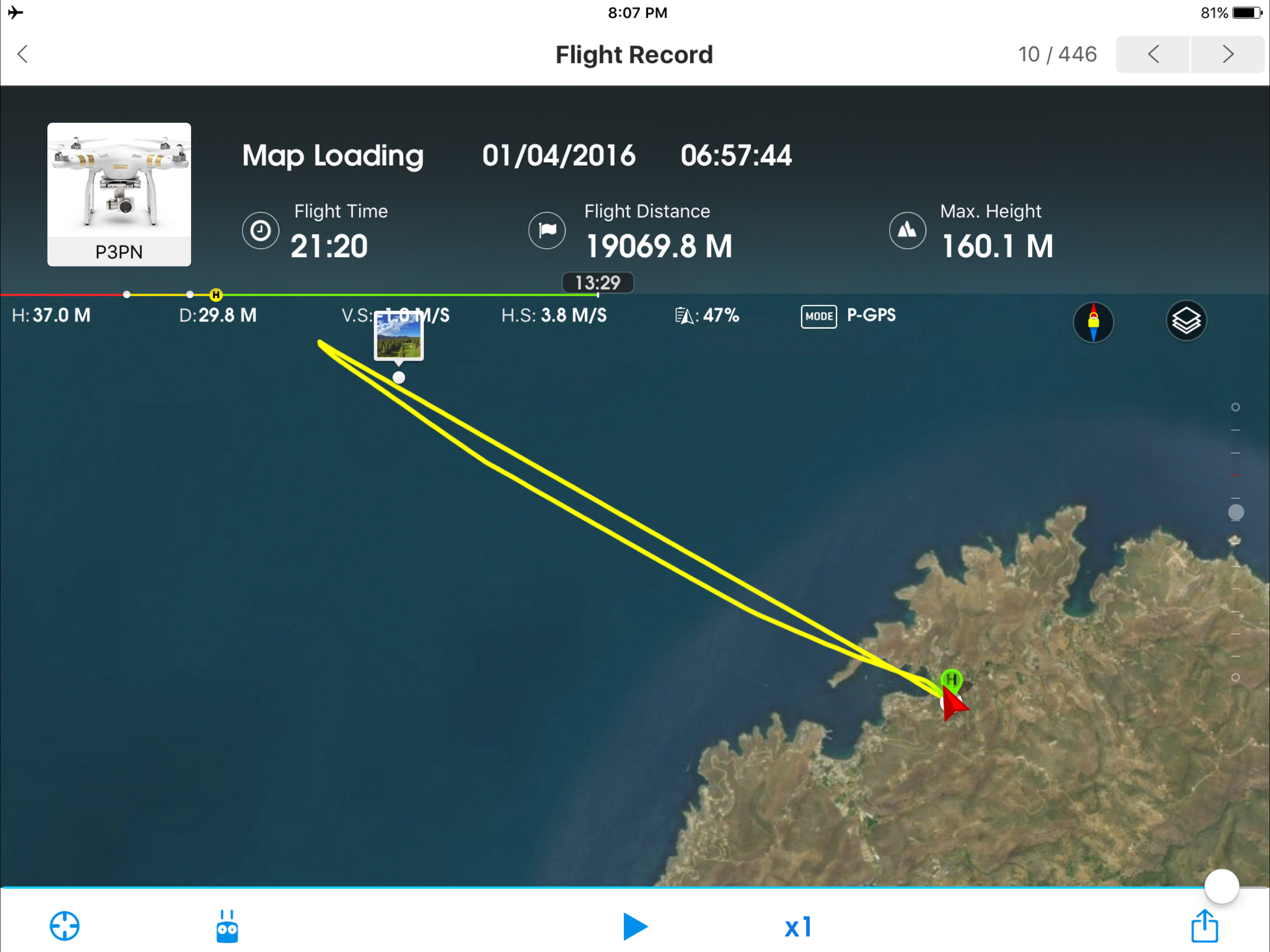

Did 19 km distance, 21.20 mins flight, 47% battery left. That should make it 36 km bird..
View attachment 49788 Did 19 km distance, 21.20 mins flight, 47% battery left. That should make it 36 km bird..
Impressive! Can you share your battery mod? You mentioned in the other thread that you use a Multistar 4000mAh battery mounted under VPS. Is your main DJI battery modded just like the 1st post of this thread but with a single XT60 female connector?
Some people are into these battery mods to ring is much flight time as they can out of it, and some people are in it to ring as much distance as they cannot of the battery. Which category do you fall into Fanti?
Yes algorithm wise it could do 36 but how capable is the equipment you're using? Do you have a decent signal at the end of your runs? By the way, I fall in the later category, I don't fly to take pictures or use follow me mode or to go in circles, I fly to go distance if the conditions are right for that I don't fly, short of an occasional test run[emoji41]

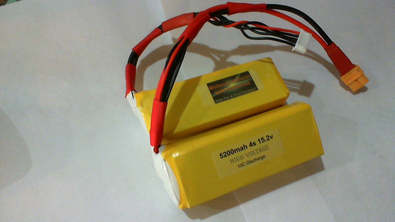

I just received these custom built from Horizon Midwest to test and if the test works out Tom Parker is going to make them available to the general public.
The goal for these is a 30+ minute flight time, I will be testing them this weekend and posting the results. The good thing about ordering these from Tom versus other battery mods you can order is Tom Will not only put an XT 60 connector on your main battery but also a balance plug where you can charge all this together only using the DJI charger you already own you and I need to buy an additional battery charger which means if you choose to, you could leave the strapped to your Phantom at all times. I'll set up a post with the contact info after testing this weekend
ok I just got off the phone with Paul at FPVCustoms and he confirmed that nothing comes out of the bird, only the battery despite the pics on the website. I will hold off until this weekend to hear how it went with your test before I decide. Thank you.
