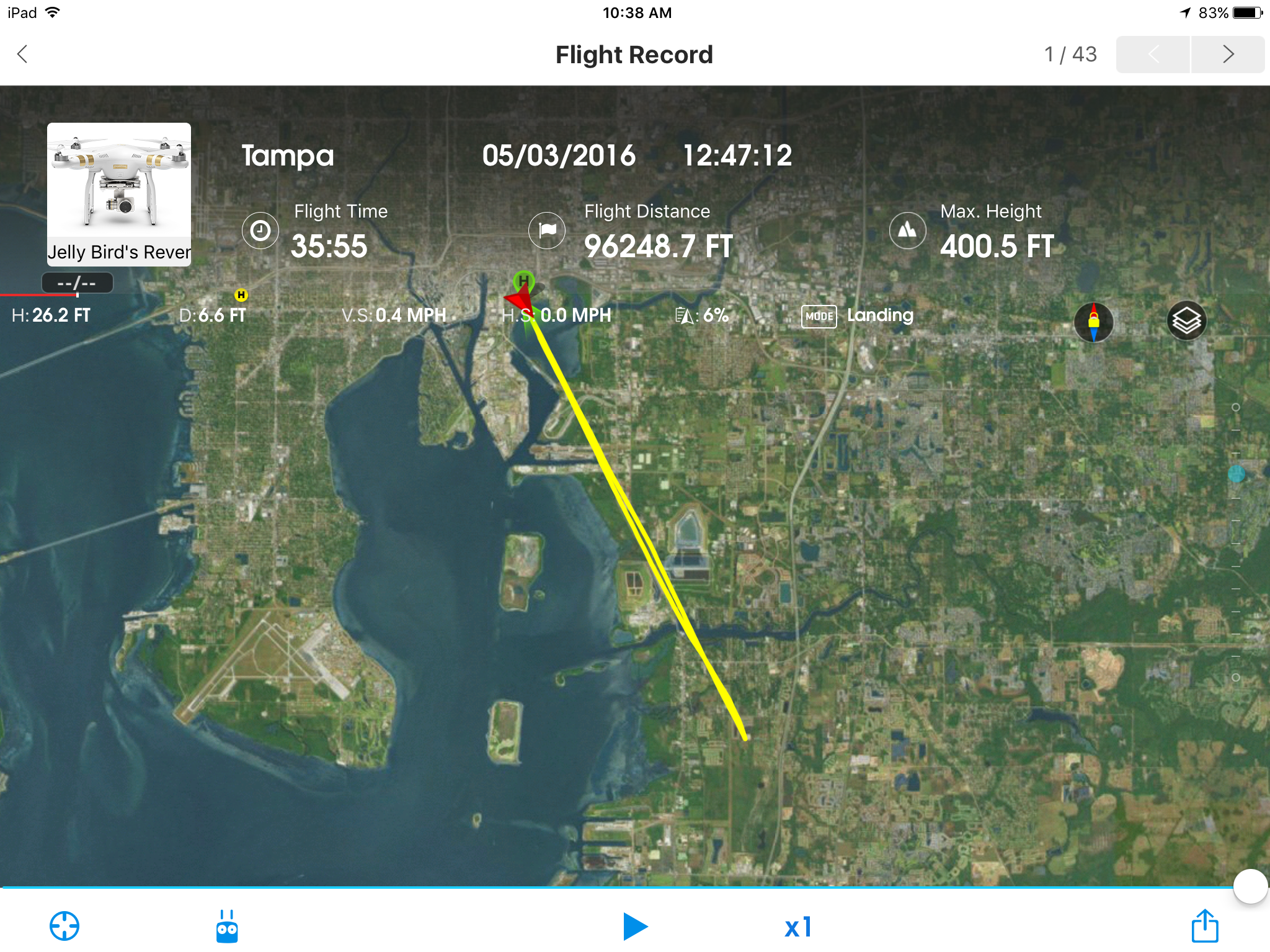

IMG_0036.PNG this is what I'm getting flight time wise I wouldn't say it was good unless it was. I would never mislead people into buying a product I don't believe in. I know it might be cold where you guys are but I don't see I could be getting 10 more minutes flight time just because of the cold.

Never doubted you. I am just not getting more than 28.5 mins to 10%. A pity. And I have four v3 modded batteries and split packs, all with same result. Tried on multiple birds all with new motors... Tried with and without balance in flight. It should be more but I don't get it. Flying in 4-8 degrees Celsius.
Never doubted you. I am just not getting more than 28.5 mins to 10%. A pity. And I have four v3 modded batteries and split packs, all with same result. Tried on multiple birds all with new motors... Tried with and without balance in flight. Charging the splits I get between 4300 and 4550 mAh. It should be more but I don't get it. Flying in 4-8 degrees Celsius.
46 degrees Fahrenheit is not going to make that drastic of a difference in flight time. I have been pumping up the Lipo packs with my high voltage charger maybe that will help I know I fly differently than most of you butt I don't see how I could be getting that much more flight time than everybody else it doesn't make any sense.
