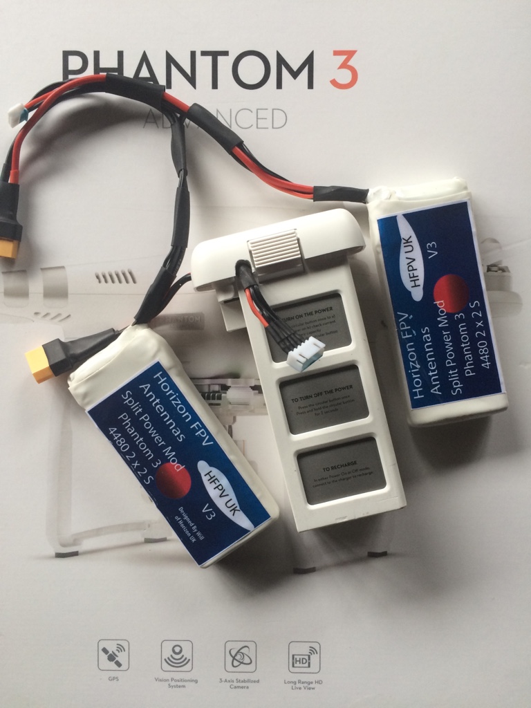

Wait, so when you're flying with the mod, you have the custom balance connector hooked up? Is that per instruction?
Yes, that's per instruction. The balance connector keeps the cells balanced in flight. That's the main reason it's there, according to FPV Horizon.
This is what FPV wrote me: "When using the mod , while in flight , the balance need to be connected ,it will vary s bit due the the cell performance,"
So how do you connect it? What is meant by the LIPO balance cable? According to that post, you first need to take out the balance board for this to work?
You need to disconnect and reconnect the smart board inside the master battery (not the split pack) to reset it.

Does that need soldering to be undone/done?
No there's a white plug inside with all the balance leads if you pop the cap off
